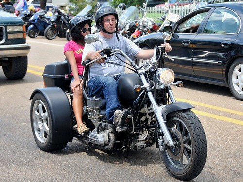

Your not running a fan shroud. Also its looks like your legs have to go over the air filters. Going mid engine makes it handle better but I would like to use a automatic trans. I think you can flip the ring gear on a auto-stick trans. Problem is I haven't seen a auto-stick trans or car in years.
No problem idling through a red light. Cools just like any other air cooled motorcycle, Harley for example. You HAVE to go for it to cool.
I have only ever seen one auto stick (in person) my entire life. But from what I hear you can flip the ring. My ring is not flipped, my entire tranny is flipped. Took some internal machine work on the oiling. Just did not want to run a stroker on the coast side of the teeth.
Took a few measurements and did the math, very crudely, assumed 50 mph wind at 100 deg. It looked like I would run out of cooling at a continuous 80HP output at this point. Yes it was crude numbers, but I don't think I ever run that much continuous HP. Yes I burst way more than that. But at highway speed maybe 20 hp cont? So as long as I don't pull a 2000 lb trailer uphill all day I should be good.
Legs beside Carbs.
