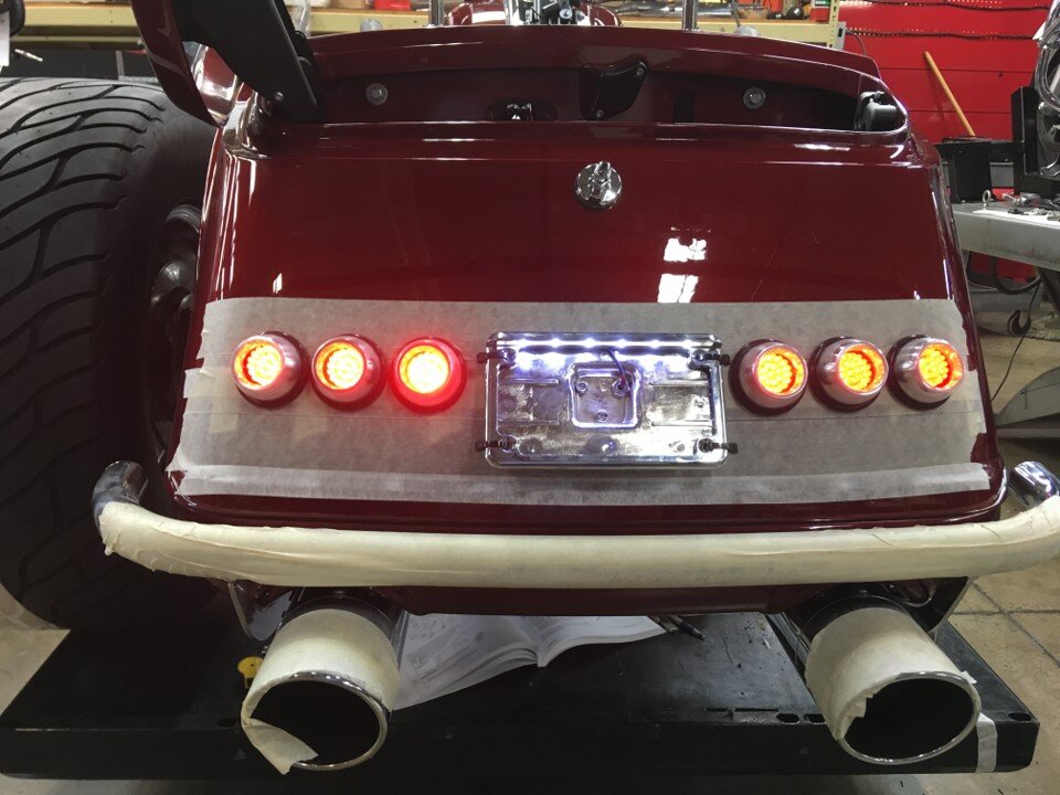

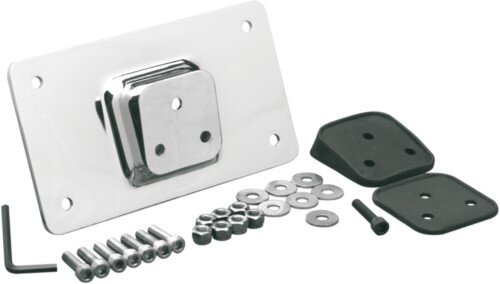

Started with Drag Specialties Bracket.... (replaced one bolt with a threaded hollow tube for wire routing)

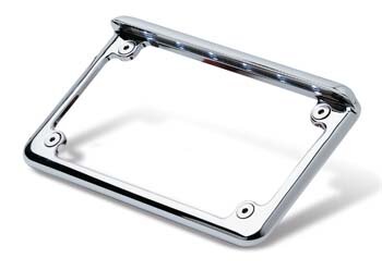

Added Radiantz Lighted Frame
Result.....
Still finishing the wire routing and such.... Will post pics of final result when finished

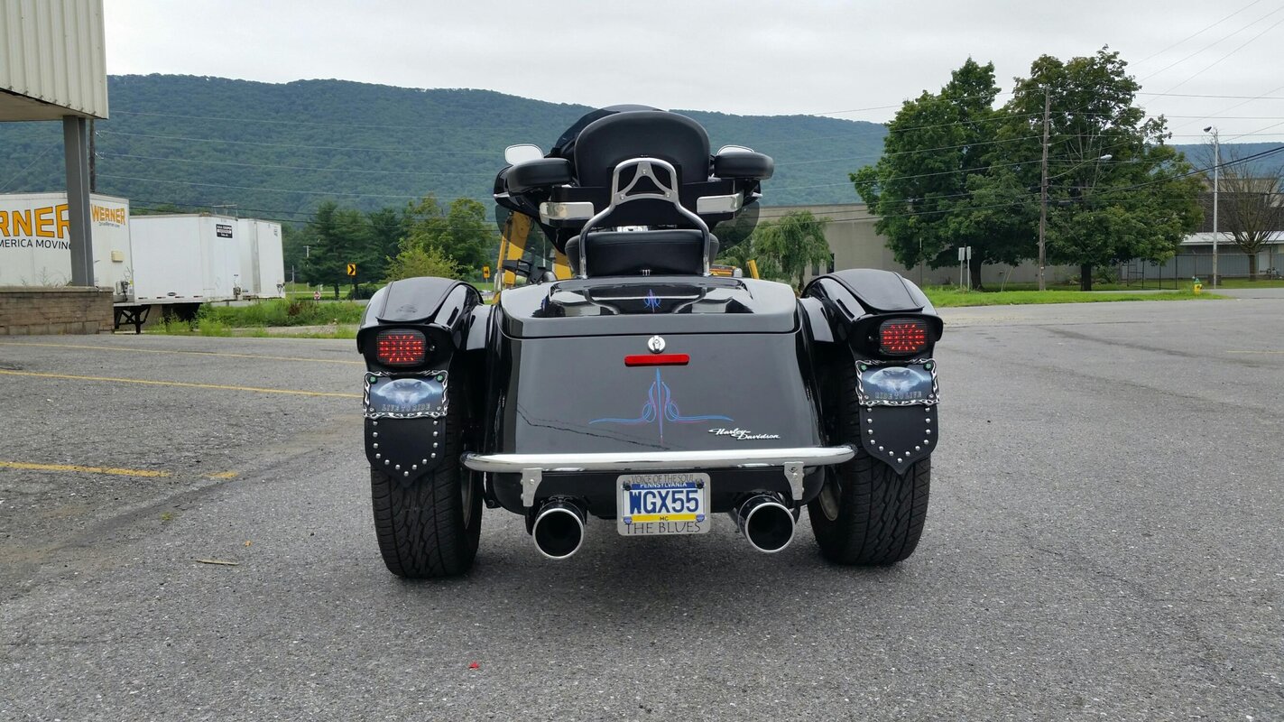

i installed a piece of powdercoated aluminum angle to the Cobra trunk guard and bolted it onto that. Used a couple of led license bolts on top for light. gonna powdercoat the trunk guard black over the winter with a few other pcs off the bike.

Rear fender bras

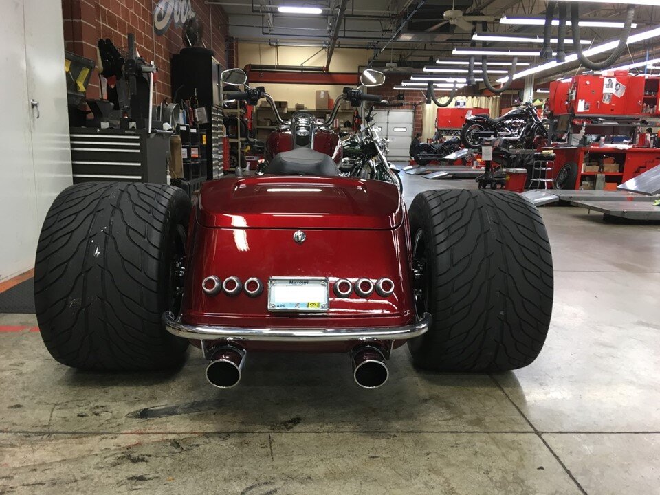

Center License Plate Holder
I've seen some youtube vids of the European or export freewheelers. They have a factory mount center license plate and it looks like lighting to light up the plate. I don't know where you might get such, I suppose from a Harley dealer.
I have seen that as well, IMO its not attractive at all.. The part # is 67900311 for Eng/Japan, but note the body assembly is a different part number as well. my guess it either has mounting holes and or recessed areas for the plate mount
