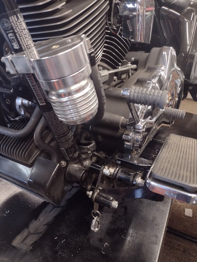

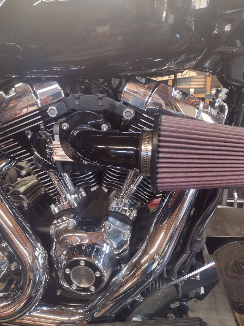

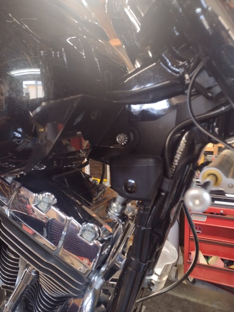

I started doing some upgrades/mods to my 16FW. I added a lifetime oil filter and relocation kit, floor board extensions and a 1" tank lift and cooling wings and a better flowing air cleaner and external brathers. Another mod I like is the Soft Brake extended brake pedal.
Twin Cams are notoriously lean from the factory and even leaner if they're a California bike. I added a VIED and I did about 100 miles on a poker run yesterday. I really noticed a difference on how it ran.
I have a set of DK Customs shocks and lift brackets. I'm just waiting for some cooler weather to install them
I like the looks of that brake lever, too. Let us know how the breathers work out, just wondering about oil mist. You might think about the stock shift linkage. Heim joints are reasonably priced and are much more dependable. You’re off to a great start!
Good point on the shift linkage.
I had the same breathers on both my Dyna and Street Glide. Many hard 2 up miles on both. Never any oil mist issues.
