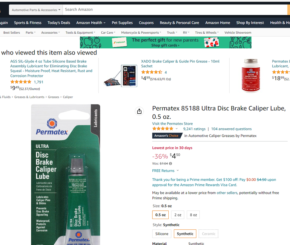

I do and always have used brake quiet on my motorcycles and ATVs. Apply a bead to the mating surfaces of the pads to piston, and pad guides. Also lubricate the guide pins. Many videos how and where to use. Usually alleviates brake squeals nearly 100% unless you have a faulty brake system component.
This comes from many different manufacturers as you can imagine, and over the last 30 years I haven't found any specific better than the other. This particular one is just one of my last ones I bought.
Hope this helps.
Lee
EDIT: here is a link showing how to:
