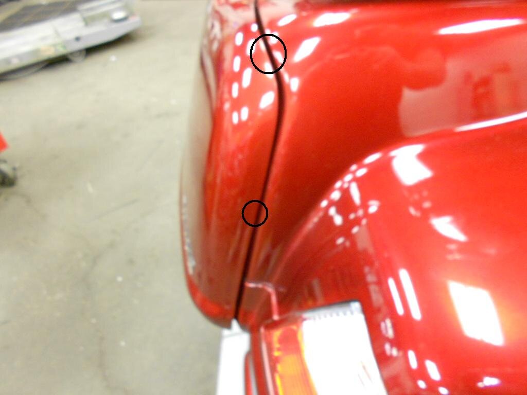

Dan, There is no simple answer to adjusting the trunk door since there are a lot of adjustments to make the door respond. First, you need to identify if the gap in the door when closed is the same at top and sides. The upper portion of the door seal creates a valley that water can lay in until you open the door. Then GUSH !!
