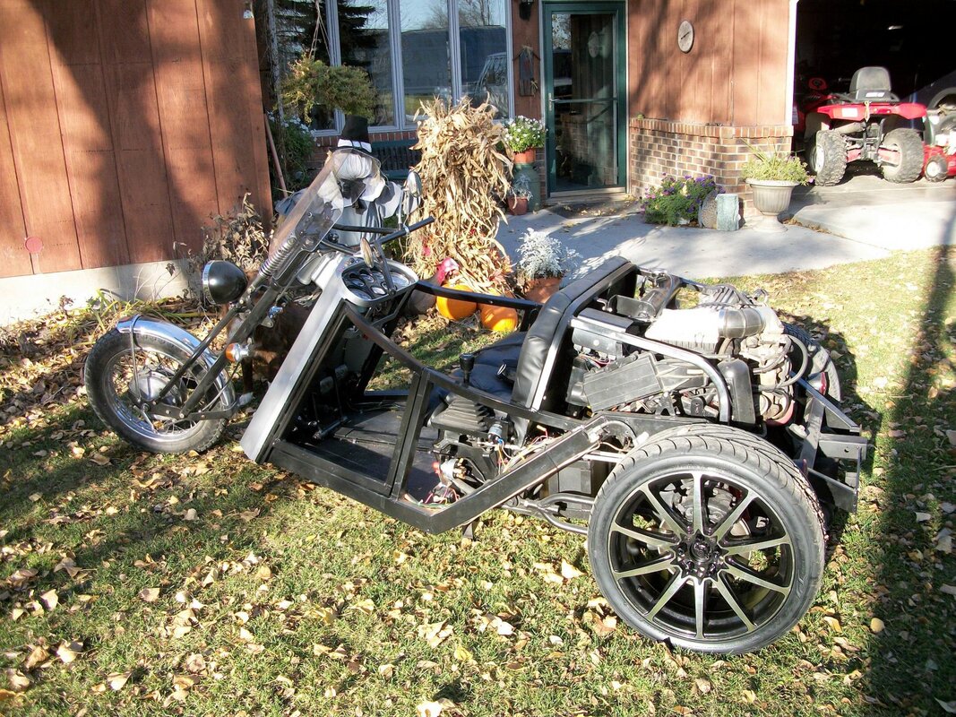

last winter
COOL!!!!!!!!!

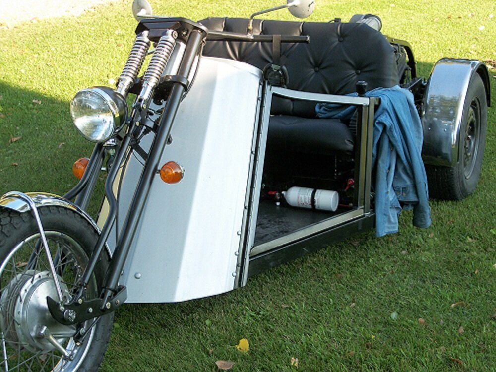

What springs are you using on those forks?
Do you have a closer picture of them
reply to thread
will post better pic of fork later..............not very computer savvy! the fork according to onetonmagoo, is a springer look leading link...what your seeing for springs are nothing but 750 Honda shocks. there is a rocking link that's ties the shocks and the tubes together. larry

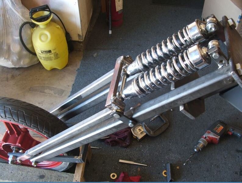

I would love to see that rocking link section also
rocking link
I would love to see that rocking link section also[/QUOTE
I'm having problems compressing files to post pictures.....the first one must have been beginners luck. the link pivots on brackets welded under the fork tubes. the link is 1/2x1" hot rolled mtl. what I call the "hammers" are the strips that tie the shocks to the link bars. this keeps the shocks and bars in position while moving up and down. just a personal preference, but I like this look better than the leading link with the shocks mounted lower on the fork tubes.
larry
Fowler look up onetonmagoo angelfire series on springer look leading link.......better info and pix than I can give. larry
fork
yep that's it! I followed his design.....but made the rocker taller to minimize the "arc" when the rods and shocks moved up and down.

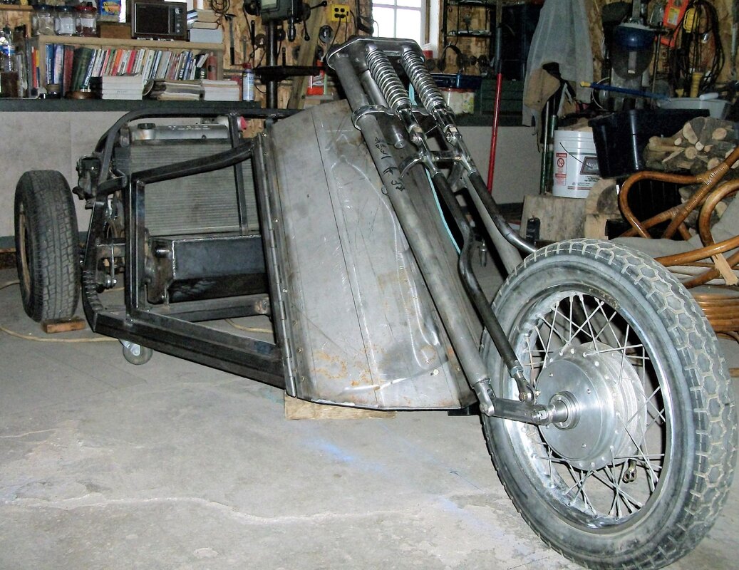

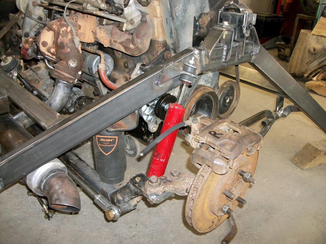

details of rear suspension
100_0152.jpgsteering knuckles are rotated backward 90 degrees and bolted to a dropped straight axle. old school hairpin radius rods locate axle as does a panhard rod.. air bags and shocks complete the suspension....50 to 60 # of air puts the suspension in mid travel.
pic does not show other end of radius rod....it fastens to the lower ball joint hole on the knuckle......the remaining end of the hair pin bolts to the steering arm on the knuckle... the single end of hair pin uses a heim joint bolted to the frame.

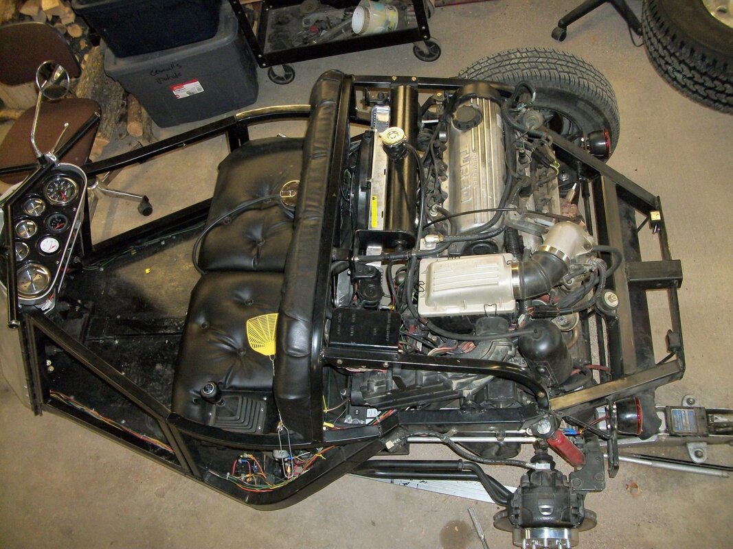

this winter i'm going to fill in the doors and the quarter sections with 1/8 in stockcar plastic sheet. my plan was to make the trike a 3 season unit......we will see...with radiator behind seat there are of course heating problems.....will try a small scoop underneath and some baffling to direct the air better.
view from above
100_0196.jpgknew there would be overheating problems.......going to aluminum rad helped a lot.....but not enough.. there is a big updraft of air coming up between the rad and the forward part of the engine...I think the floorboards compress the air then it flows up..i'm hoping to direct this air thru the radiator from front to back....anyhow its something to think about this winter!
I like it, looks really nice. Does it overheat at slow speeds also and how do you like the front forks.ThumbUp
View attachment 40579knew there would be overheating problems.......going to aluminum rad helped a lot.....but not enough.. there is a big updraft of air coming up between the rad and the forward part of the engine...I think the floorboards compress the air then it flows up..i'm hoping to direct this air thru the radiator from front to back....anyhow its something to think about this winter!
why not move the rad behind the engine??
reply to thread
exhaust manifold is in back of engine...afraid it would melt aluminum rad!! I have made a scoop and have boxed in the rad..so think that will cure the problem. can't seem to upl
can't seen to upload pics tonite....scoop is under the rad, air will have to lift 6in to reach lower part of rad. I think it will work. Diver, the forks work very well...steers easy one hand...I have 45 rake and 2 in. of trail.....the only undesirable characteristic is when you back up at a mid to high angle of the fork ......it tends to flop to a sharper angle..so keep a stiff arm when backing up fast!! otherwise tracks well.....and rides well. larry

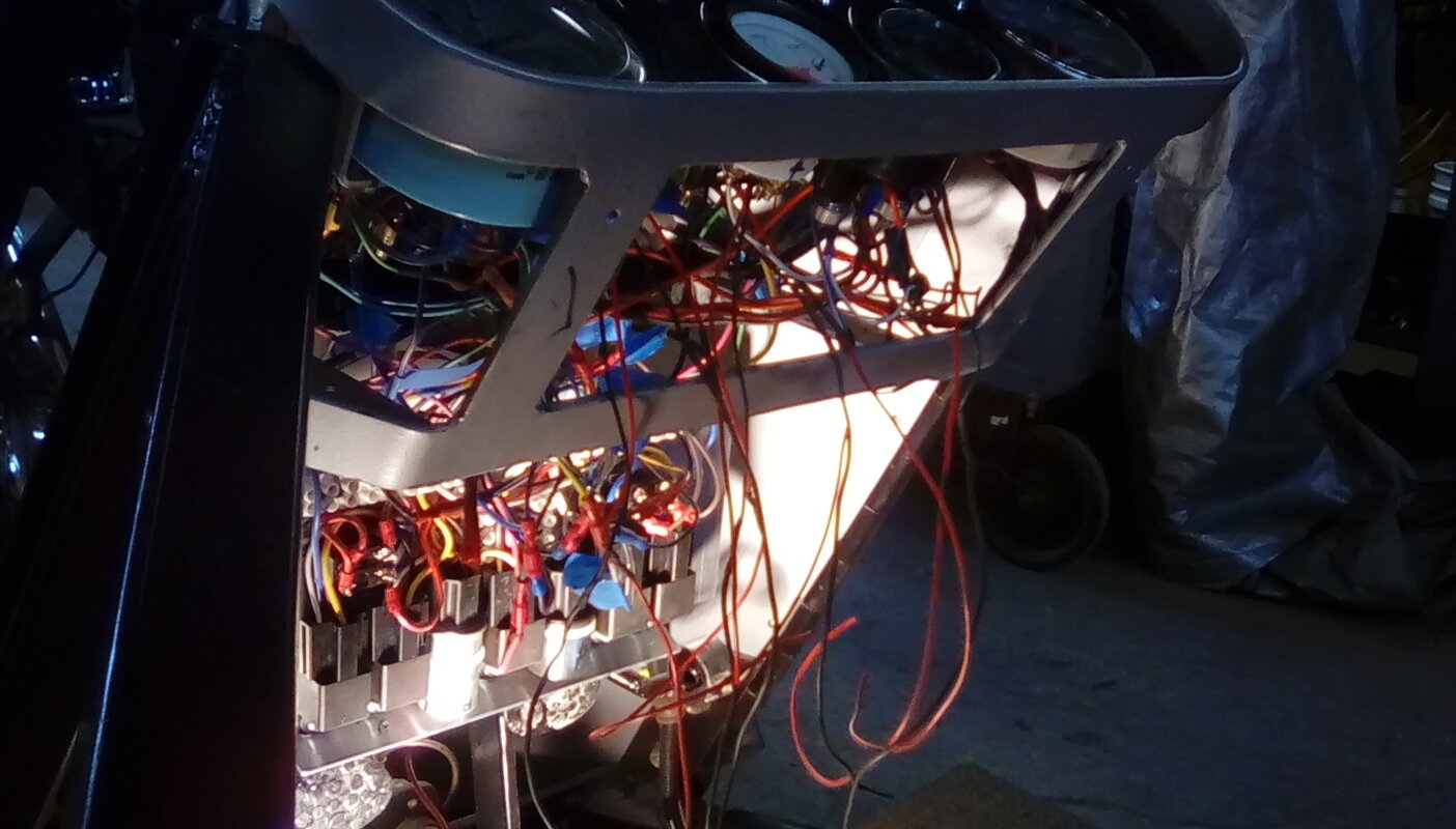

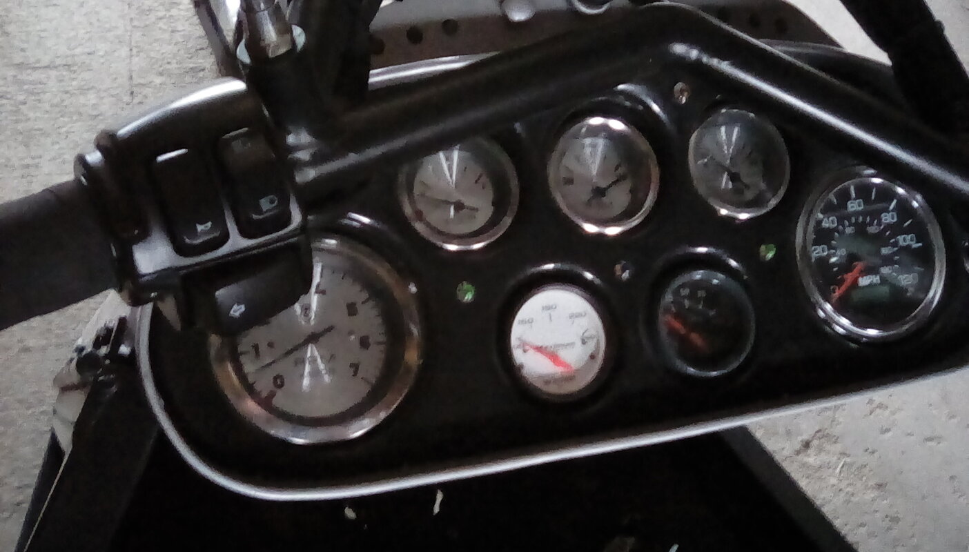

handlebar switches
IMG_20170316_160918.jpgadded these switches to each bar......Harley type...they had small wires so needed relays......from surplus center..
turn sig relays and flashers
IMG_20170124_103947.jpgthis relay panel will fold up and close the bottom of the dash....got to be quite a snarl of wire but everything works! not my quote, but it has been said,that the last 10 percent of the project takes 90 percent of the time...boy were they right!!
