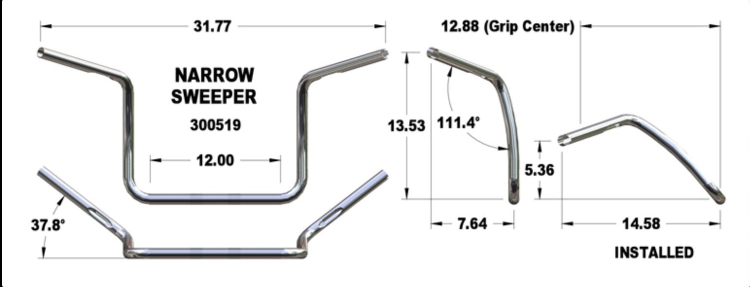

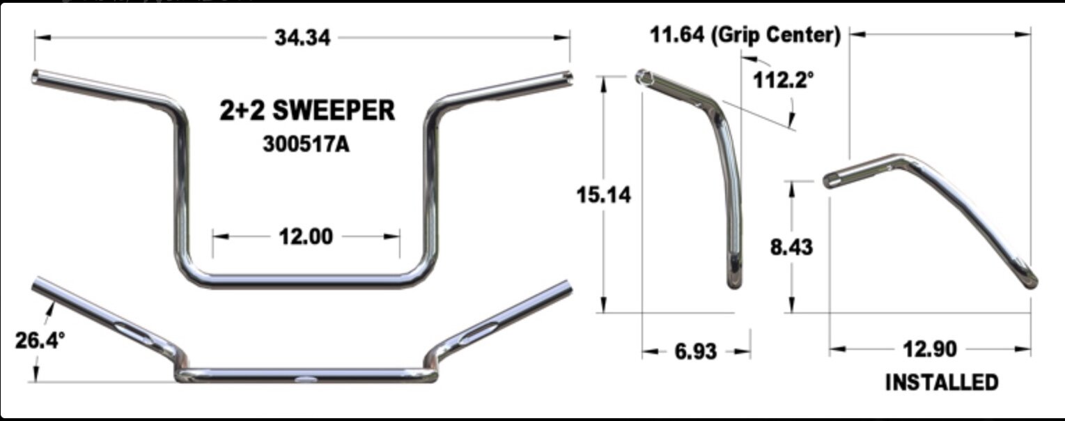

I have installed KW sweepers on my last two bikes and have nothing but love for them. I always opted for the wide sweepers, but I notice many opt for the narrow version. Below are the specs for each. Notice that the wide version has a dramatic difference in wrist angle and also a higher rise. These were huge to me because the stock HD bars have a horrific wrist angle. This is really pronounced on a trike when you’re making a full lock left turn and have to squeeze the clutch. Talk about a mangled wrist!!!
Once I went to the KW’s all was perfect. I’m going to go for these again for my 18 TG, but thought some of you may want to see the diffferences.
View attachment 108642View attachment 108643
