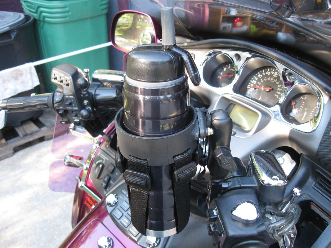

Who makes that Ram Mount cup holder? That looks like something my wife may be interested in.
IMG_0867 - Copy.JPGI made them to fit the 24 oz double wall stainless steel Bubba Hero Sport Bottle. The clamp, arm and ball on the holder are RAM, the round part of the holder is cut from a 4" pvc wye pipe, the pink straps are from a dog leash from WallyWorld and the buckles are from the camping section of that store.
The thin band is also from a small dog leash and is just decoration to go along with Gloria's bottle.
Mine is all black, the straps are camping straps from the sporting goods area at Walmart, cheaper than the leash. They also fit our 20 oz Bubba Hero Bottles, and 20 oz Contigo insulated bottle with the flip up spout.

View attachment 53831I made them to fit the 24 oz double wall stainless steel Bubba Hero Sport Bottle. The clamp, arm and ball on the holder are RAM, the round part of the holder is cut from a 4" pvc wye pipe, the pink straps are from a dog leash from WallyWorld and the buckles are from the camping section of that store.
nicely done
