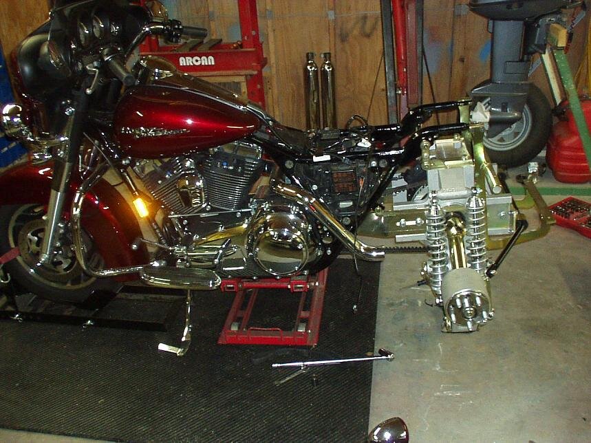

Kit installation pics..

Exhaust run through the space between upper and lower control arm. Its a straigt shot from the bike pipes to the rear. Plenty of clearance.

The new swing arm is slotted where it bolts to the center section case. Case has recesses which locate and hold the swingarm in place. It has jack bolts to move it. You loosen the retaining bolts that bolt the swing arm to the case and top of the case to bike frame brackets and move case back, then retighten everything.
Thank you for the pics of the uninstalled rear end. wow is that pretty. I did not know you had to remove the swingarm. That is to cool the way they replace it. it looks like it is also the main mounting bracket. Cool the way it double as the belt tensioner.
