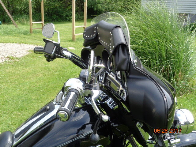

I put the KhromeWerks narrow 2+2 sweepers on my 2014 TriGlide and after 5000 miles I am very happy with the results. I chose the narrow version since I felt that their span was right in my comfort zone. I did the "sit on the bike and reach towards what feels most comfortable" process a number of times just to make sure I was happy. Worked out great for me. I do a lot of long touring days and having a comfortable hand/arm position keeps the fatigue down.
I also changed the bushings to polyurethane while I had everything apart. I only notice a bit more vibration at idle, otherwise I like the more positive feel they give while riding since you really steer these trikes unlike a two wheeler. And, with the additional leverage you gain with the 2+2's you really give the rubber OEM bushings a workout. In addition, I took the opportunity to put on heated grips since that install process is also much easier when everything is apart. I did not have to use any extensions for cables, etc. although the clutch and brake hydraulic hoses are straightened out about as far as they will go. There are other posts on this topic. Do a search.
With all that said the installation process was relatively easy even if you are doing it by yourself. There are some good videos on YouTube that are worth watching just to familiarize yourself with the process. They also give you some short cuts that will save you time and energy. I think I spent about a day getting it done, but I wasn't in any hurry. And, i was glad that I did the bushings and heated grip installs at the same time since much of the work of doing those individually is the same as changing the bars.
I probably spent more time futzing with the heated grip install than anything else since getting the control wires snuggled into the right spot on the clutch side without pinching the cable is a challenge not to be rushed - don't ask me how I know. Suffice to say that my years of cable splicing proved valuable.

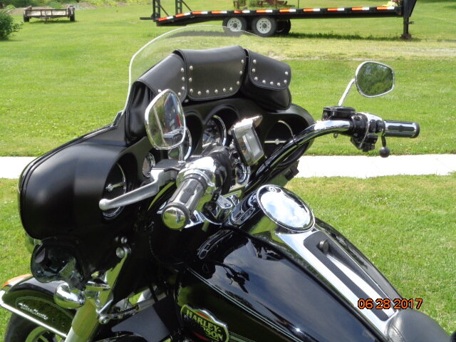

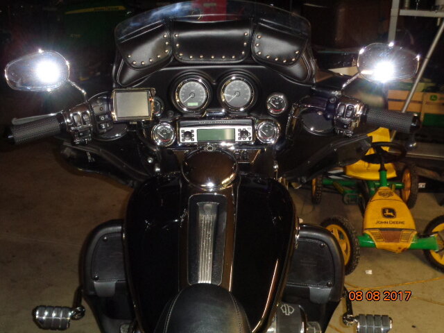

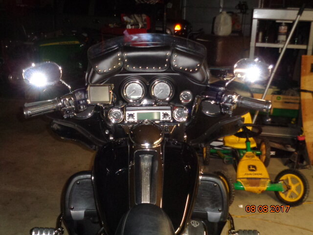

I believe you will like them the grips are a little straighter than OEM but that is what I like. please keep us posted on install tuff to beat for the price as well. I love mine. travel safe Fred

Those babies look great on your TG!!! I'll definitely post up on my findings after I get them installed. Should receive them Tomorrow!

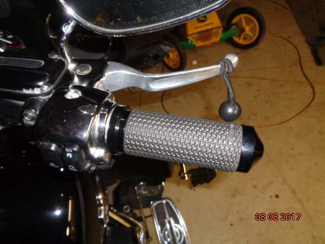

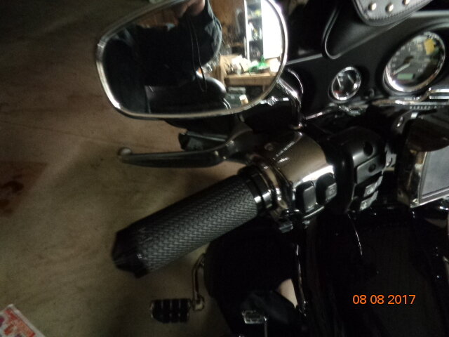

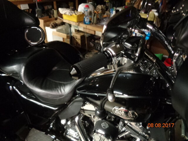

Take a look at the Avon memory foam 1.6 diameter grips really gives you something to hold on to I changed mine after the Photo shootDSC00570.JPGDSC00571.JPGDSC00565.JPGDSC00566.JPGDSC00569.JPG
Those look sweet and have to be better than these sticky black stock ones. I was considering purchasing the HD Willy G grips but havent really gotten serious and shopped around yet. I’ll have to check those out.

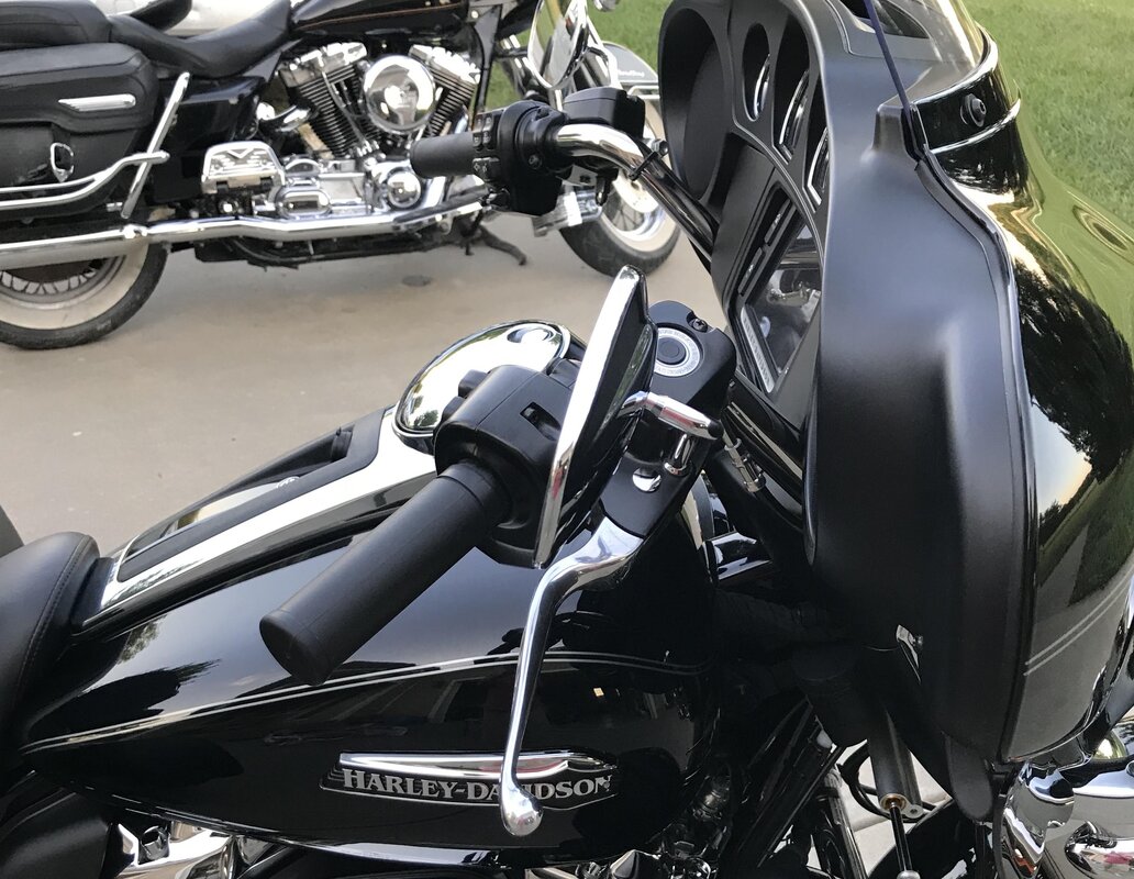

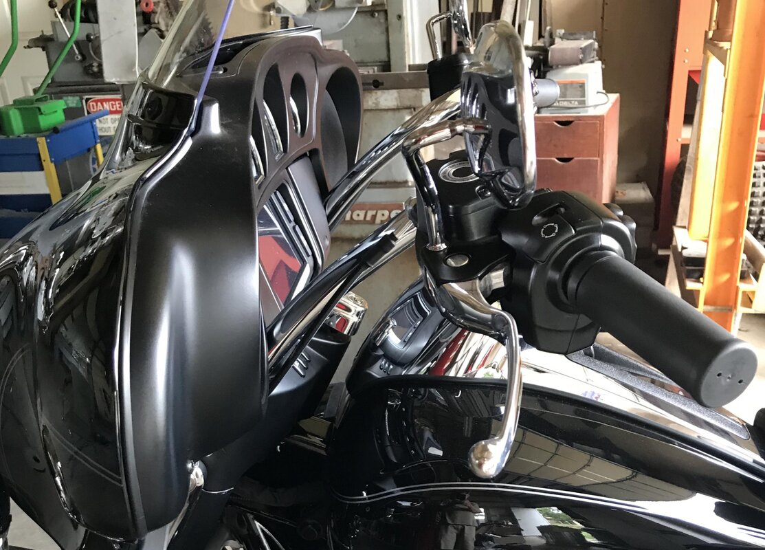

2+2 Wide Sweepers Installed!
Just finished installing the new Bar on my 17 TG. I ended up buying the extension wires for the switch control wires. Glad I did, would have been more work otherwise. I was also able to pull all wires inside the bar for a cleaner look. It took a few choice cuss words here and there but I was able to do it. The clutch hyd line only needed to be rearranged a little by cutting the factory cable ties and adjusting— same with the brake line. I just methodically worked my way through the whole process and avoided rushing anything. Probably took around 3 or 4 hours total.
Took a quick spin around the yard and can’t believe how easy she turns now! It’s like Power Steering!
after and before pics:
Yep (power steering) looks very nice and familiar good work I believe you will enjoy them. Ride safe Fred
Thank you Fred! I haven’t had a chance to get in to the wind with it yet but I’m pretty darn sure I’m going to like it.
