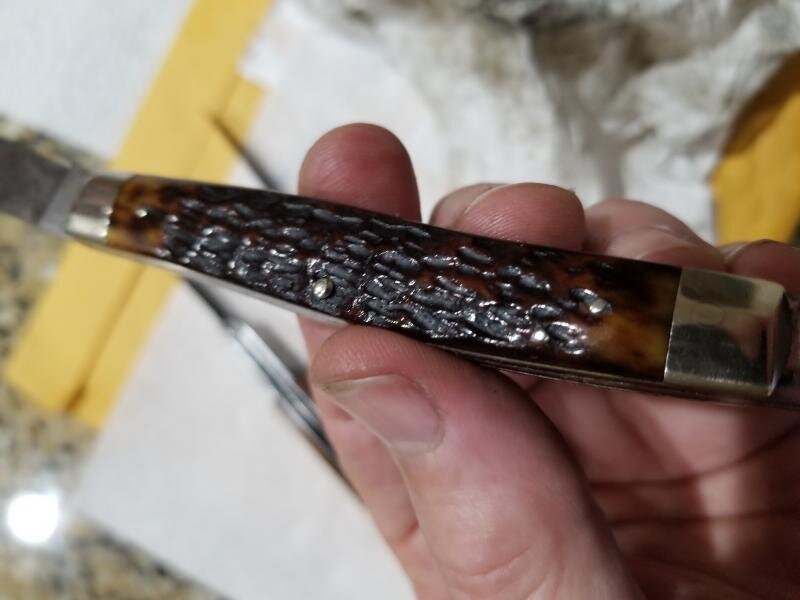

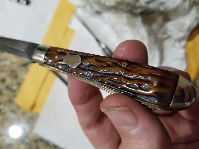

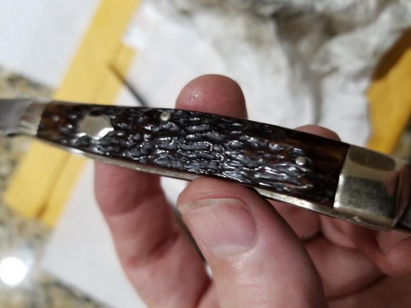

Ulster 40 refurb is complete....not exactly good as new but brought back from it's decay. Inside was rusting, the blades took some time, minor pitting now... overall a successful clean up!
Brass liners and pins, solid nickel silver bolsters and shield, no play, good snap and I'm still researching but believe it to be late 50's early 60's ...still digging but Ulster (over) Knife USA (one line) was used after the sale of the company in 1941, dropping the "Co. " in Knife Co. and then later going to just Ulster over U.S.A
The handles (I'm wishing) to be bone, but probably Ulster's Bonite material... jury is still out on that one. Thanks for letting me share it with y'all

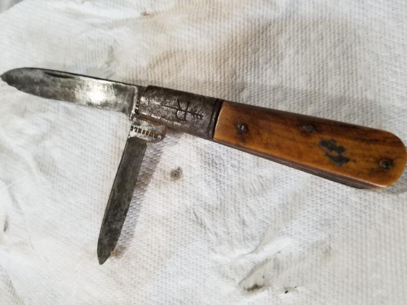

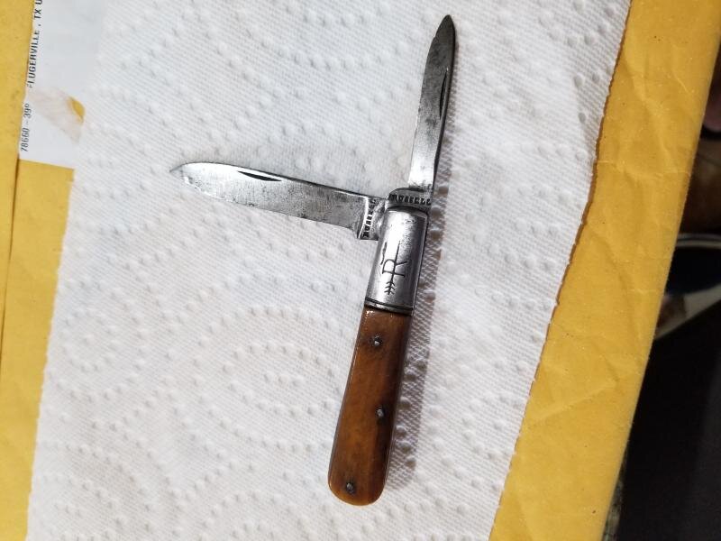

This was the Etsy rescue I picked up for 15 bucks. It was listed as an Ulster knife however after receiving it and lightly cleaning the tang stamp turned out to be a Robeson knife....which is perfectly fine with me
Here's a few before pictures:
It had some deep pitting on the backspring and on the blades, but could have been worse considering the age.

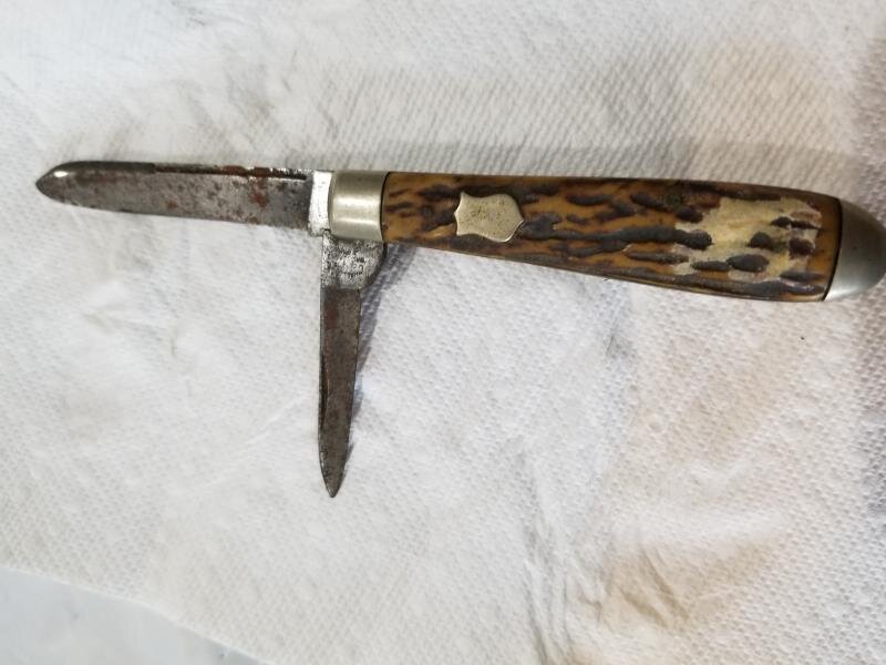

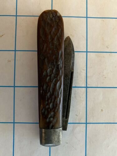

Another project worked on at the same time (Ebay rescue) paid $10 best offer accepted. Seller only posted 1 blurry photo. So for 10 bucks I wasn't going to be out too much if it was junk.
WESTERN CUTLERY CO. GERMANY Western Cutlery Co. Germany (Main Trademark of Wiebusch & Hilger Import Co.) Ebony 2 Blade Knife c.1876-1914 - Nickel Silver Bolsters - Brass Liners - Snaps Open and Shut with Half Stops some damage to the brass liner (don't know what the heck did that!) and minor pin hole puncture on the badge.
Minor cleaning and waxing of the handles 20210121_163839.jpg20210121_163851.jpg

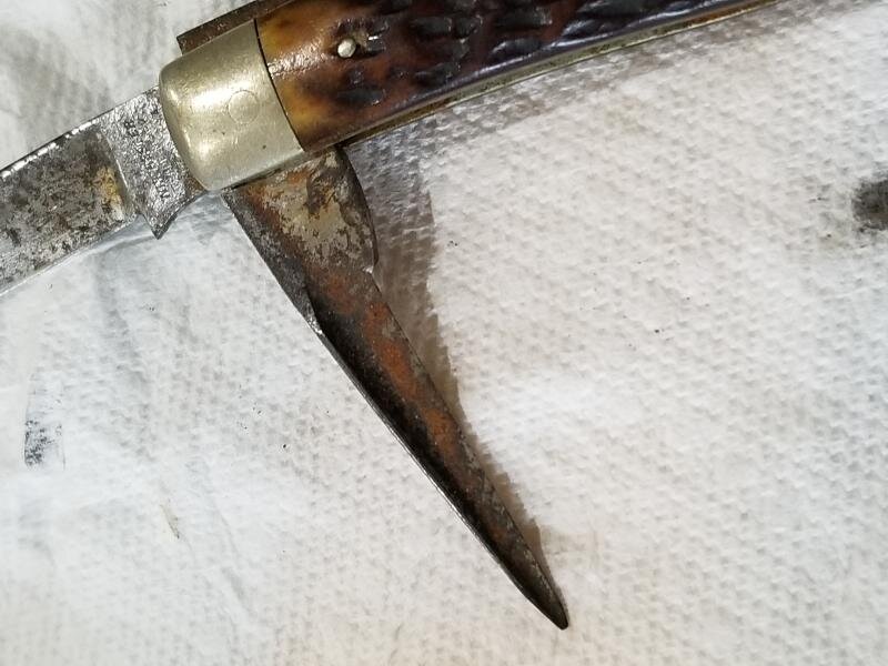

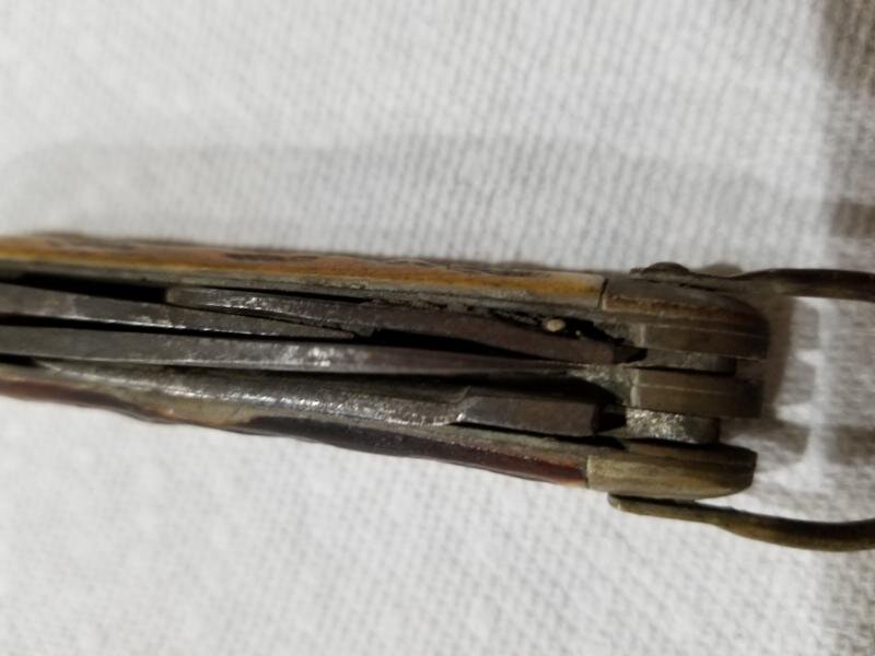

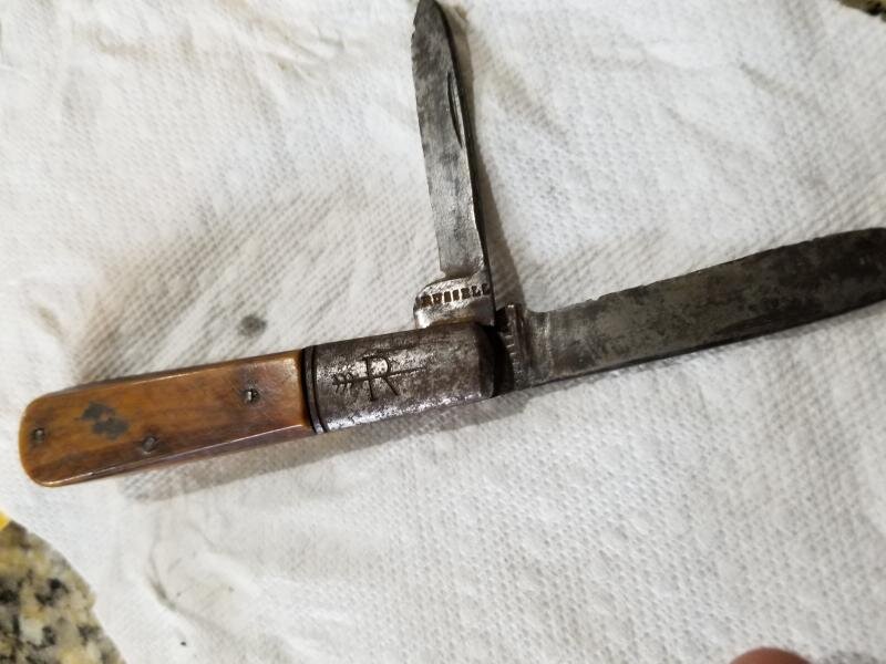

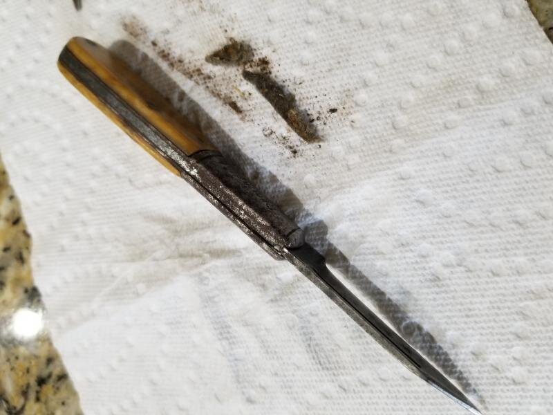

Here's one of a few recent rescues I've been working on. The owner stated that he couldn't get it opened to reveal what the blades looked like.
sellers pictures

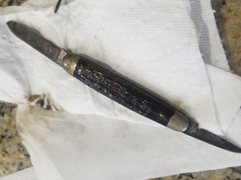

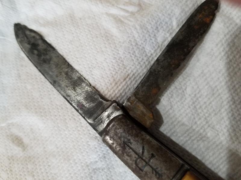

Wd40 bath revealed some nasty stuff inside
:eek:mg:

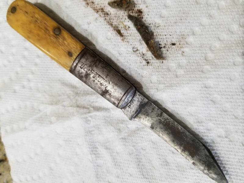

Well, here it is.... cleaning reviled it to be a Cattaraugus brand jack knife.

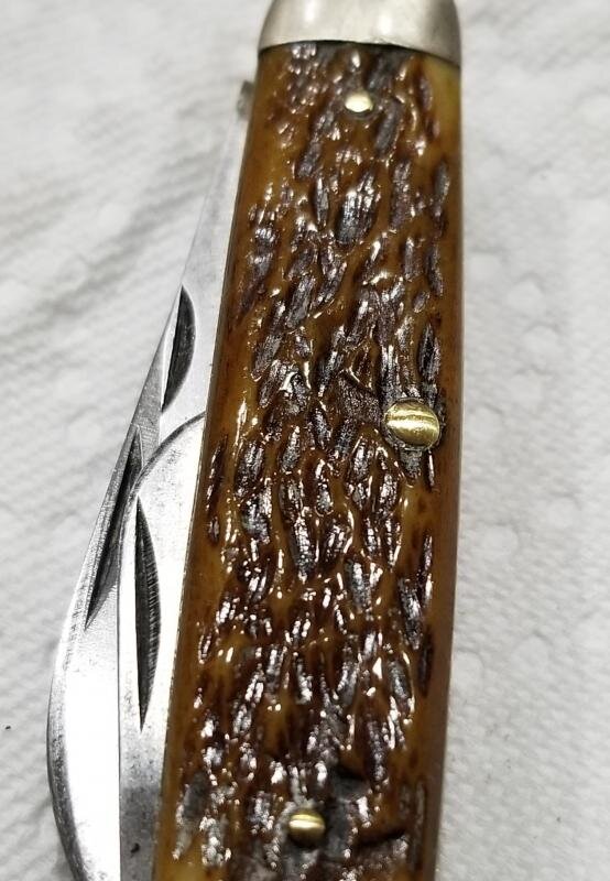

Carbon steel spear point primary blade with common nail pull under the swage, a carbon steel pen secondary blade with a gorgeous set of jigged and worm grooved bovine bone scales (nice condition with no cracks or splits) Nickel silver bolsters and shield, original brass pins, brass liners, steel back springs.
Made by the Cattaraugus Cutlery Company that was Located in Little Valley, New York and Made Between c.1886 and 1963.
From the look of the knife, and lack of numbers stamped might be earlier than the later....
The steel spear point main blade has lost its point over the years, the rocker pin has been severed over time (possibly being forced open when originally rusted up seizing the spring up) resulting in virtually no tension for the blades. When opening and closing the back spring will push out from the frame. Can be reset by hand, but proper repair and teardown is beyond my expertise at this time.
The blades cleaned up nicely, some scattered micro-pitting. There is some blade loss from age, with obvious scratches from use, but still a nice amount of steel remains. Stamped on the front tang is CATTARAUGUS (in an arch) (over) CUTLERY Co. (over) LITTLE VALLEY (over) N.Y. on both blades. No model number present, which is usually located on the pin blade, but guessing here that its possibly a model 22889??
The 2 indicates a 2-blade knife, the 2nd 2 indicates bolsters on each end, the 3rd and 4th numbers of 88 is the Cattaraugus pattern code for a jack knife and the 5th number of 9 tells us the scales are bone.These are really really good looking scales! ThumbUp
Calling this a successful rescue even though it will require some additional work later on to get it completely working the way it should, but I think I saved it from a rusty death :burial:

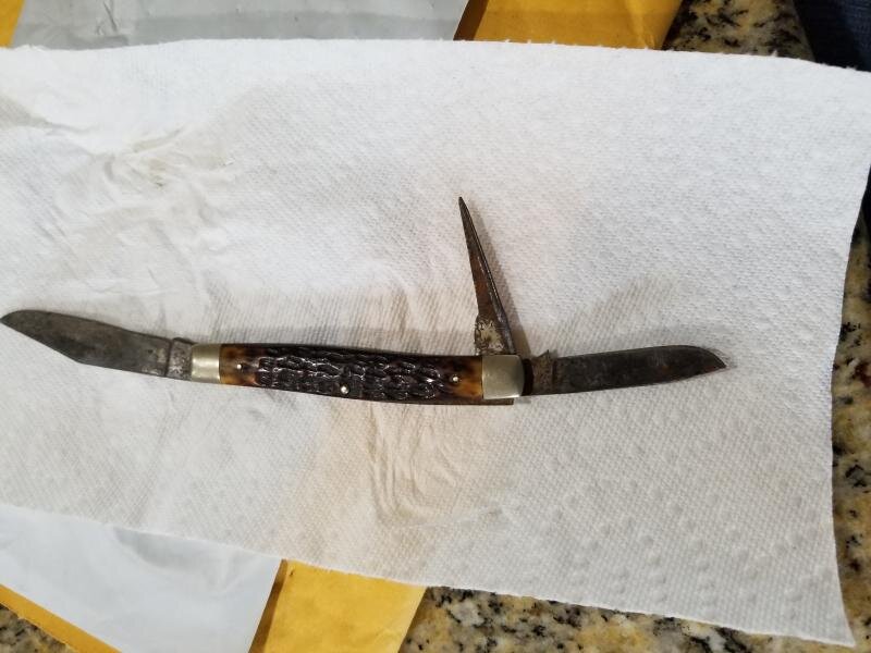

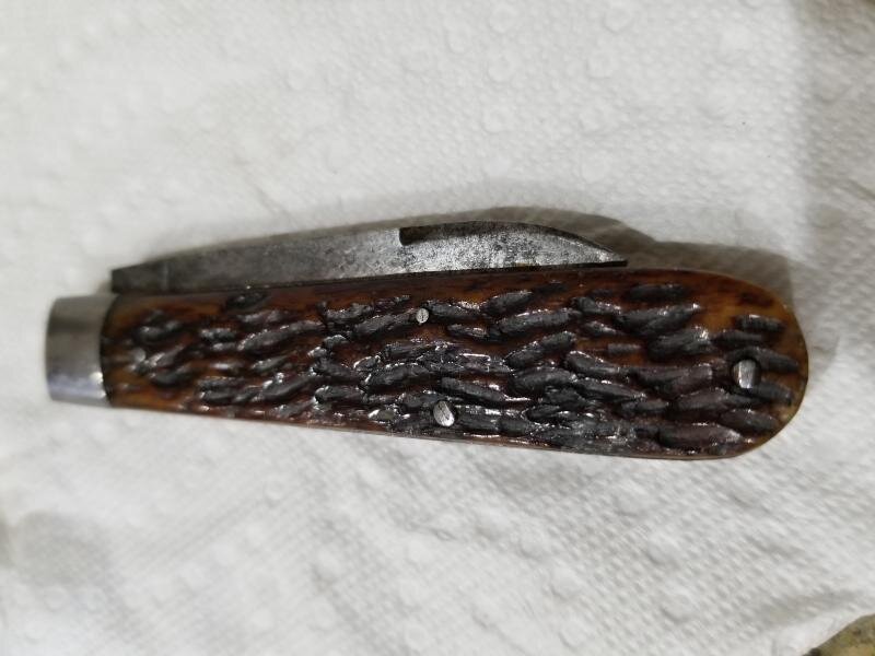

Before pictures:

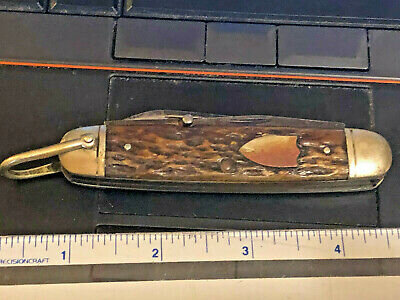

First up, the keyboard camp knife...
(Seller's pictures)

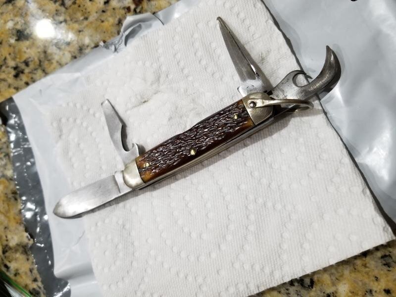

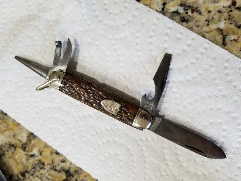

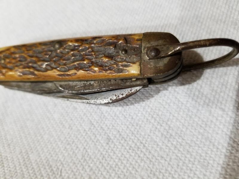

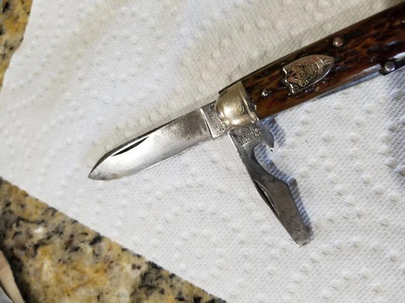

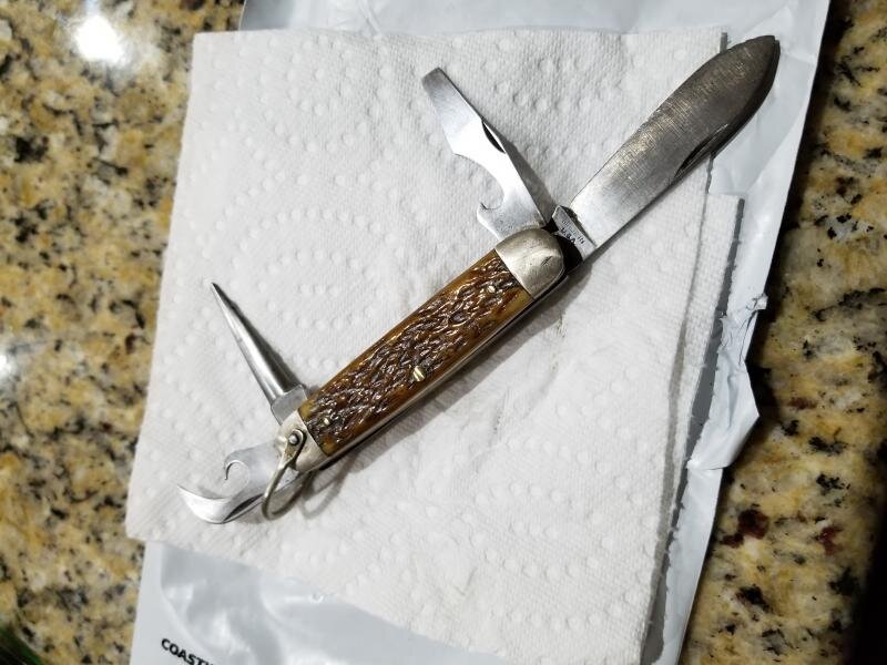

I ponied up on this one, spent a little more than I usually spend on a rescue. But it's worth so much more than the $35 I paid for it.
A Dwight Divine & Son Ulster Scout knife circa 1923-41
The blade etching is long gone and the very tip of the punch is missing, but condition overall of this sought after knife is well worth it.
The bone is absolutely gorgeous!
Coined brass liner is something not commonly found on scout knives. This is possibly late 20's early 30's for this Ulster version, making it a nice pre WWII knife
In 1923 Remington and Ulster (Dwight Divine) obtained permission to make the Official Scout utility knives.

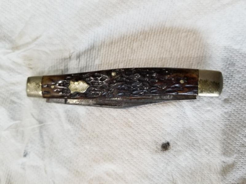

My second knife is the typical rescue project, paid 15 bucks for it, and it's old, rusty and well used
Blade on it was sitting proud due to blade loss from sharpening, so it required the kick to be filled down for it to sit lower in the channel.

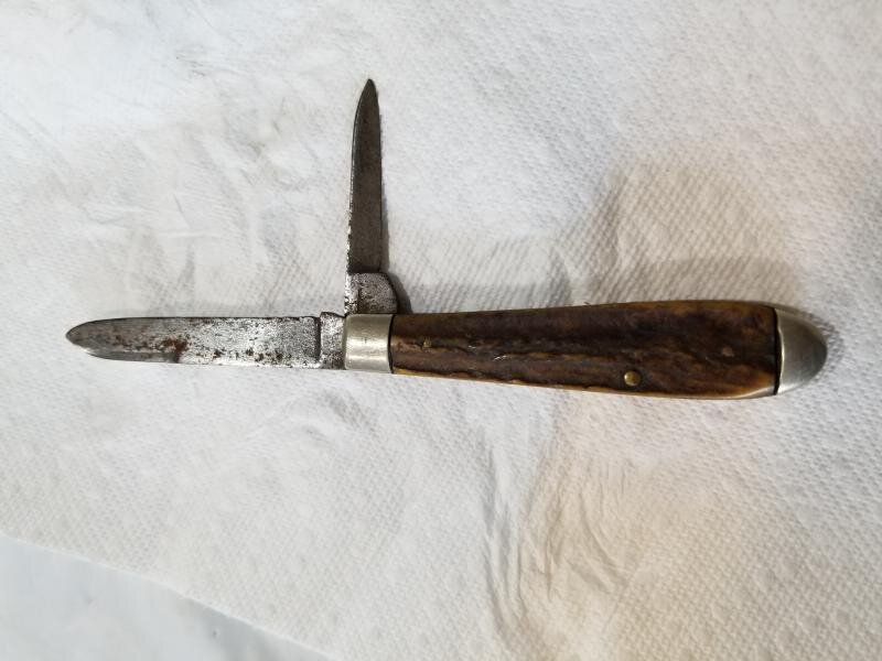

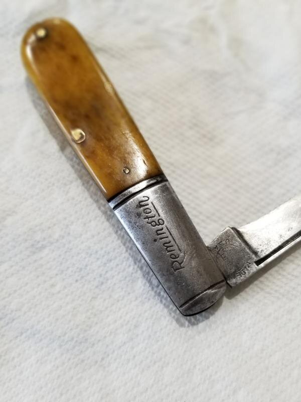

This one is also an old Ulster... Single blade, saber ground -long pull, barhead knife

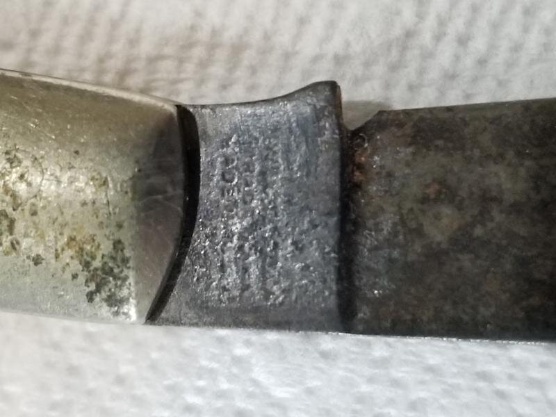

Tang stamp: Ulster, over Knife Co over NY dating this one also pre 1941.
Steel liners and pins, half stop and great snap. The bone on this one is equally nice with only a minor chip on one end on the corner.

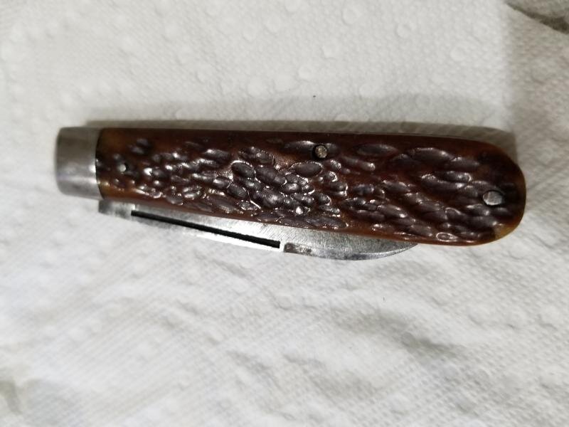

Third up... the USA camp knife

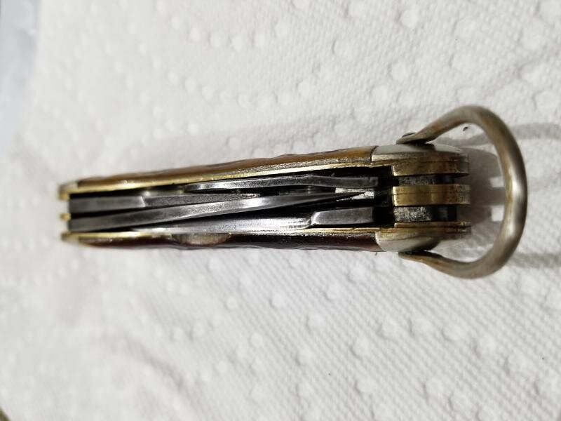

This old knife had rusting going on from neglect.... the tools were seized other than the primary blade.

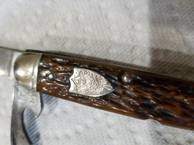

Based on the bone used this most likely is made by Ulster for Sears dated circa late 1940's early 50's
Took some time and patience to bring it back to life :)
Cleaned up very well, the beautiful bone on it was in great condition. Now all tools move freely and show minimal wear.
Brass liners and pins, nickel silver bolsters and bail.
Pictures are pre polishing, showing original patina
Tang stamp: Made in USA
The "Made In USA" stamp was used on knives made for Sears & Roebuck. There were knives with this tang stamp produced by both Camillus and Ulster.
Schrade also made knives for Sears using this same tang stamp.
(This information from "Goin's Encyclopedia Of Cutlery Markings")

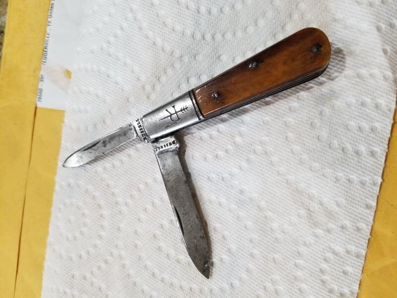

First is the Russell (straight line stamp) 2 blade dates pre 1933. A different variation on the tang stamp was used from 1933 until 1941.
Before:
After:
I evened out the rough edges on primary, my cleaning uncovered a deep scar on the bolster but it just adds to the character of this old knife.
