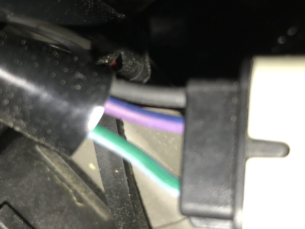

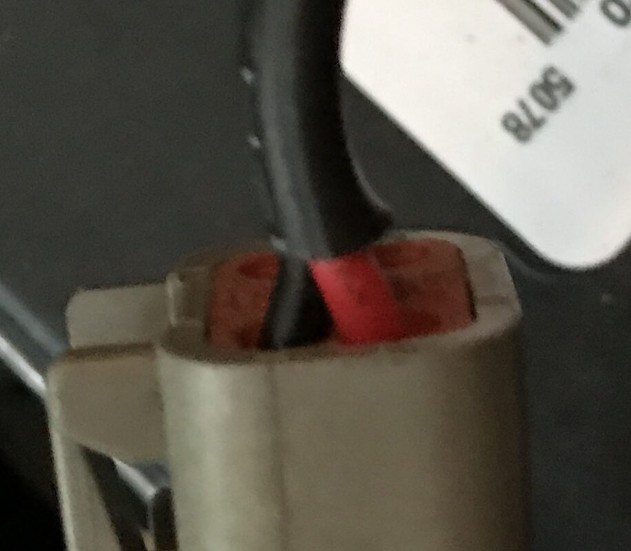

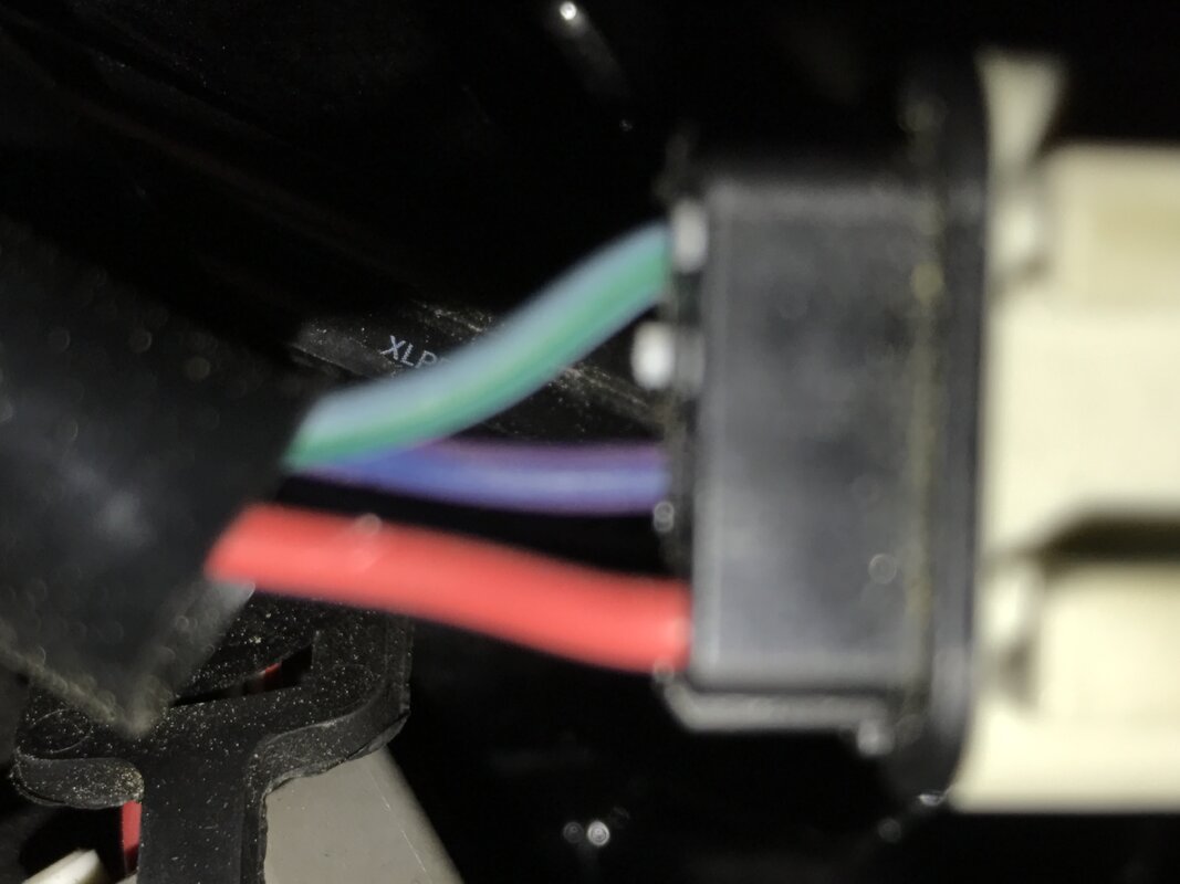

Here is pictures of accessory plug under left cover.
2015 Freewheeler Update; Just a quick fix: Use the black and purple wires: That purple/blue stripe next to the black ground is the switched 12V wire in your 8 pin plug
top of plug
That red wire/blue stripe Is 12V hot all the time in your 8 pin plug
bottom of plug
The 8 pin adapter plug that came with my Love Juggs Mighty-Mites was wired for non switched full time power! Just switch your red wire in the provided 8 pin plug up to the purple/blue hole next to the black ground and you now have a switched accessory power source to your fans!
Simple fix
The Harley Tech was right on it; 60 seconds with the little tool and wire was moved up!
