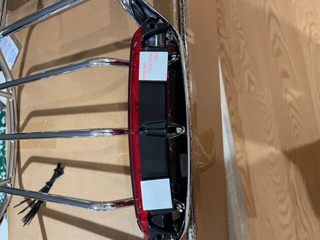

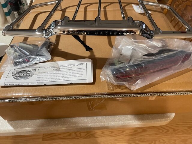

Installed a Harley Luggage Rack and Custom dynamics LED brake light

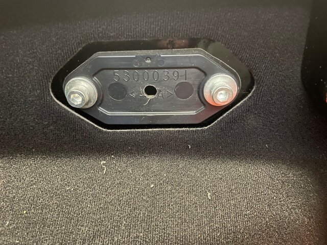

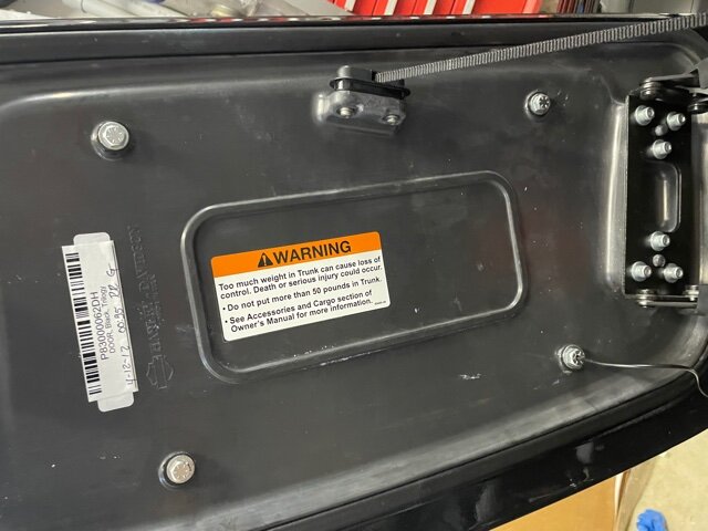

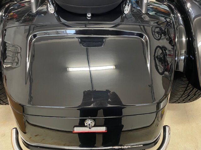

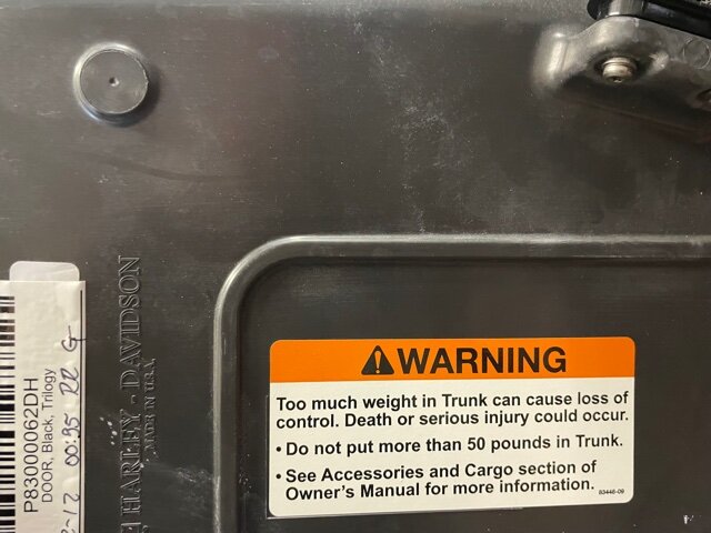

This is very simple. The Scary part is drilling in the trunk deck. Be sure to drill straight and use the correct size drill bits. And BE SURE YOU DRILL THE CORRECT SIZE HOLE FOR THE WIRE.
I used thread lock on the screws for the LED light . Use a little sealer on the pad for the rack (Helps from them falling off on the installation . I also used sealer on the interior holes before I installed the bolts.
Drill a 1/4 in hole in the trunk ( Check behind it to make sure there is nothing there)

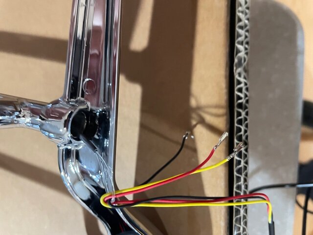

The rear light plugs are the Light color ones. Be sure to just set the plug in a little bit from the LED light so you see where to install the wires. (Make sure the wires are in the correct openings)
Clean the trunk (use an alcohol wipe) Place the wire keepers . TEST DONEIMG_0849.jpgIMG_0848.jpgIMG_0852.jpgIMG_0853.jpgIMG_0854.jpgIMG_0850.jpgIMG_0859.jpgIMG_0862.jpgIMG_0861.jpgIMG_0864.jpg

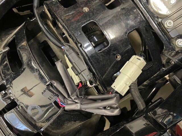

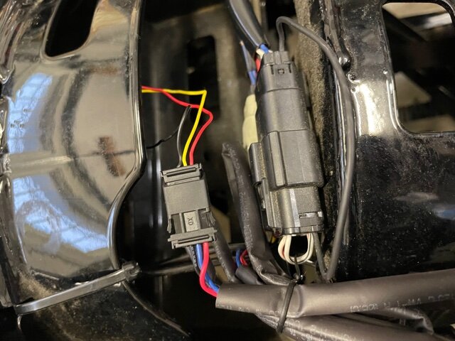

Is the connector for the light attached to an existing connector under the seat or do you have to add something to the wiring harness for it to attach to? Nice job, by the way.

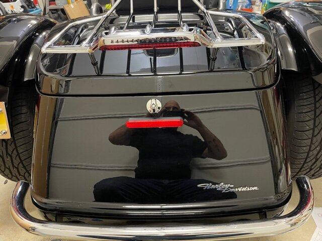

I have wondered if the LED Custom Dynamics light is brighter than the oem LED Harley luggage rack light. Does anyone know or have compared the two?
The Custom Dynamics light is (no offense NTJersey) much better light. Brighter and angled slightly different than the HD version which certainly out performs the HD light for visibility. I had the HD version on the wife’s Freewheeler and after seeing the CD almost changed it out.
I forgot to mention put tape on the outside where you are drilling the holes .
Don't force the drill Let it do the work (you will damage the paint if you push too hard)
there is a jumper provided by Custom Dynamics . (Harley may not have your correct jumper) The second picture shows the connection of the jumper wire to the rear light. Sorry for triplicates , computer burped) The LED light is very bright.
Thanks Joe! In pictures that I had seen, it ‘looked’ brighter, but I didn’t ‘know’ for sure. I will get one of them instead of the HD lights.

There is a lot of plugs under that rear seat!!
I have got to find out which one to plug my friend’s trailer light wiring into. Maybe he has instructions. (“Real men don’t read or need instructions!” [This guy does … every now and then! LOL])
RareSS
They will be the light colored plugs. Mine had Two sets of plugs , a black one on top and and the light colored one below it . If you go back to the pictures you will see the both sets of plugs. (Black and a White) If you separate the plugs and check inside you will see if they are the correct plug. And Custom Dynamics had the correct colored plugs in that jumper wire.

Like I said everything was easy. Drilling into a 24K bike trunk lid was the OH c$$p moment for me.
Just take your time , chances are the plugs are keyed specific for each thing.
PS I used a wide blue masking tape.
