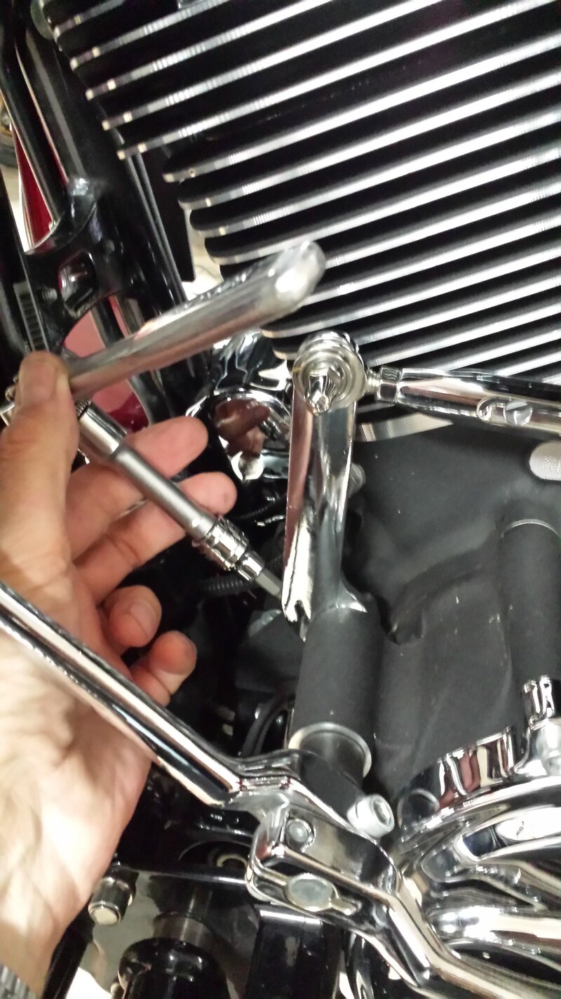

Yes ... VERY COMMON failure point is inner shift linkage pinch bolt. It needs blue loctite and/or lock washer.
Bob :D
:Agree: And also at the other end down at the shaft...Its a little harder to get to [1/4 inch allen]
