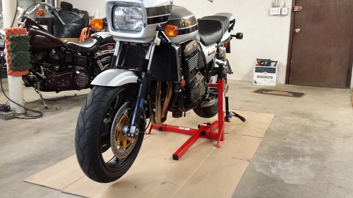

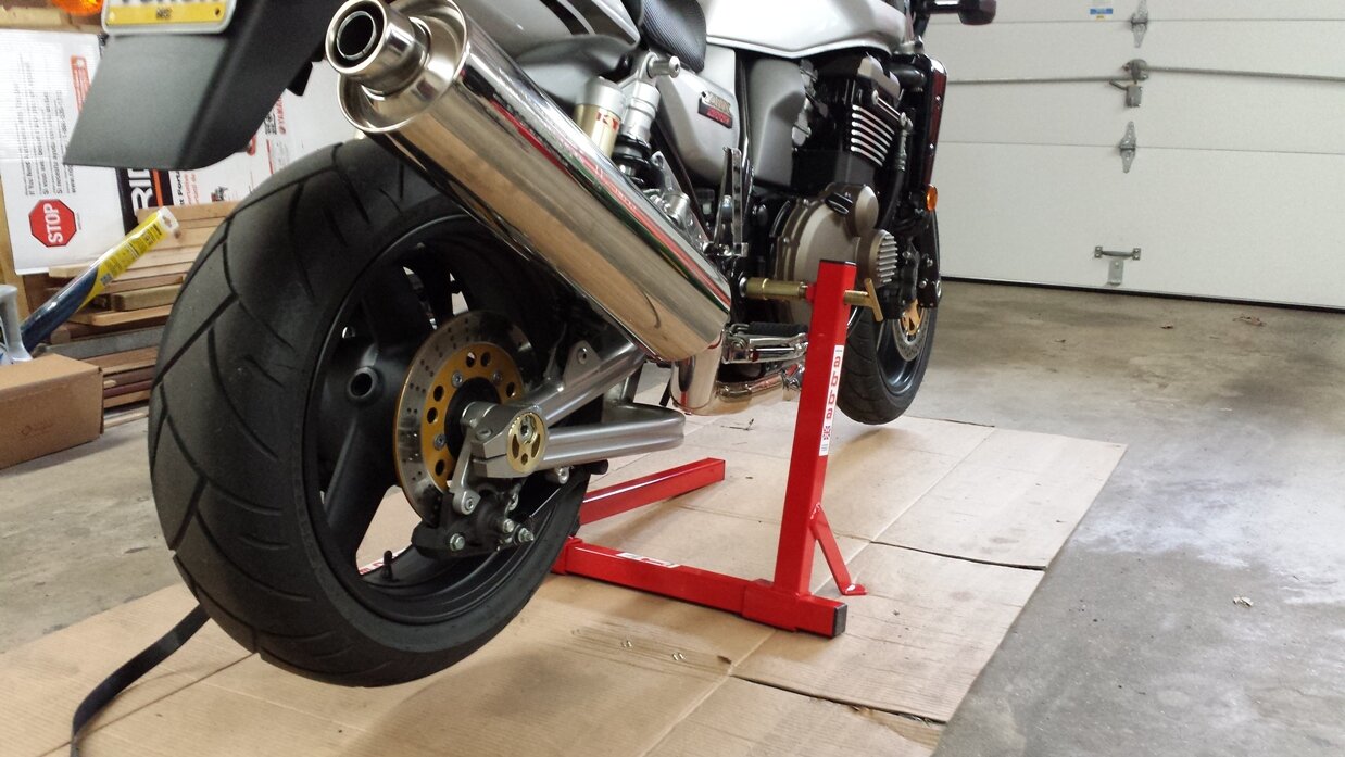

If you service your own trike .... that J&S lift will be paid for in no time. For me ... It will make it a whole lot easier to place it in its garage parking spot. I paid $250 for my ABBA ZRX stand/lift.
