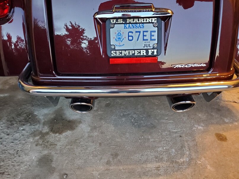

Installed a new set of Cobras 909. WOW! they sound fantastic. The problem I'm having,has anyone had a problem with Cobras are not tightening secure enough? :Shrug: I'm noticing that the right mufflers keeps sliding back. At first I had no idea what was causing the muffler to slide. After removing the muffler i found that the slit on the tip wasn't completely gaped. One side of the edge's corner was catching the other sides corner keeping the gap from closing when tightening. I used a very small file to separate the two corners letting the muffler's gap slide into each other onto the head pipe. thought I had solved the problem until this passed week ride. The muffler slid back once again. :gah: Thanks

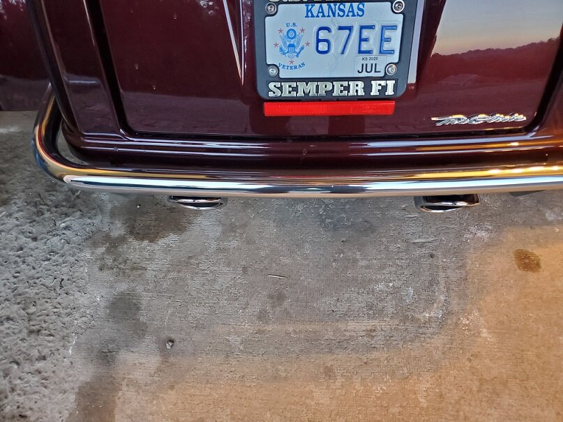

Its been awhile now with the Cobras, no difference in the pictures. :clapping:I want to thank everyone on your feed back. Now that I been putting miles on the trike, yet another problem too solve. :kpzxvq: Order a new Ultimate Seat. Will start/add to the Forum in another post.
