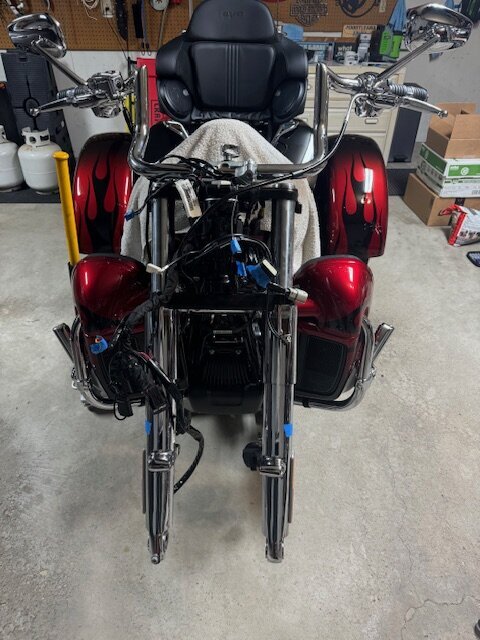

I didn't want to hijack 14TG's thread on the 9 degree rake kit that he got from Papa Zook, so I'm starting my own thread. I too bought one from Papa Zook. It is being delivered today. I have my trike pretty much apart as shown in the picture. So far, it wasn't difficult. I'm a little leary about removing the fork tube caps and installing the ones that come with the kit as I don't have a vice to hold the tubes. I am going to try to use the triple tree as a vice. I have done that quite a few times before with other bikes. The only thing that I have left to do before the install is remove the forks, handlebars and triple tree. I won't be able to get back to it until Monday as my wife and I are about to head out for a long weekend. I'll let you know how it goes.
Lookin good you'll get er done. The tube caps are the hardest part. Take your time and be careful. Enjoy your weekend.
I think using the bike as a vice is a good option. I didn’t think of that when I did mine , I used a little black n decker vice sawhorse. Patience is the best tool though.

I have the rake kit installed. Was a little easier than I thought it would be. I was able to use the triple trees to hold the fork tubes in place to install the new billet fork plug extensions, which come with the rake kit. I have to put on the wheel and the fender and the inner and outer fairing. Before I completely button it up, I will try to chase down an electrical problem with my heated grips that started after I changed the bars last year. They don't get as warm as they should. Either a crossed wire or a bad connection I'm guessing.
Finished the install this morning. Never did get the heated grips to work, but I wouldn't use them anyway. I have to do the hardest part of the job now and that is getting the seat screw back in. I think that I'll just make a longer one. Probably can't take it for a ride today, hopefully tomorrow.
Well, I just got back from riding my trike. No shortage of twisties around here and I rode the twistiest. The rake kit is everything the people that have them say it is. Steering was much easier. Even pushing it around in my garage was easier. I should have done this when I bought the trike two years ago. My thanks to 14TG for making up my mind for me and to Papa Zook for his help during the purchase and for his pointers on the installation.
