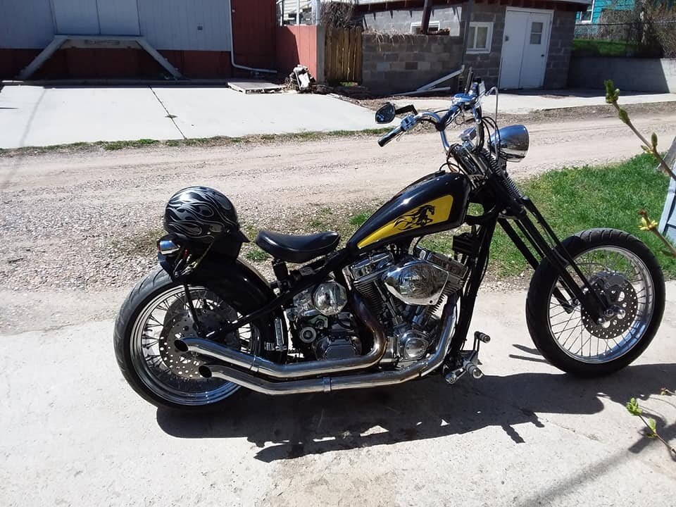

Between being down sick as usual in the winter and working on the chopper I just don't think much about it?

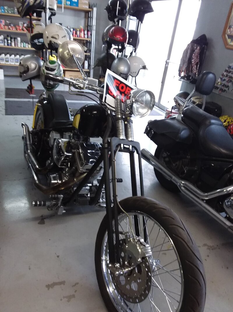

Anyway, I'm just lacking a clutch cable before its ready to hit the road, You may not notice it but many changes have been made to the bike.
I haven't decided if I'm going to get a different tank or just re-do the sides with some graphics?
I need to build an old style sissy bar and I intend to put a front fender on it.
I have some accessories to put on it and will need to find some decent saddle bags etc.
Yes, its an outlaw but this is the type of bikes I built in my misspent youth.
I haven't gotten started putting the new engine on my trike yet and I'm going to have Ron at cycle works help out on that same as he helped me on the chopper.
The young fella is a mechanic as opposed to a parts changer and I trust him.
God, I hate gettin old, so if I'm to have a second childhood it's time to stop muckin around about it!
Glad to see you're feeling better and working on a project Paul. That Ultima engine will wake you up in a hurry!
The handlebar and seat change should be easier to ride for sure.
Are you gonna actually ride hard tail this upcoming season?
I love the look but don't think I could personally take the pounding that hard tails deliver, any more...;)
I doubt i will do cross country, That's what my trike is for but I plan to ride that chopper allot.
I put the shock absorbers under that seat but I'm beginning to fear they may be too stiff?
I actually haven't ridden it yet?

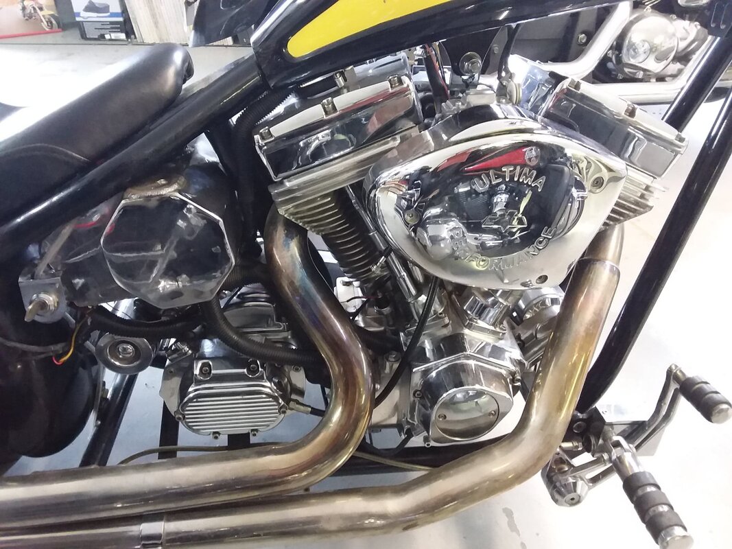

Most of the strain for the belt and chain is on the left side. As said above, the Evo primary is sometimes unable to handle the torque and strain and will allow the transmission to twist. The Torque Arm resists the twist and keeps the transmission where it belongs. It will also resist the twisting force presented by the Trike swingarm.
This is what I have on mine.
Lee just an update:
Upon further inspection this ultima engine turns out to be a 113" instead of 127" and I actually like that better since it gets better reviews.
This is an Evo based engine and from what I can see the brace wont fit?
This chop has a rigid frame so swing arm isn't a factor but I will keep an eye and see what is happening?
pcombe;652531 This is an Evo based engine and from what I can see the brace wont fit?[/QUOTE said:
The Carlini arm is designed specifically for evo's. Is the Ultima block/cam cover different in the front mount area where the carlini would mount to, than what is found on a stock cased evo?
Still have to believe it might somehow help on a rigid but since you're running an open belt drive primary, perhaps the "inner" primary is built more ruggedly than a stock inner chain drive primary???:Shrug:
Another point might be as it appears from your pics your chop has rigid motor mounts vs rubber on stock big twins, the flex would be negligible, making the arm not needed???
That's correct it is not rubber mounted.
Surprisingly enough the engine runs smooth enough it doesn't rattle the hell out of the bike?

Paul that is a cool chopper you have
Is that a Jockey shift transmission?
IMO with that aggressive belt primary a Carlini Torque Arm would be a huge plus
That primary belt is a lot of force pulling on the tranny and clutch hub bearing
The Torque Arm would help keep that tranny from wanting to twist JMO
Your bike looks to be a lot of fun to ride;)
