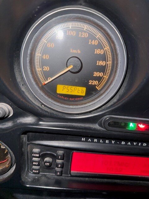

HI,
ON MY HARLEY TRIKE 2013 SHOW THE ENGINE CODE. I CHECHKED CODE BUT I DO NOT KNOW WHAT IS THAT ANY ONE CAN EXPLANE PROPLEM AND WHAT I CAN DO OR CHECK?
Doing a quick search, it appears that it may be faulty fuel injectors or a problem with a problem with the fuel pressure regulator. The P55PTB code is a generic code that indicates a problem with the motorcycle’s fuel injection system.
It is suggested that you may want to take it to a shop for a diagnosis and repair.
Don’t know how to explain this concisely but that’s not a trouble code. It a communication code , there are several type of those codes that will display while scrolling through the display. It may or may not be a “fault”. Best I can suggest is watching YouTube for info on how to scroll and identify what information is displayed.
Here is someone else’s response on another forum. What you are seeing is something that you need to scroll past correctly to get any actual “codes “
1) Hold button in at same time turn on ignition, this appears: diAG
2) Press the button this appears: PSSPtb
3) P flashes, hold button in, this appears: P0118.
4) Single click: "End" appears
5) Single click: scrolling across the screen; Pn-31871-11 appears
6) single click on the button: back to PSSPtb
7) single click gets S flashing, hold the button in, this appears: nonE
Not sure why this character appears here, text written is the number eight.
8)
Another single click, this scrolls across the screen: Pn 68924-07
9) single click on the button: back to PSSPtb
10) single click gets SP flashing, hold the button in, this appears: nonE
11) another single click this scrolls across the screen: Pn 70733-10
12) single click on the button: back to PSSPtb
13) single click gets t flashing, hold the button in, this appears: nonE
14)another single click this scrolls across the screen: Pn 74740-10
15) single click on the button: back to PSSPtb
16) single click gets b flashing, hold the button in, this appears: c1216
17) single click this comes up on the screen: End
8)
