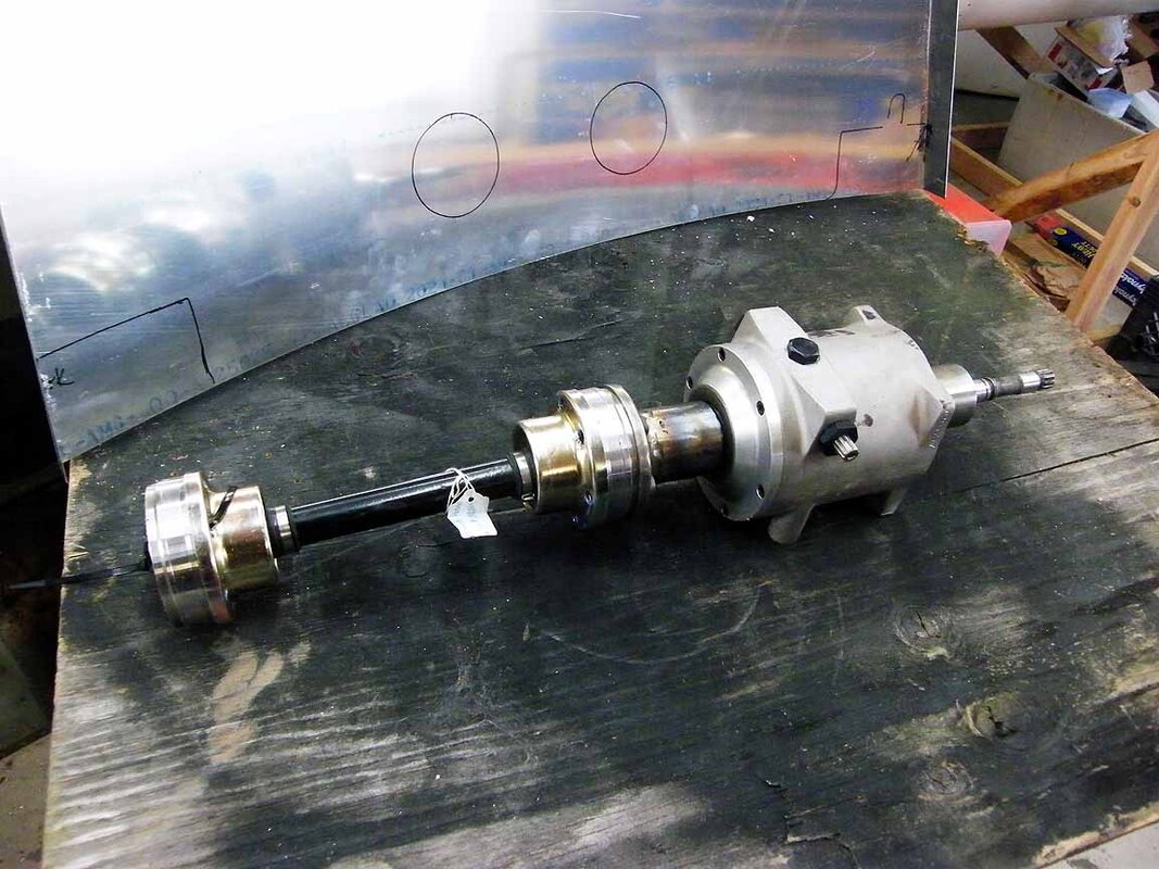

I did some heavy, backwards thinking for a long time when I designed my trike. The electric reverse was not an option because I have a fluid drive instead of a mechanical connection to the rear wheels. Ditto with most mechanical reverses that attach to/within the transmission. Since I have no gearbox, there is no option. I solved the problem with a simple transfer case that uses a planetary gear to reverse direction. it is the actual drive shaft. In forward (my only forward gear), two half-shafts are locked up 1:1. When I pull the lever for reverse (the only backward gear), the shafts part and a planetary gear cluster reverses the spin of the tail shaft section with a 1.5:1 reduction. I can back up a staircase as easily as go forward, and almost as fast. It has no limitations for distance (except fuel on-board), doesn't understand the concept of either a 2x4 or a basset hound as an obstacle, and has never, ever either popped a breaker or run the battery dry. In theory you should be able to run your gears in reverse.
I designed an IRS rear section similar to a Motor Trike ADV that is a rigid part of the frame triangle -- no heim joints or other bolted/adjustable points. So the CV-jointed driveshaft (in addition to being on a straight shot down the freaking centerline of the trike where it ought to be) has a constant, fixed angle. This makes engineering an inline reversing box relatively simple, and the cost is comparable to what you folks are saying these miserable, reverse "assist" (REALLY?) run you. I'm surprised the mega-manufacturers haven't figured that out.
The transfer case is marketed as a 'reversing gearbox' by a fella named Jack, who has an outfit called roadstercyle(.com). I don't know if it's proper to do direct links from here, so you can find it from those clues. Jack is a small operator who's quite good with the email and phone chats both before and after the sale. He says it's good for 500 forward HP. I have no affiliation with him or his business other than to have purchased and used his product.
The CV joint bolts to the differential pinion. The splined end engages the torque converter. The little splines sticking out the side on top is where the shifter lever goes. Very simple. The only drawback is that since I have no clutch I have to shut the engine down, shift, and restart.
