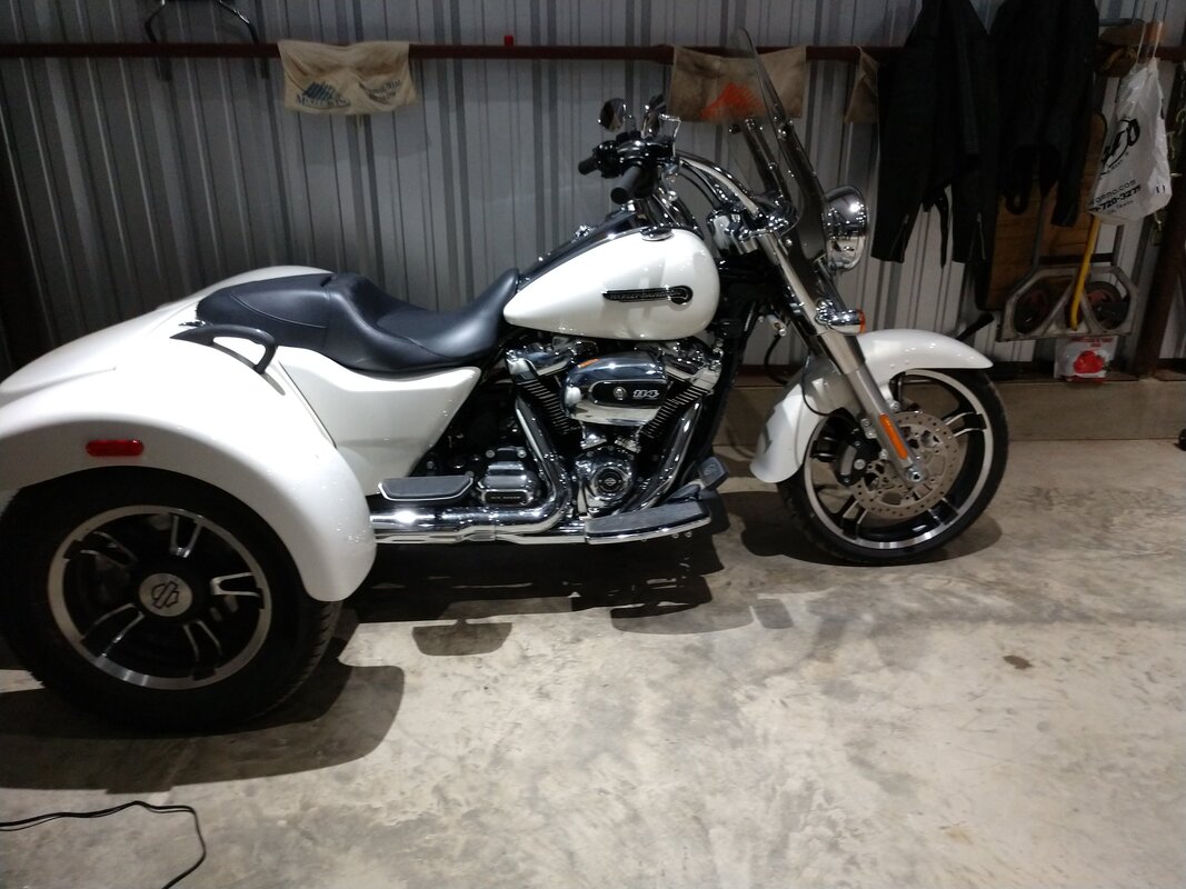

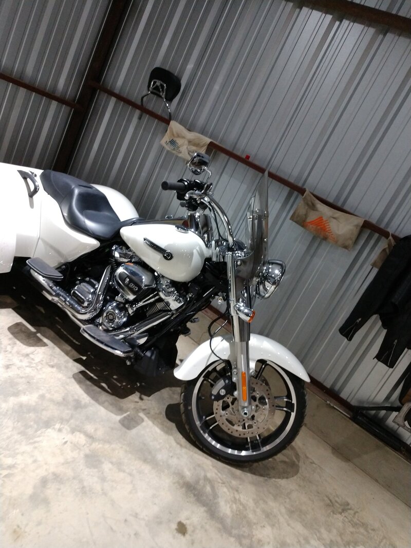

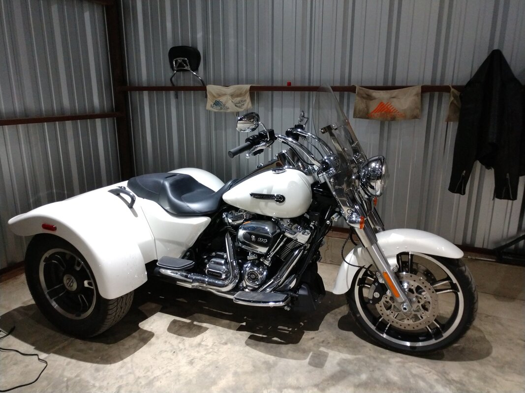

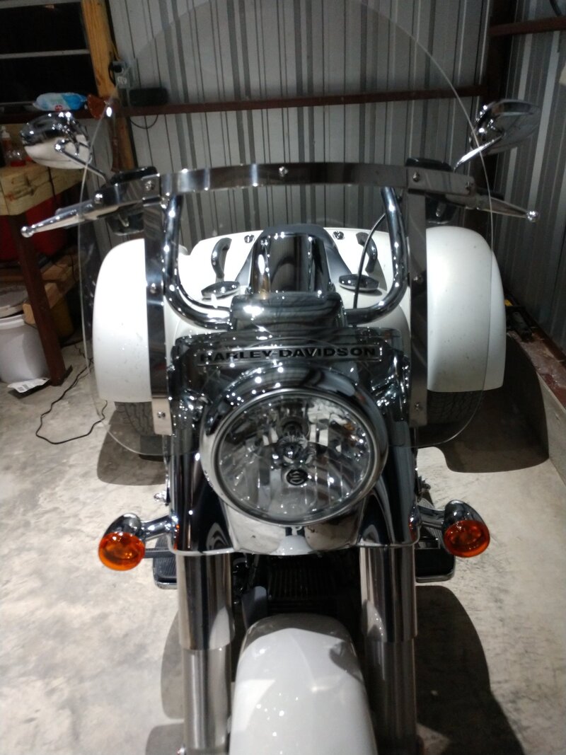

Got bars on and wife loves them, went with Khrome Werks Sweepers 300516. They are not (as far as I know called wide or narrow), they are not the ones made for touring models. The width at the forks looks correct, the 300518 that was recommended would have been too wide. They lay back, but they're bent and the initial rise from the forks looks like it's inline like it should. I had to use wire extensions for the controls, TBW was plenty long enough.
Hope the pics convey what I'm trying to get across.
