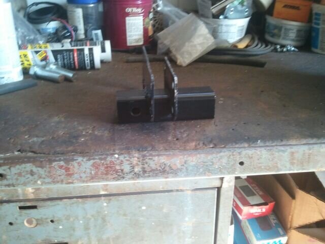

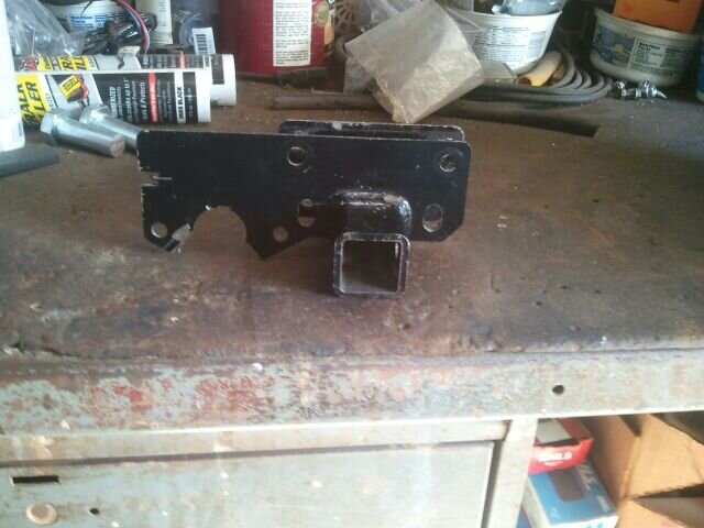

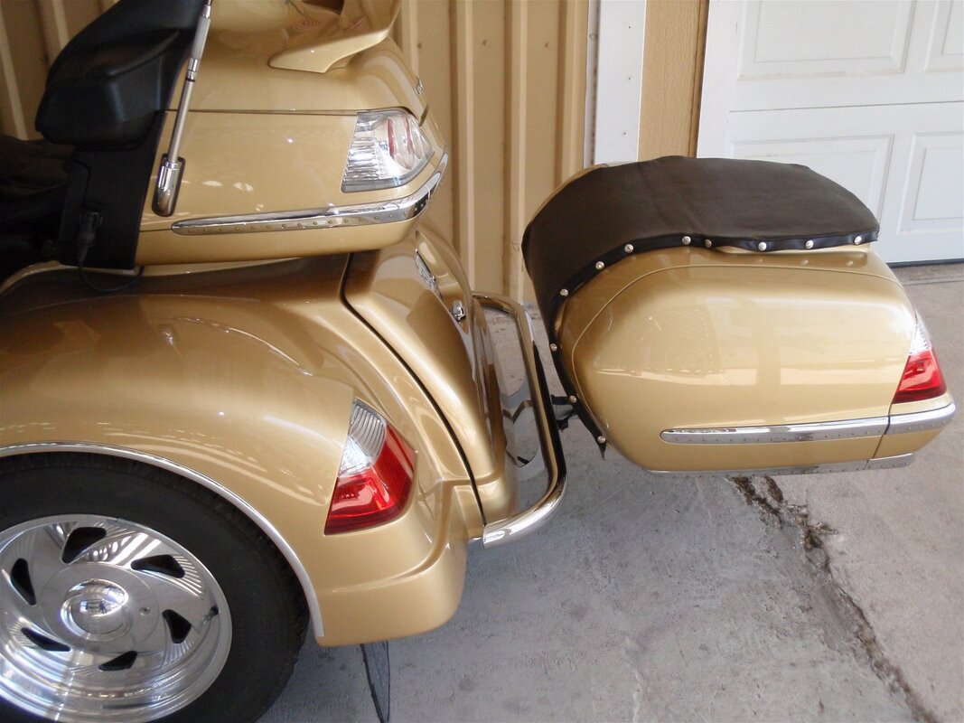

Take a look and see what your receiver looks like Kerry. First two photos are what the original I removed looked like. I don't have a picture of what I built but this second photo is what MotorTrike installs now. Having the forward anchor point adds a bunch of strength. The vertical weight bearing stayed pretty much the same but I think it's now capable of the 100 pounds MotorTrike says it will do. If you have the first style and can get someone to modify it to look like the new design I believe you'll be OK. :xszpv: :xszpv:

Mine looks like the bottom, it has the anchor bolt at the back. I went to motor trike web site, they say not to exceed 100 lbs tongue weight. I should be fine, I’m gonna be under 50lbs. How did your trike handle with your rack on back of yours.

That's good news for you Kerry. One less thing to worry about.
Keep in mind what I said about the weight I was carrying. Also how much further back that weight was setting. I does make the front end of the trike feel lighter. but not unmanageable. Longest trip I took was just over 4,000 miles rode Skyline Drive and Blue Ridge Parkway plus a whole lot of back roads. Keep your rear suspension pumped up a bit and you should be fine. :xszpv::xszpv:
