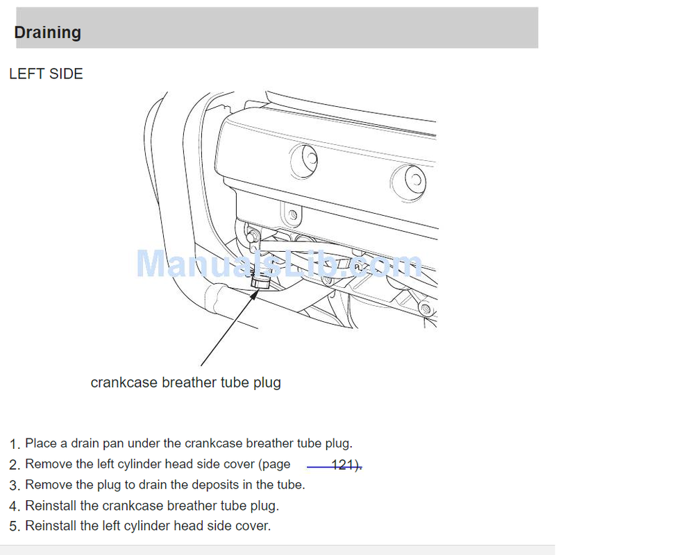

Also, Don't forget to drain the Crankcase Breather.

I am new to Trike Talk and to Honda GL 1800 trikes. How do you drain the crankcase breather? Thanks
Welcome to Trike-Talk....ThumbUp I don't have the answer for you but I'm sure someone will chime in with the info....
