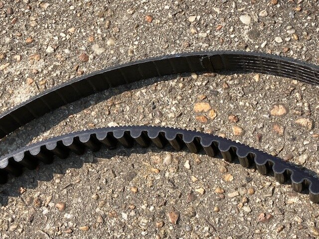

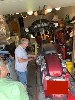

My son's Street Glide Special ate it's drive belt. He was two blocks away from home and was able to limp it there revving 3000 RPM at about 4 MPH.
Pix of belt change plus upgrades

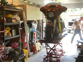

I took my TK1 trailer over to his place and hauled it to my house so we could work on it.
Got it on the lift and started tearing things apart.

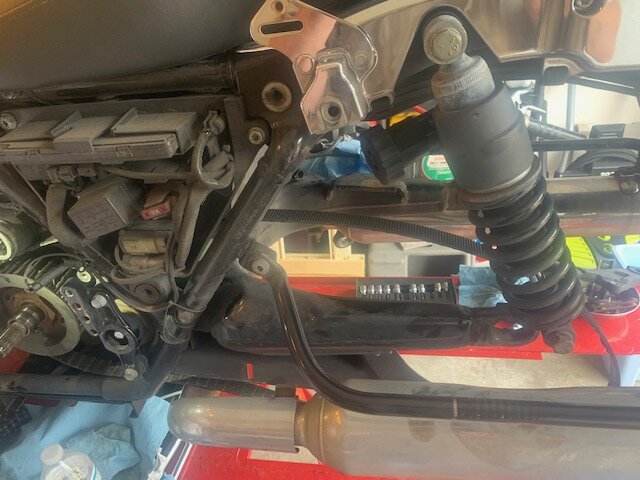

Finally got wheel and swingarm off and new belt installed.

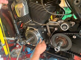

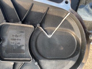

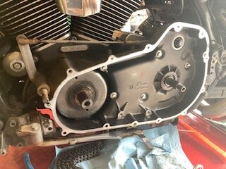

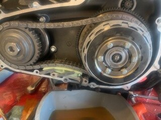

Putting the primary back together. While it was apart, we upgraded to a Barnett clutch with an added plate and disk. Put on a Baker compensator sprocket, a new chain and tensioner. Had to grind down a fin on the inner primary for clearance on the comp. sprocket (per Baker instructions).
(YES,we remembered to pull the tab on the tensioner before closing up.)
Good job, any prior symptoms the belt was on the way out?
He had some skipping on hard acceleration that he attributed to a worn compensator. That's why he had the Baker handy. Also figured that if he had to open the case, he would replace the clutch since it had almost 60K miles on it. (2014 model) daily driver.
