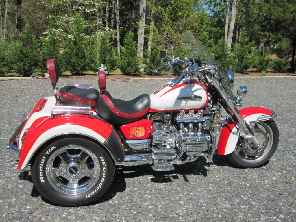

Just for some reference for the OP being that many of you have been mentioning a Valkyrie, here's a photo of my past ride. She was GREAT!!!
