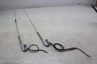

The Honda trike I bought has the chrome post that come upward but someone has taken off the two antennas radio and CB. Is there a certain type i need to buy and where to shop at?
With a GL1500, I am going to suggest eBay as probably your best bet like @trike lady mentioned in the other thread. Here is just an example and I'm not recommending this as the only choice.
If you did something like this, you can just unscrew antennas from the original base and then screw them on to the bases that are already in your trike. The one with the black load in center of antenna is the CB antenna and gets mounted on the left side. The CB antenna needs a good ground. It wouldn't hurt to attach a separate wire to the antenna mounting screws/bolts inside the trunk and then run that out of trunk under the seat to a bolt on the frame. IIRC, the AM/FM antenna besides the wire with Motorola connector has a 2nd wire with a bullet connector for grounding on and should plug in somewhere again under the seat.
Thank You, That's all I need is the upper parts
