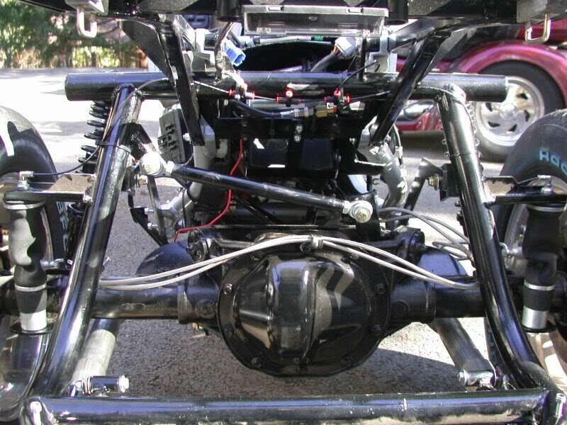

One more thing I have to have spring pre load on right rear shocker up as high as it can go and the left shocker spring pre load set to it's softest setting other wise the bike leans to the right. I was told to do this by the people who fitted the kit from motor trike. I bought this trike off the last owner as he couldn't ride it I don't think he got much help from the dealer ( eagle trikes Queensland Aust ). Do you know of better springs for the rear shockers and can you fit a stabiliser bar Regard Graham
Thanks again for you help steering pre load nut set to 45 ft/lbs , rear tyres 22 psi , front tyre 41 psi it has made a huge difference What front tyre would you reccomended when replacement time comes. Regards Grime
Glad you had a good result from the tweeks I gave you. I know some folks have a hard time with the idea of torquing to 40-45lbs, but many years of personal experience has shown me it works well and will not compromise the flat tapered bearings that Hawg Halters supplies. As for the front tire, I recommend the Bridgestone BT-45. It's about as wide a tire as you'll get under the GL1500 fender and it has an excellent tread life. Its actually a rear sport bike tire and some run it in reverse rotation while others run it forward. I run mine in the forward rotation, but I have no real preference on that and will leave it up to you to research and make your own decision. There are numerous threads on this forum with opposing views on that one.
Do you know what year your Motor Trike kit was built? Does it run both the coil-over shocks and the air bags as in the picture above or just shocks? If it has both, are the air bags taking and holding air?
Either way, there is no good reason to have to set the pre-load of opposing shocks to the highest/lowest settings in order to level the trike. This is not the the correct fix. The problem you are most likely having is that the heim joints in the front of your ladder bars are binding. This will make your bike sit at a lean. Read my previous posts above about checking and lubricating the heim joints and get back to me once you have. If that is not the problem, we will figure it out and have you on the right track straight away.
