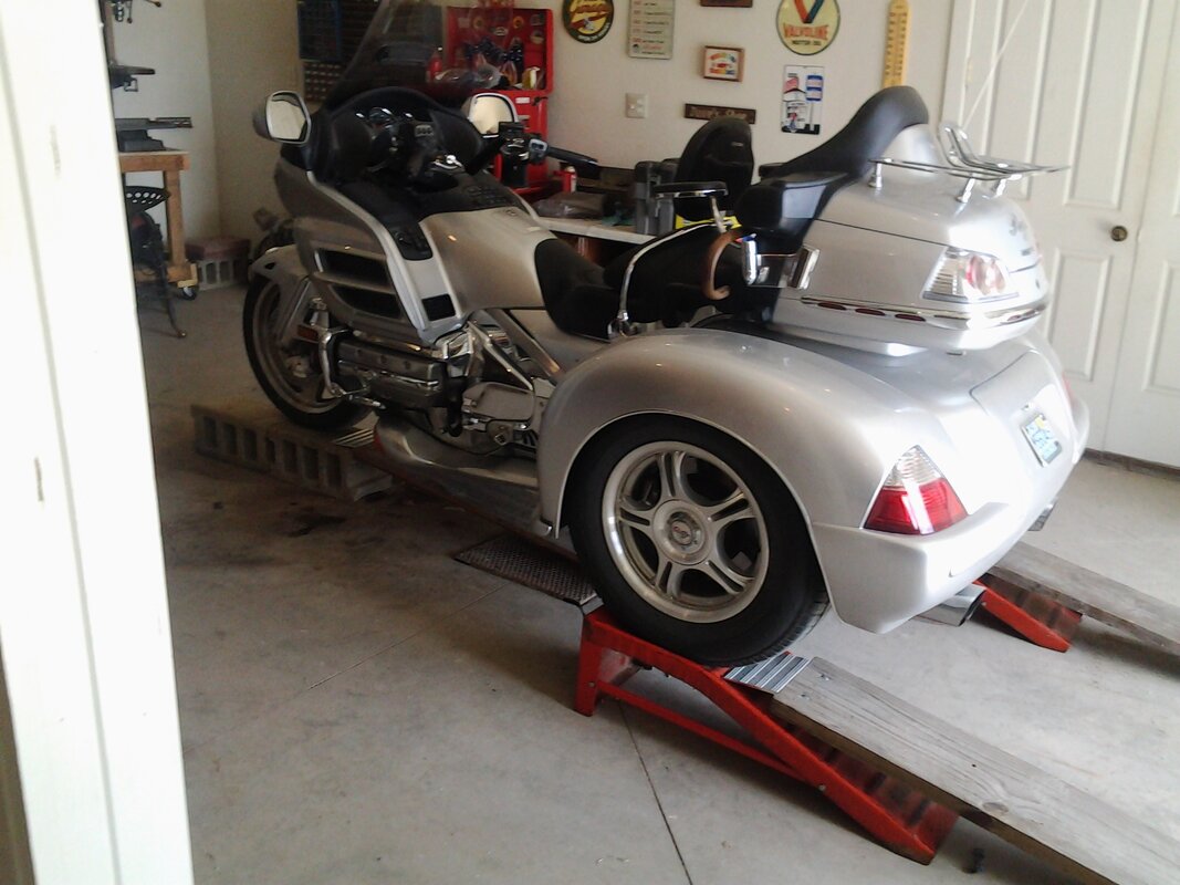

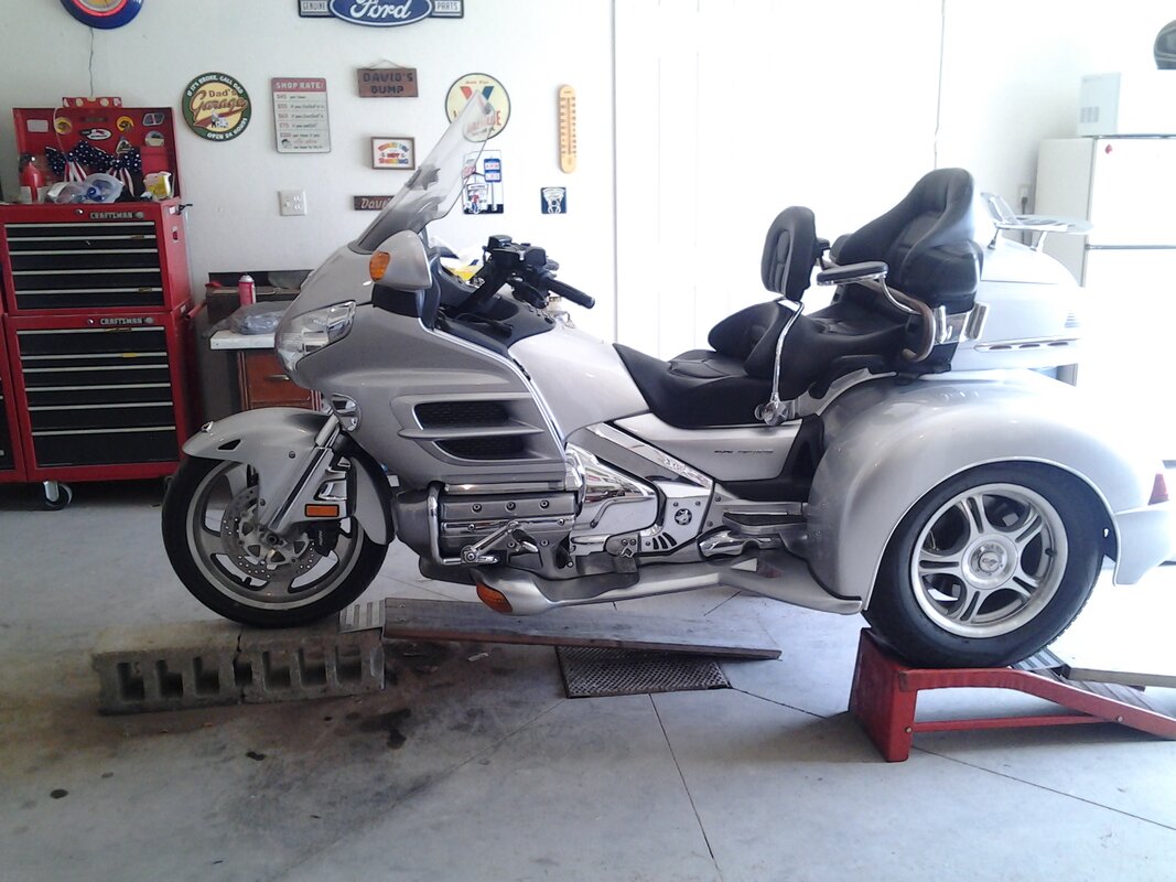

I looked at lifts, but I didn't have the place to put one. I wanted something to use where I parked the trike in the "Trike Room" … so I built three blocks to put under the tires that are 6" high, I also made "ramps" for the two larger rear ones that are detachable once in place if desired. The front block is 6" wide and has a area in the center with strips on the edges to locate the tire dead center. 6" higher is like doubling ground clearance, makes for easy oil changes and even cleaning access underneath, I usually jacked the trike to put up onto blocks, but used ramp for backing rear off once front wheel was on the ground. If pulling wheels off, I used jack stands so the suspension was dropped anyway.

GrandpaDave, this is a great design! Most lifts lift the trike but don't provide clearance between the lift floor and the underside of the trike. For trikes with ground effects, it's even more difficult to gain access to change oil, etc.
