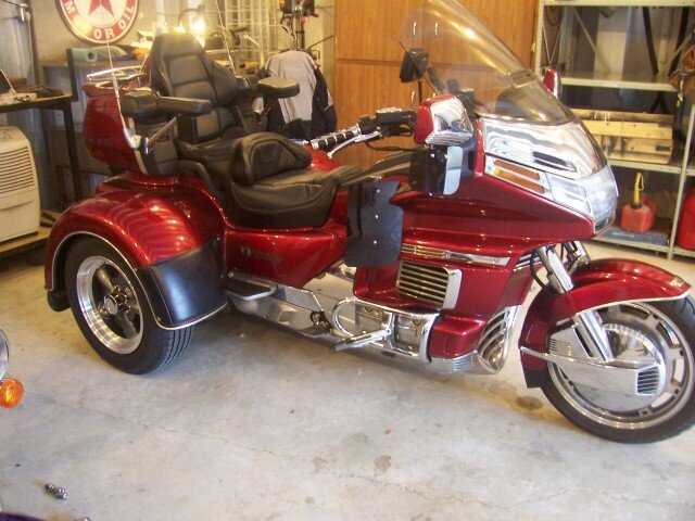

Here's some pictures of my trike with new back rims
Could you explain the improvement in the ride? Change in mpg?
Will have to check mpg. Rain today. Put the tires and rims on today and got in a short 20 mile ride. Did the same ride with the old tires when I was trying to find out what was making the rear end feel so loose or as I call it dancing. Switching from the 235/60/15 BF Goodrich to the 205/65/15 Dunlop Signature series was a good switch. Didn't feel any dancing in the rear end and also rode softer. Like a different bike. I also install dyna beads instead of static balance. I'm sure I will get a little less mpg or may not. It raised my rpm by maybe 100 rpm. I do like the added low end and mid range power.
