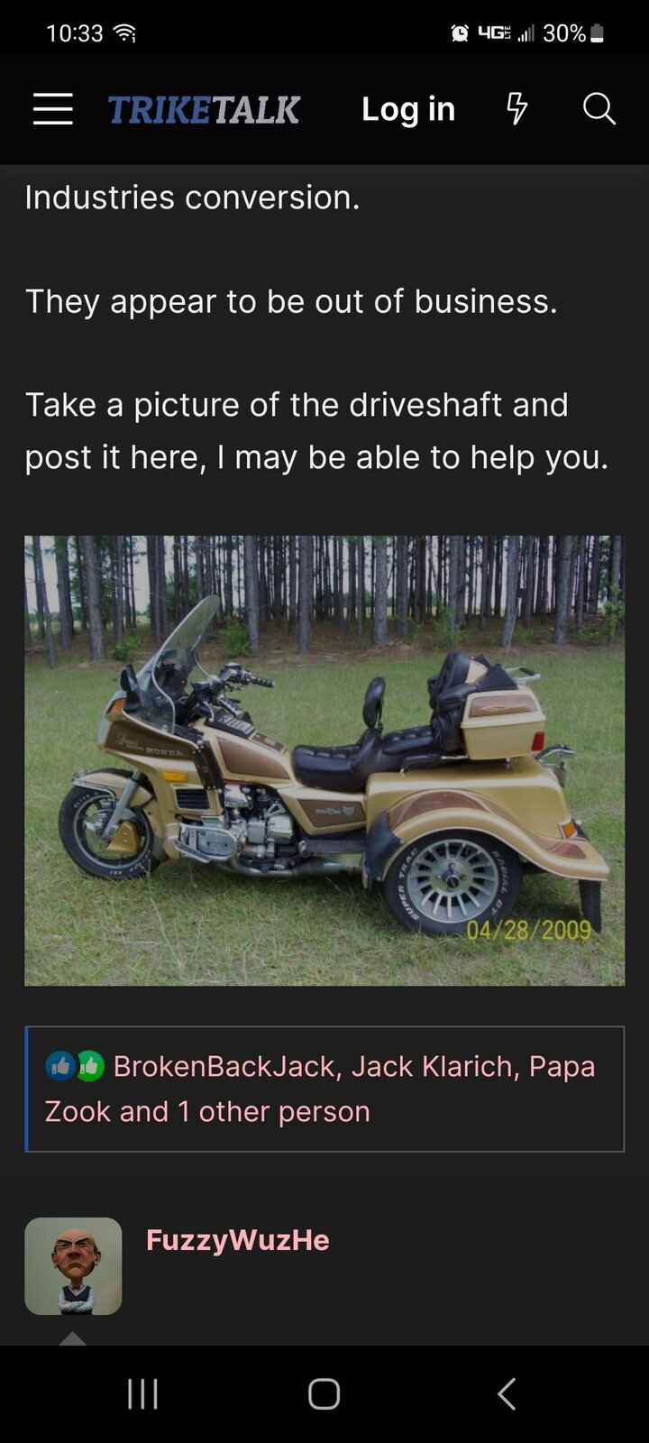

I have a 1990 honda goldwing gl1500 that I made to to a trike trying to get the drive shaft right the one the kit came with I do not think works correctly the info I had found out is the trike kit was made by trilingual industries witch is up for sale does anyone have a company I could talk to more about info

Yes the original drive shaft keeps slipping off the sprocket shaft for the trike like it is too short I did have it fabricated to a point but did not work
When the front universal is installed is the heavy spring included?
#3 in diagram.
Screenshot 2024-05-25 at 23-18-23 1993 Honda GL1500I AC SWINGARM CyclePartsNation Honda Parts ...png
The spring keeps the universal joint on the motor output shaft.
