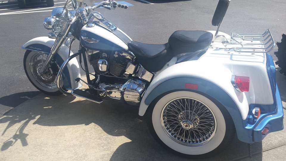

I just got a 2005 H.D. softail deluxe with Lehman Renegade kit(17k miles). I've been told there's no way to improve ride quality as I have the wide, wire rims and tires. Anyone have any info on replacement /better shocks for the straight axle,belt drive kit possibly from '05?? I've enjoyed the ride and price of J&P shocks by Progressive on other rides. Had to switch to three wheels due to medical issues and am shocked at how hard it is to get any help from Lehman or Champion.

What rear tire pressure are you running Ron? Lowering it to the 20-22 lb range helps a lot and changing out the shocks can also help.

It is presumed that you have adjusted the air pressure in the rear tires and checked the spring setting on the rear shocks and none of these corrected or changed the ride. I have installed Harley-Davidson air shocks on a few Renegade Softails.

Thanks everyone for the "welcomes".Jim, yes I have @ 20 psi in rear tires and have added preload to shocks. The shocks were on lowest setting and I've got up to middle setting in my trials. I plan on trying more but am expriencing a lot of bounce now.The tires are not low-profile and have plenty of side wall. I agree trikes are very sensitive to both tire pressure and shock settings but I feel the shocks were not up to task of the heavy,wide tires when new,especially since they've aged. I'll see if my wife can help with getting a pic on here if it ever stops raining in Ga. I'll check with my bike shop to see if he has any HD take-off air shocks that I can try. Any model of air shock should I look for? Trike,Ultra,etc? I need the rear brakes adjusted and the rear end gets high-speed grease.... any tips on those or they straight forward do-it-yourself things?

A little over two years ago one of the T/T members had an issue that was similar. It turned out to be one bad shock. Since you have a non-flexible swingarm, it is difficult to determine which shock it actually is. I would continue to increase the pre-load and if this does not improve the ride, it could very well be a bad shock or shocks that are too short (less than 13.25").
You could replace the pair with another set of coil-overs or get a set of air-rides from a Harley-Davidson Ultra. The H-D part number is 54565-97C (13") and you can find them USED for sale on eBay relatively inexpensive and fully functional. I just checked and there are over 50 listings right now. Try to get a set with lowest mileage, with air lines and fittings and change the fluid before installing.
