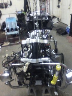

Hog halter raked triple tree

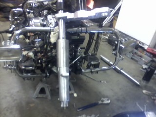

Tube installation, Put away your pipe wrench you don't need it.
This tree will come with upper tapered bearing you will need to get a new stock lower bearing. Slack is taken out from below the stem with a 3/8" socket wrench and the front brake splitter attaches at that same spot. Tighten upper stem nut at least 20 -25 lbs. tighter than stock. Don't worry about fall away it no longer counts.
The upper tube screws into the upper tree so you cant screw up on alignment.
The lower tree has set screws to tighten the lower tree clamp and is very much better than stock.
If your really interested google-pcombe photobucket/library.
I documented my build. If you click on a picture it will give an explanation of what I was doing and also a tip on how to remove the bottom bearing race in the neck.
