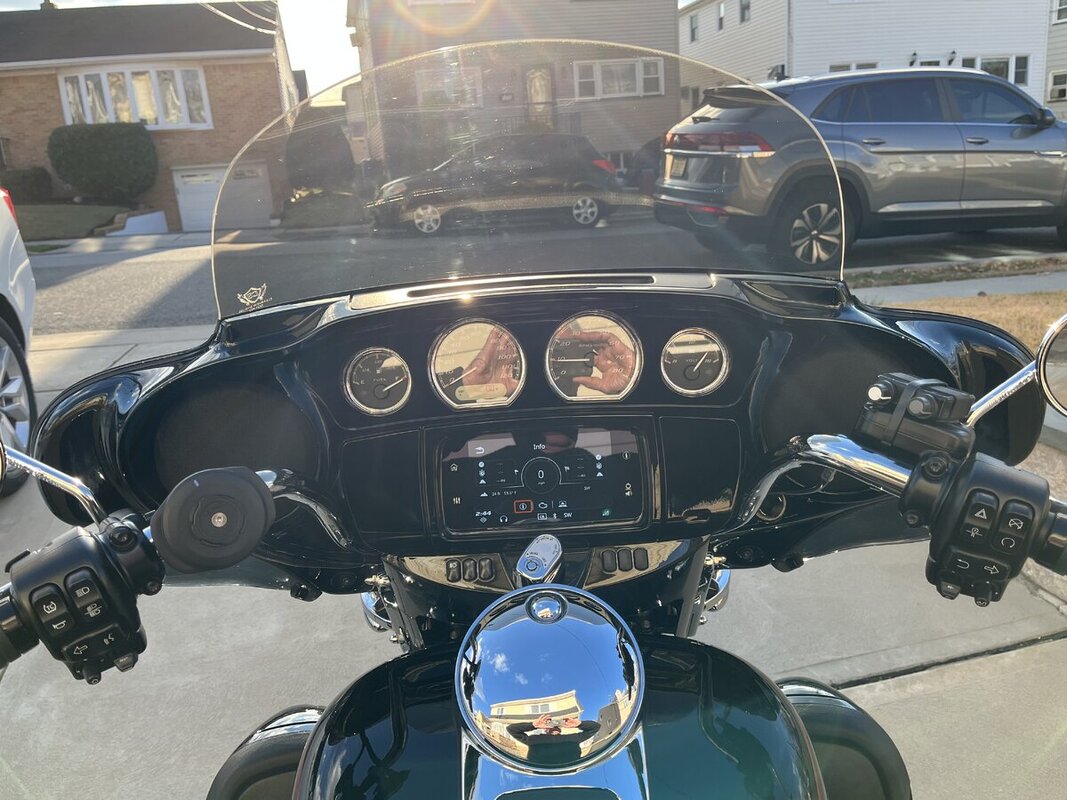

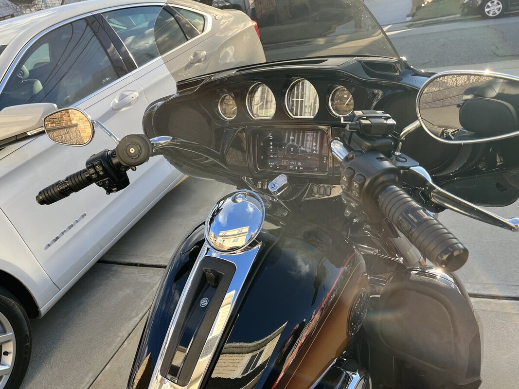

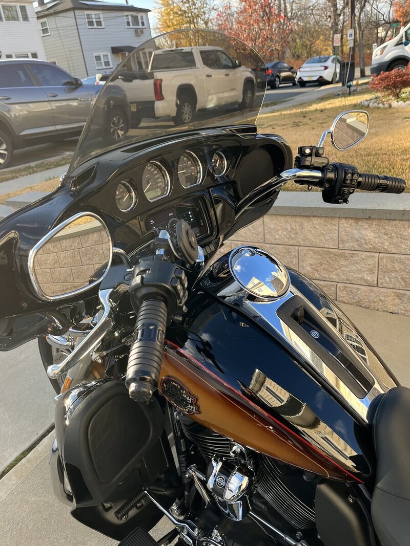

After installing everything internally extensions were needed for both the heated grips and the switches. But, after rerouting the clutch cable from on top of the goose neck to around the front of the goose neck, and making sure all the zip ties were eliminated, it's looking like I won't need to extend the clutch cable.Will use zip ties where needed after I can confirm there's no issues with the full turning radiuses or issues of possible chaffing in the future. Not sure yet about the front brake, haven't gotten there yet but not anticipating too much of a problem. Planning on finishing this all up this afternoon. I will advise after all finished.
Well, the project is complete! I'm happy to say that a clutch extension was not needed and I got away without rerouting the front brake line. So, it is possible to install the Khrome Werks 2+2 bars and wire them and the HD Kauna heated grips internally with only purchasing the switch extension kit. Extension wires come with the Kauna grips. Weather isn't right up here in Illinois today so I haven't been able to take it for a test ride but it appears to turn stop to stop without any problems. This work was done on my 2022 Tri Glide Ultra. Safe riding everyone!!
