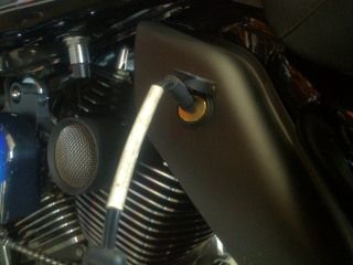

Ok delta, usually a picture is worth a thousand words...but in this case...I need some words. What is that?
Jerry
That is my battery tender cable plugged into the same connector I use for my Gerbing heated gear.
Here's a link to the socket: Firstgear Coax Panel Mount Socket - Whitehorse Gear.
If you have a Harley adjustable backrest you can mount this on the right side. I have a Mustang and it didn't matter.
I use this setup for both my heated gear and battery tender.
I've done the same thing for my heated gear connection, but I'm now finding that the cover is bending the post that plugs into the connector. The spring or whatever it is that keeps the cover on is pretty strong and I'm concerned that I've ruined the plug from the controller. I've thought about cutting off the end and putting on a plug with a 90° bend so the pressure wouldn't affect it as much. Anyone else having anys problems with this setup? Otherwise, it's great. Very convenient to get to.

Well, the spring loaded cover finally bent the plug enough that it no longer worked. A friend of mine with more talent and patience found a plug that has a 90° bend and replaced the whole plug piece, so now there shouldn't be the pressure on the plug. Hope this one lasts because it is so convenient and looks good when not being used.
