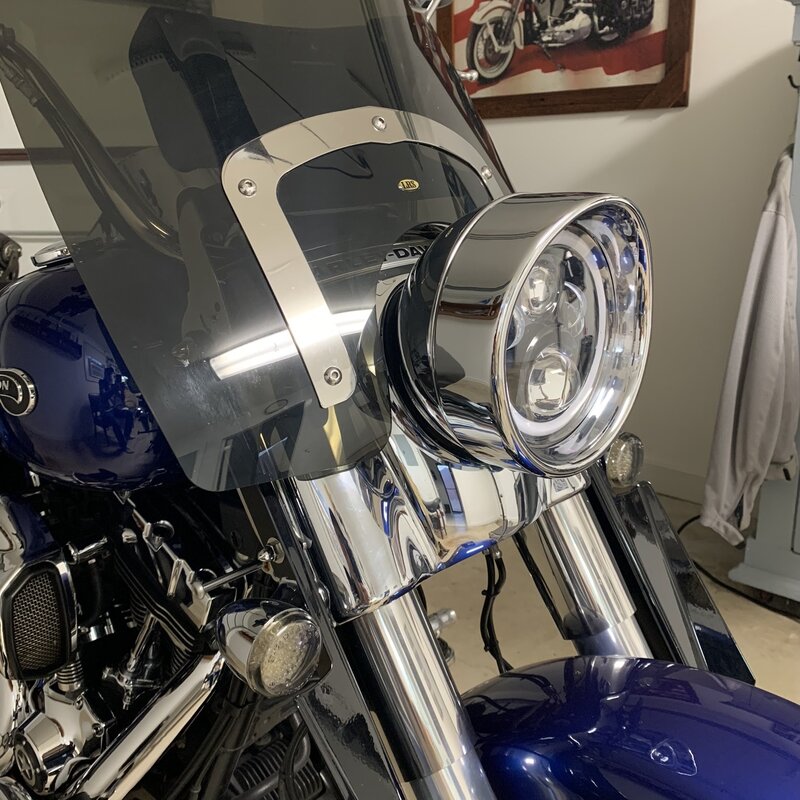

800AC5CB-2883-4BF1-9BC7-34288072CD38.jpegI can offer this for a solution. This is 69734-05. It was pretty easy to install. I have no experience with your visor, but I’ve been pleased with this one.

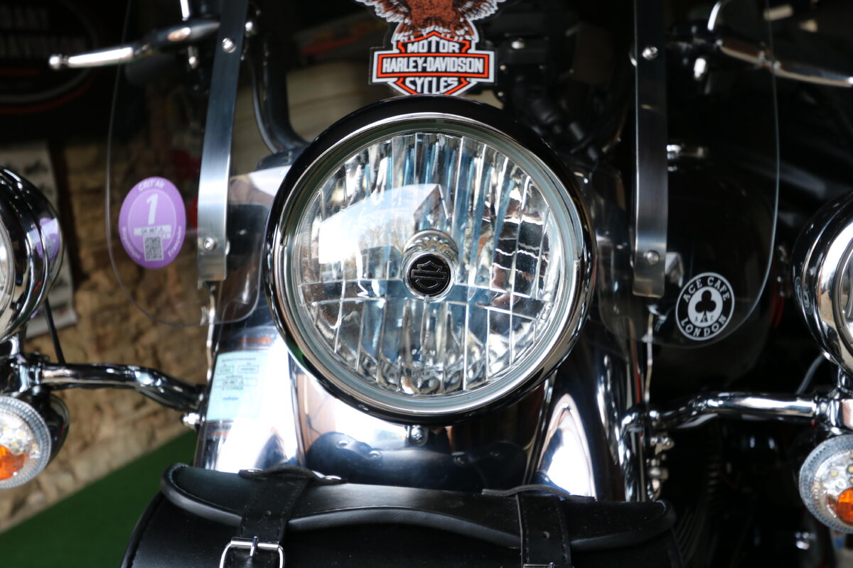

I attach two photographs of my newly installed visor (part number 67752-77T).
The visor simply would not allow the bezel to fit correctly all around with the retaining ring as supplied.
Eventually I had to cut out the top two thirds of the retaining ring (equivalent to the radius of the visor), and retaining the lower two thirds and two retaining screws.
Only then could I insert the visor and fit the bezel correctly. View attachment IMG_1639.jpgIMG_1640.jpgView attachment IMG_1639.jpgIMG_1640.jpg
All is now correctly fitted, as you can see.
