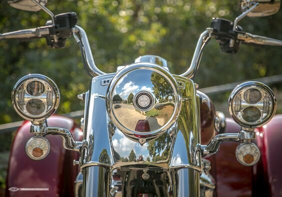

"The European Freewheeler does not have a central headlamp, unlike the American models featured in their accessory catalogues, but has two “passing lamp” type lamps either side of the central headlamp which, in the European version, is replaced with a circular chromium blanking dome, a bit like a hub cap"
I must be dense because I can not find any picture of this setup and am not able to picture it in my feeble mind.
I looked on Harley France and the freewheeler looks the same as the US model. Do you have any pictures of this setup?
Euro Freewheeler
Picture of Euro Freewheeler.
US Freewheeler does not have the lightbar with the two driving lights.

Here are the photographs of my successful conversion from the European blanking plate ("hub cap" or dustbin lid") to the American version headlamp.
The conversion used the parts I listed above.
The blanking plate photograph is not my trike, the headlamp version is my bike.
