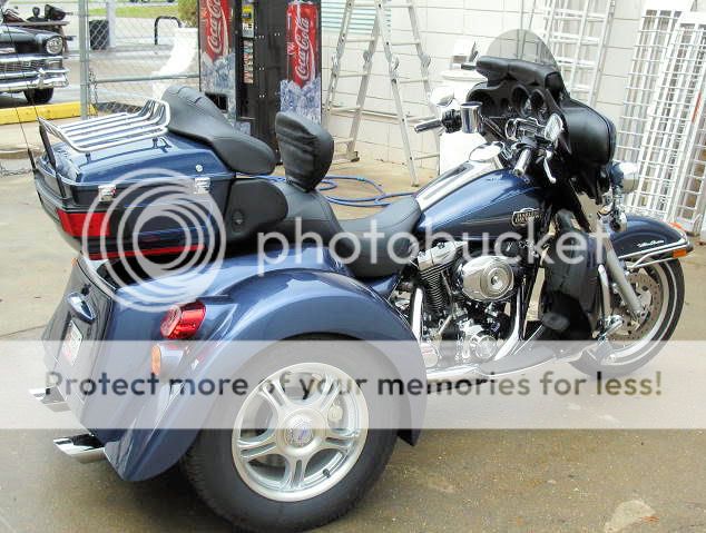

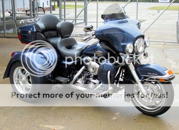

Re: Harley Ultra Conversion FINISHED
Zook took care of me. Finished yesterday. Pics in the Harley specific forum.
Bryans 08 Harley Ultra/09 Champion Trike, Reverse, EZ-Steer
