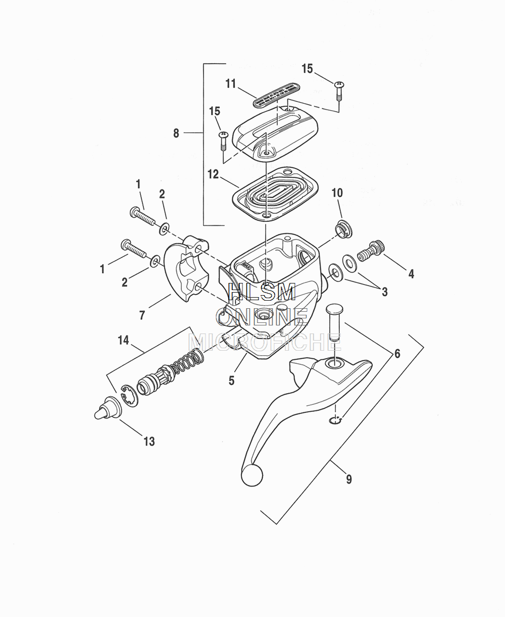

If you are working on or near your RS handlebar and the front brake, be sure you wedge a folded piece of cardboard in the brake lever between the lever and the perch in the picture below
A Broken front brake light switch could result even if you are changing grips BE CAREFUL
