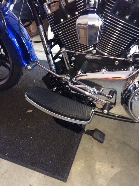

what do you have around the footboards? have you controls been modded and if so by who?

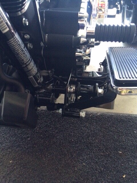

It's round bar that was formed in the profile of the floorboard and angled out a little, it's used to keep my prosthetic from sliding off. Yes the controls were modified; a linkage system and a left side brake pedal were added so that I can use my left foot to shift and brake. Both were fabricated and installed by Maxwell Brothers Cycle Shop near Petoskey, MI. They are a good group of guys at that shop that make sure that any mod's are done to meet your expectations and needs.Red

i need the same thing except i need to move the shifter to the right side or come up with a way to shift the bike. building a cage around the footboard is going to have to happen too. thanks!

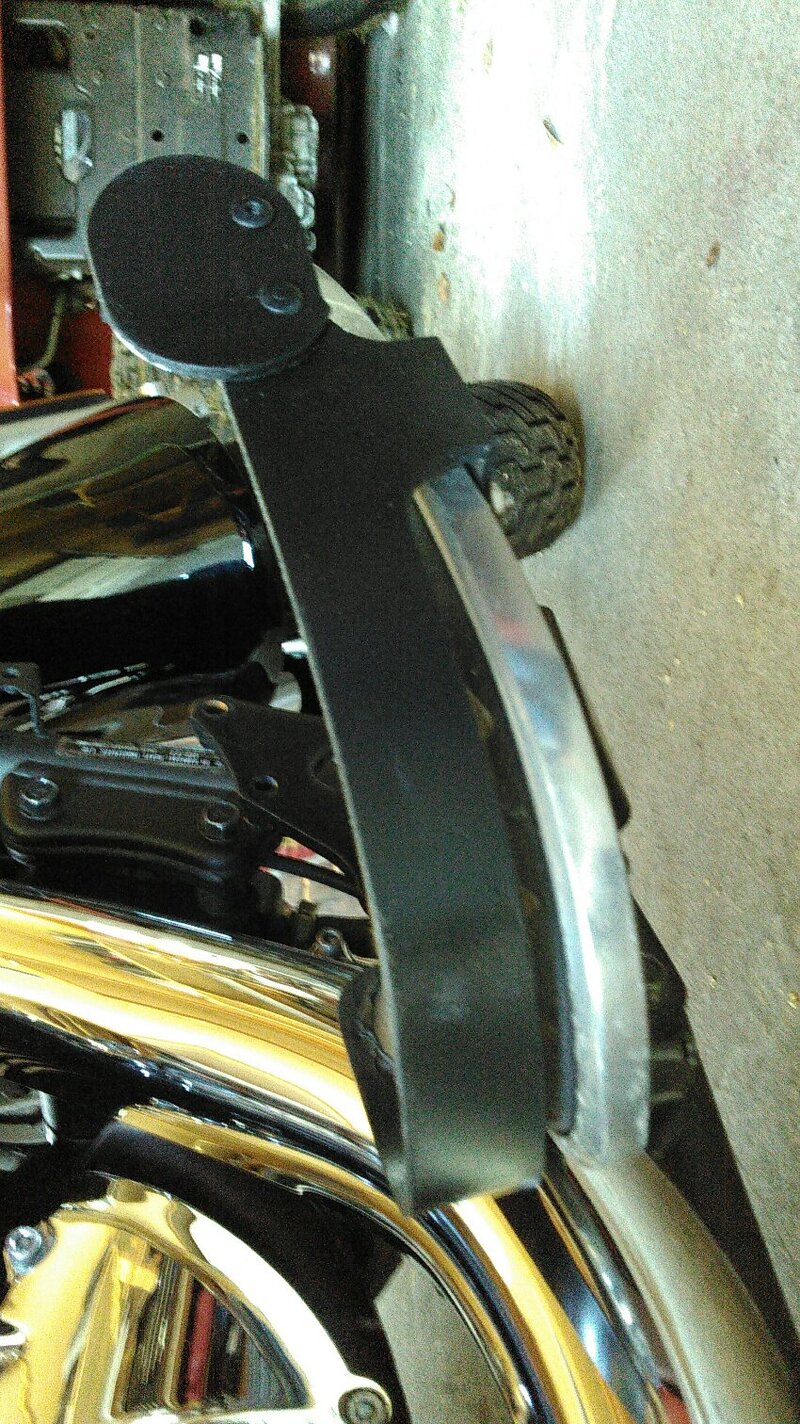

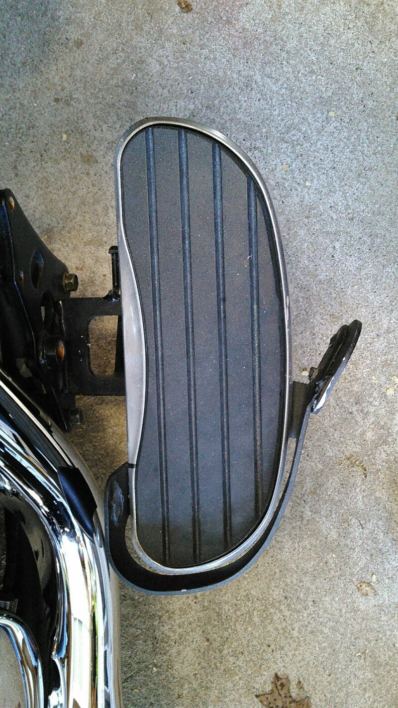

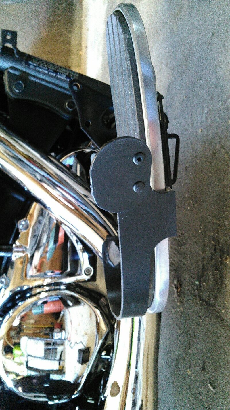

I think I shared these pic's before but I made this from a piece of 2" aluminum angle iron for my last trike. Couple hours time cutting and forming wasn't to bad to fabricate. Since Maxwell Brothers was doing the brake mod I just asked them to come up with something for this one.

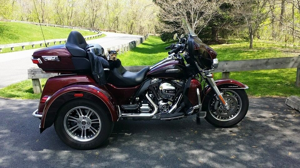

Roxy has 7700 miles on her and we really have no heat issues (all stock exhaust with cat). She sounds much better than new .... so some of that exhaust packing has loosened up! Like above I think you really need at least 5K miles before the engine can be considered broken-in. I remember when new you could hear the pistons going up and down ... it was tight.
I contemplated many of the suggestions for lessening the heat .... but decided to wait. For the style of riding we do .... Roxy is fine as is. Down the road, when the warranty is up, I may have the itch for some major engine upgrades and a tuner.

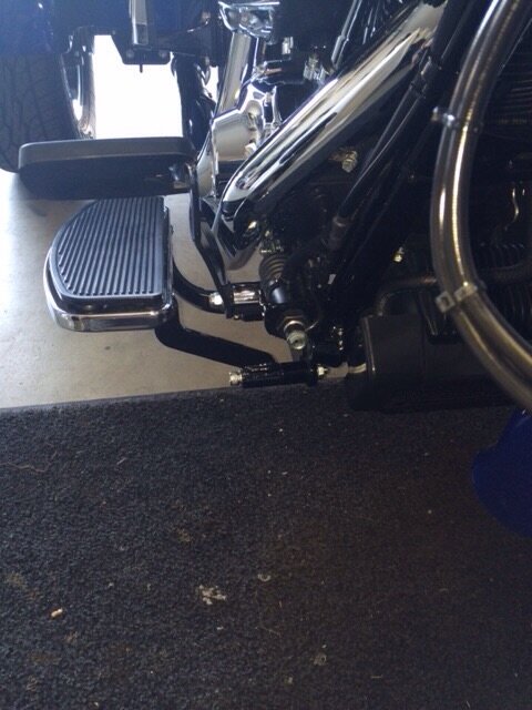

We live on the desert in Southern California, we have hot summers too. The heat you are feeling is radiated heat from your engine. Removing the cat will do very little. The problem I have found is proximity of your lets to the engine. I put floor board extensions on wife's Tri-Glide and my Freewheeler. That extra inch really make a difference for under $100.
I agree with screwball living not to far from him and it gets hot here. The floorboard extentions are sweet. The extra inch helps a lot with the heat plus the added benefit of the room they give you.
Floorboard extentions are one of the first things I installed on the Freewheeler. A must have on a Trike in my humble opinion. The floorboard extention kit ran me $49.95 plus shipping.
