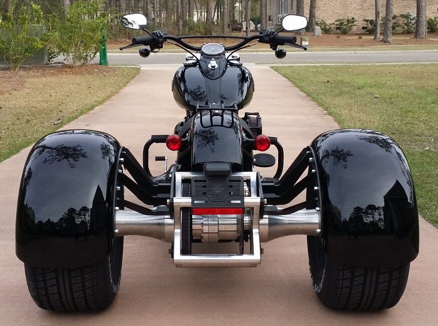

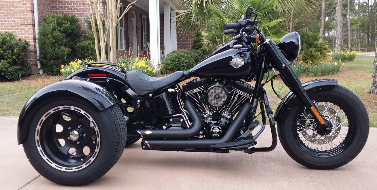

I have a 2016 Softail Slim S with a Frankenstein Kit. It is a straight axle and I have had 7000 trouble free miles on the kit. I love the look of the Frankenstein kits with the fat wheels. The straight axle gives a stiffer ride but I wouldn't have it any other way due to the handling characteristics and simplicity of the design. This will take corners like it is on a rail. If I had to start over I would buy Frankenstein again.
View attachment 54029View attachment 54031
Man that is a great looking trike Steve.

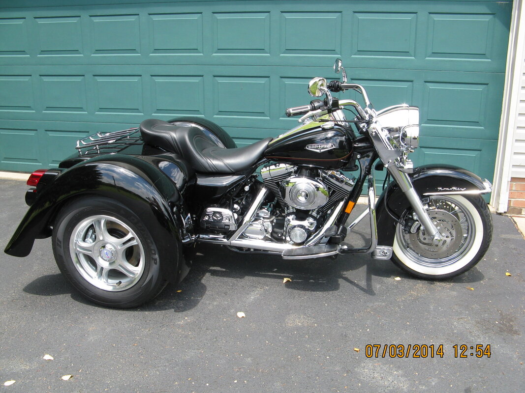

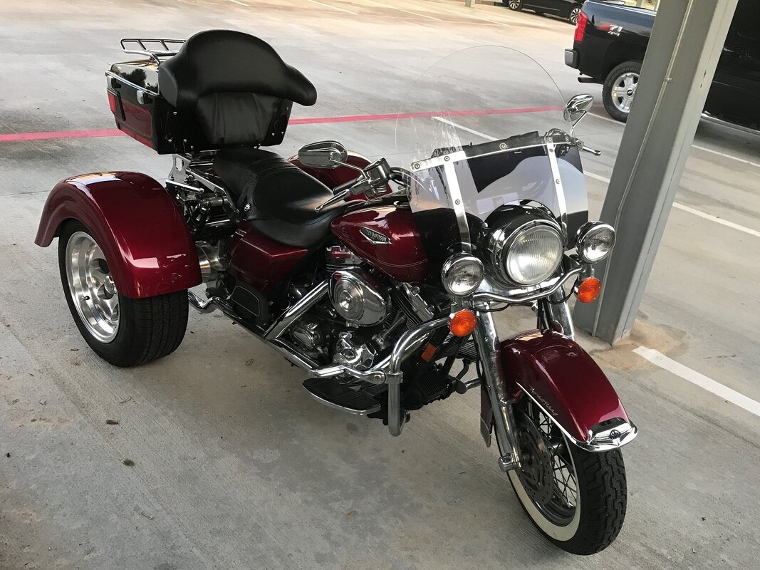

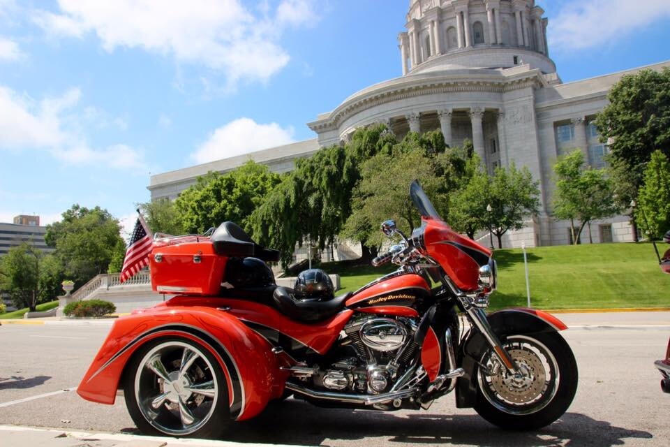

I have a Roadking with a IRS Champion kit. There is absolutely nothing I don't like about it. I have no recent pictures of it, but here is one from a couple years ago. The only thing that's changed is the bars. I put a set of heritage style bars on it because the wide bars just weren't getting it. I test rode several conversions, solid and IRS, as well as a TriGlide and I too much prefer IRS. I've had it for 5 years now and have had zero problems with it. A dead battery doesn't count. That's the only thing that's crapped out on it.

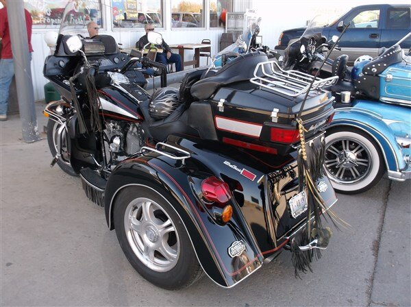

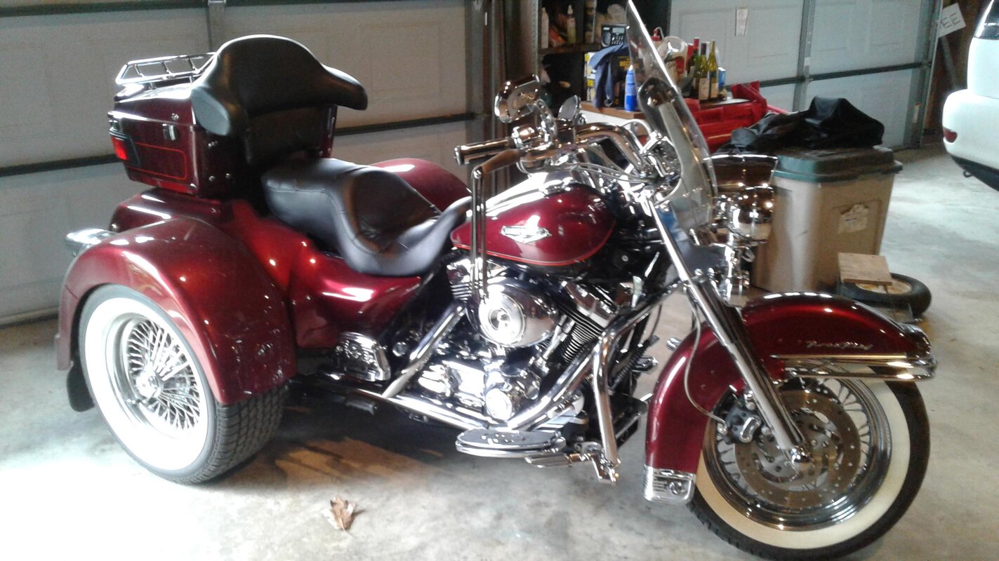

I have had this Trike over 2 years now. Have not had one problem with the 2008 Champion conversion. Straight axle rides nice have Harley air shocks set at 20lbs and the rear tires at 19lbs. I did replace the front fork air system with Progressive Monotubes to get rid of the nose dive. Front tire is set at 35lbs. Got a couple of plus's as rides better and steers better.
I am very happy with this trike even if the bike is 25 years old. If I was to replace it I would convert a bike again and set it up the way I want. And Champion would be my first pick. I have found the Champion very easy to work on. Picture is at Car & Bike Show it took best in show custom trike.

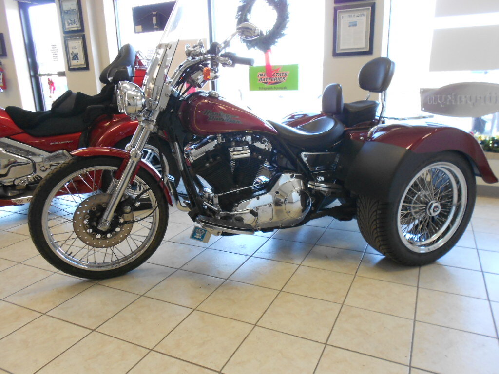

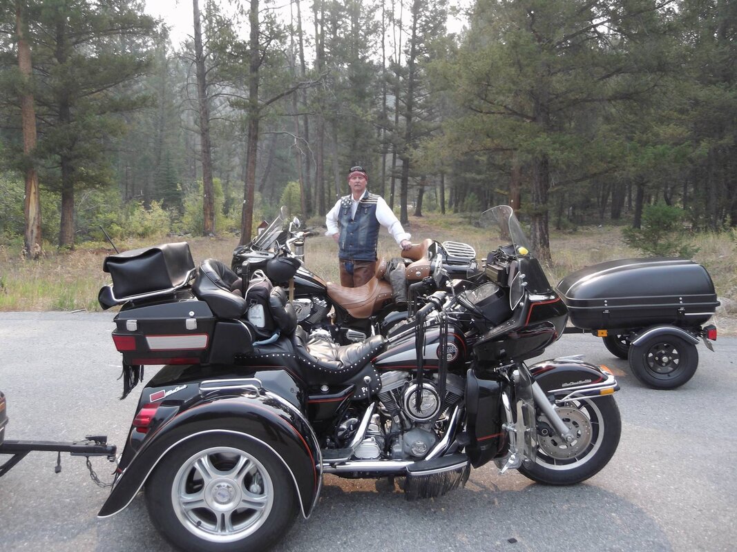

Self built, 1989 Harley Davidson Tour Glide Ultra:
Champion straight axle kit, 9 degree overall raked front end.
This bike has been rebuilt from the ground up except the transmission, It has over 100,000 miles on the clock but that is irrelevant except as it concerns the transmission," I have had the top cover off and the gears look fine, I replaced all the seals etc.
It has an E-27 cam in a new 80" motor. It isint a speed demon but its no slouch either even pulling my tailor.
perhaps a guy would want a bit more uhmff in long distance two up travel but i mostly ride by myself, even long distances.
I upgrade the charging system so can charge the battery in my oxygen machine if necessary but i wouldn't run it constantly due to amp draw.
I love this bike and have owned it all it's 28 years.
The champion straight axle kit has been trouble free for around 30,000 miles.
It is one of the easiest conversions to do as it is simple and straight forward.
I still do the lions share of work on my bike. Unplug a few wires, remove the travel trunk, Take out 6 bolts and lift the body off and i have full access.
It is also is a damn tough kit, It was hit twice on the rear end by car and didn't even crack the fiberglass, In fact it didn't even knock the axle out of alignment.
a little scratch repair and new paint and it's 100%
If i were to convert another bike for myself i would go with the champion straight axle again.
it rides a little rough in town but smooths right out on the highway which is what i built it for.
i have ridden and worked on IRS systems and they have their purpose but i dont really care for the centrifugal force exerted in a high speed corner.
It isint that you cant get used to it, Its just not my choice?
Good ride in town though, Momma might like it a bit more if hits a hard bump But if shes that delicate she probably wont like an IRS system either?
I purchased my kit through Papa Zook here on Trike Talk at a great price in the spring of 2013.
I also purchased a hog halter 5 degree raked tree from Papa Zook here on trike talk and with the natural 4 degree stock rake i have 9 degrees overall and it is incredibly responsive, ( beats hell out of a tri glide ) and provides easy one hand steering. The raked tree is quality, easier to install and about half the price of others you can buy.
I would recommend hog halter any time!
A steering dampener was unnecessary. I found a way to keep the stock anti dive system intact by making a few one off parts.
i recently added a new stock front end and a set of heavier progressive springs and i run a back tire turned opposite rotation and get unreal mileage and traction is not a problem.
It just loves mountain curves and my cousins new Indian road master cant run with it in corners.
Here is a stock picture.
For pics of my build visit pcombe photobucket/library
Click on picture for an expanded view and an explanation of what i did?

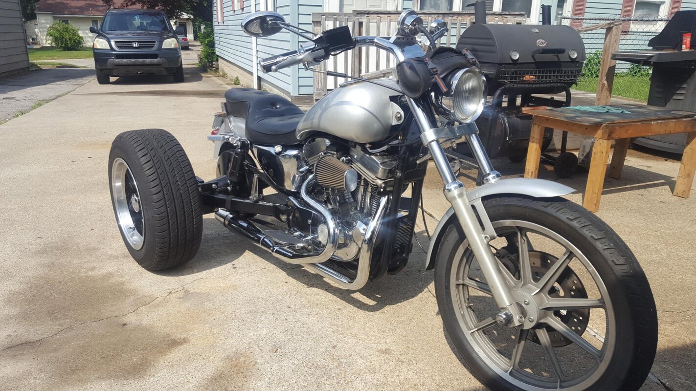

I dont have a pic of mine on my laptop but I've got a 94 sportster I triked with the dna kit. I rebuilt the entire top end and put a hammer performance 1250 kit and ported it, new ignition and larger jets. I also put air ride on the rear, thunder header, a pingel electric shifter, raked trees and all my brakes run of the front lever. I'm in the process of building rear fender struts and getting the fenders I made to fit on it. I'll try to get a pic up
I got on my phone and found some pics but not all would upload. Ive been working on fenders for it so when I get that done I'll roll it out and get some more pics. I have a small trailer for it and I'm also trying to find a hitch. I'm wanting to do some camping and fishing trips on it.
Just being funny!Kinda wonder if the BBQ grill mounted on the back wold be fun?
one thing sure it would beat cooking hot dogs on cylinder heads.
The grills side wings as fenders?

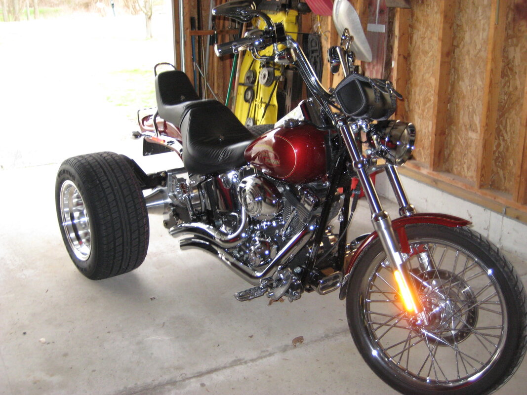

I love my softail custom and I love to ride But after a few injuries and then treatment for cancer my balance is gone. I tried riding a Harley made trike for me it was just not right nothing about it was right for me, it was not my softail. So I went Frankenstein trike kit. And all I can say is WOW it's feels the same but different my bike still looks close to the same. It really fun to ride my buddie that said they would never do that to their bikes can't ride mine often enough.
I think people that have written about how trikes ride have never ridden one, so far almost nothing I have read has been right. Last summer I put 6600 miles on my trike and didn't go anywhere. My bike is still light and fastit might weight 80-100 pounds more than it did as a 2 wheeled bike did I mension how much fun it is to ride. And yes a curvie hilly road are still the best. If there is a down side it everywhere you stop it gather a crowd with question because you just don't see many or not around here you don't. My local Harley dealer wants me to park around back of his shop because he is tired of having to tell his customers that they don't sell the Frankenstein kits(they should start)
This is a last year picture, my monster is still in winter storage I did get some new stuff for it over the winter a windsheild,cup holder and a nicer leather sissy bar bag.
I love my softail custom and I love to ride But after a few injuries and then treatment for cancer my balance is gone. I tried riding a Harley made trike for me it was just not right nothing about it was right for me, it was not my softail. So I went Frankenstein trike kit. And all I can say is WOW it's feels the same but different my bike still looks close to the same. It really fun to ride my buddie that said they would never do that to their bikes can't ride mine often enough. I think people that have written about how trikes ride have never ridden one, so far almost nothing I have read has been right. Last summer I put 6600 miles on my trike and didn't go anywhere. My bike is still light and fastit might weight 80-100 pounds more than it did as a 2 wheeled bike did I mension how much fun it is to ride. And yes a curvie hilly road are still the best. If there is a down side it everywhere you stop it gather a crowd with question because you just don't see many or not around here you don't. My local Harley dealer wants me to park around back of his shop because he is tired of having to tell his customers that they don't sell the Frankenstein kits(they should start)
Don’t you love it when a plan comes together? Best wishes for many more miles of smiles!
