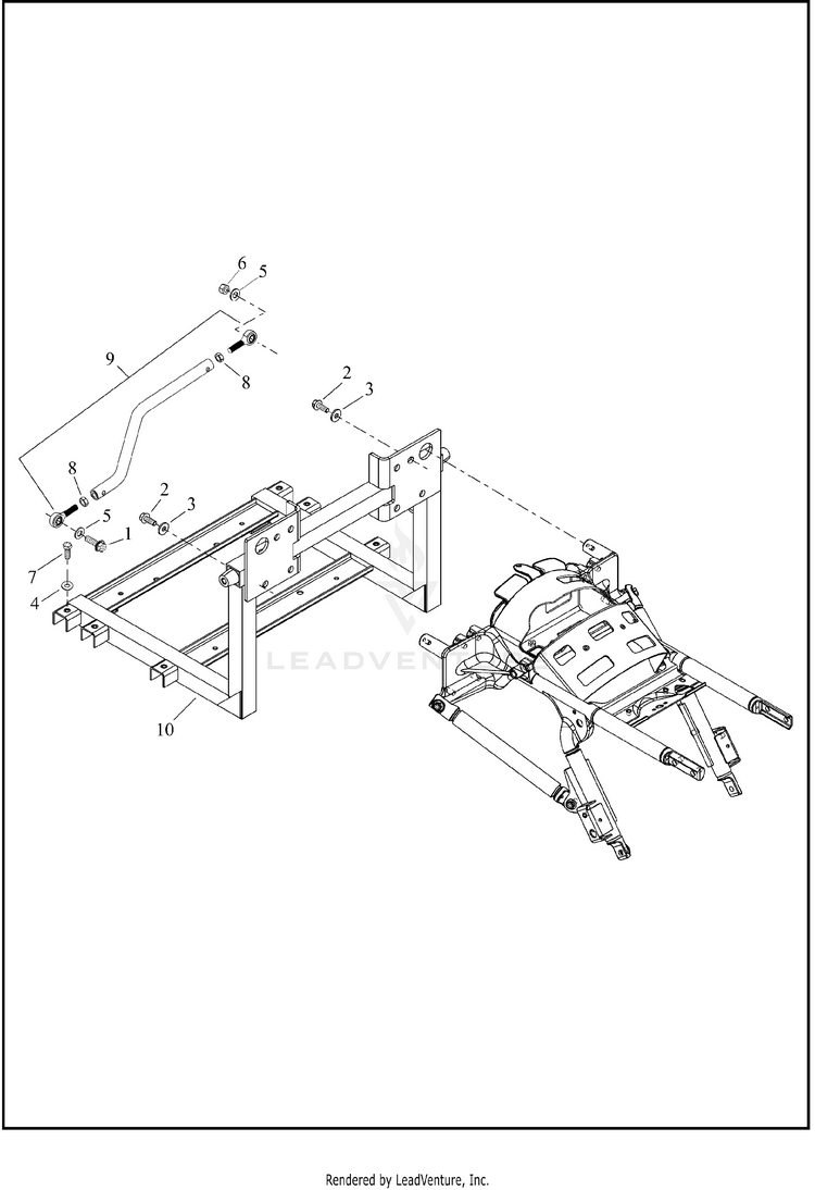

At the risk of sounding stupid, which really isn't a risk on my part I'm actually pretty good at it, what's a panhard rod?
JT, look at this diagram #9 is the panhard rod
It helps keep the rear frame section parallel and keep from tweeking and flexing
As the rod end joints wear they get sloppy and noisy
Jeeps have used them on their front ends to keep the front ends from flexing, so the wheels would track straight, we called them track rods back then
