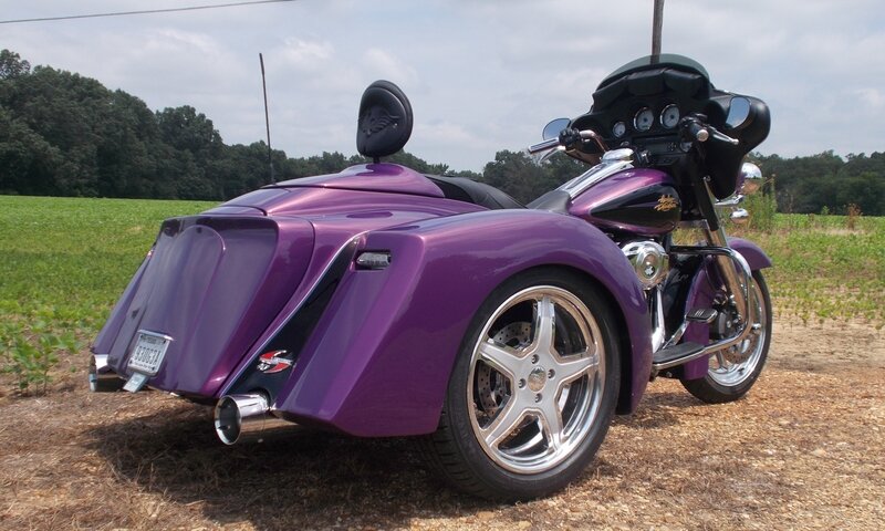

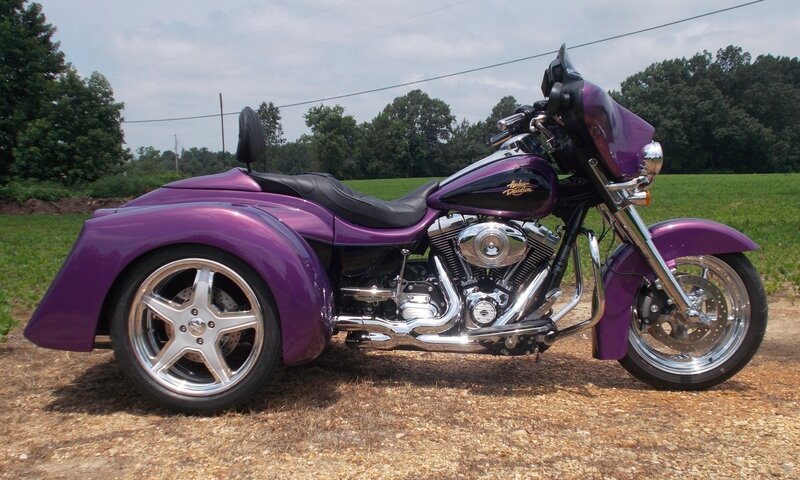

Finally got to take a short ride on our new trike and I am very impressed with the ride quality. The road leading into our housing subdivision is very rough and the trike's independent suspension just ignored it. Ride quality is noticeably better than our bike and even better than our former Boss Hoss trike w/Arnott air ride. Gearing with the 68T rear pulley is spot-on. I was concerned I might have to install a 30T front pulley but I don't think it's now going to be necessary.
Hannigan's build quality and paintwork is amazing! You just have to see it to know what I'm talking about. Anyone who has seen any of my custom build projects know how picky I am and our Street Glide trike definitely passes the test. Hannigan's crew really did an incredible job on this thing and Sherry & I are very proud owners. We can't wait to put some serious road miles on it.
More thoughts to follow.
Hopefully,these aren't too large. Sherry and I just got back from a nice ride and she gave the ride quality an A+. We are both amazed at how well this thing swallows big bumps and how stable it feels. I've been riding bikes and trikes for a very long time and I can say that I've never ridden anything with the ride quality this thing has.
