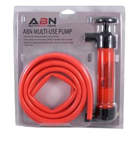

Suction pump with flexible hose on it
I understand the siphon part, but what is a suction pump and where do I find one? I have an emergency kersosene heater that has a device that pumps kerosene but it would be way too big I think to maneuver/use in the limited space under the trike.
Thanks everyone for the inputs. I had never heard or seen of those little pumps before. I'll stop in at one of my local auto parts stores and pick one up.
