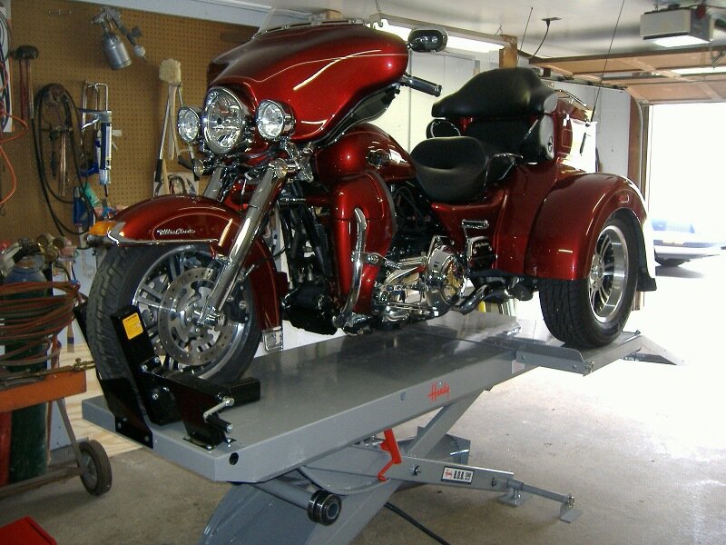

I have a Handy 1,000 lb. motorcycle lift that is as new that I have enjoyed for a few years working on my two wheelers, but the new triglide is too wide in the rear to fit and I have the side extensions. Does anyone make a kit to make the rear of the lift wider for a trike? I know the trike weights more that 1,000 lbs., but I think it would lift the trike safely.
Thanks Mick (trikenewby)

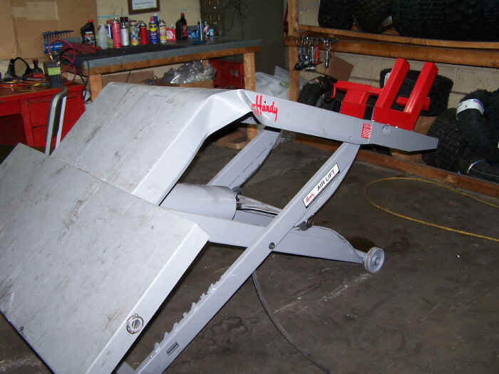

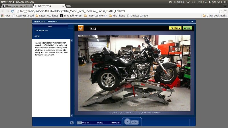

If you need a table lift, get one rated for the weight of a Triglide. A 1,000 lb lift is not going to cut it, unless you want to roll the dice and maybe have this happen.
Harley even cautions their dealer about this in the 2014 MY tech
Harley even cautions their dealer about this in the 2014 MY tech document.

I have a Handy BOB 1500. Works great for the trike. Yea, it'a a little spendy, but what is your life (and trike) and limbs worth.
as they say pay me now or pay me later. later is usually more than now

I've never gave much thought about the 1st time I used a lift, I trusted my decision that I got the right tool for the job. When my dad and I both had only 2 wheels, we had a 1,000 lb rated direct lift. Once the trikes come along it was sold and the Handy BOB 1,500 was purchased to replace it. It has been money well spent when you consider some of the work I've done off of it.
