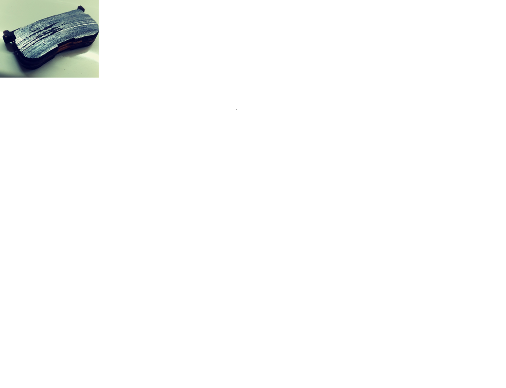

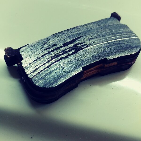

I decided to not replace the rotor since the scoring was only on one side and was really pretty minor. After removing the old pad I took a long, hard look at it since I would like to make sure I address the root cause if I can. I am wondering if the center part of the pad material actually failed and that is what caused the scoring on the rotor. Everything else with the seems to be okay. Doesn't change my decision, it's just interesting.

I would say so.........That gos under the category of , Stuff Happens...:Shrug:
It is possible
OR you may have picked up a rock or sand between the pad and rotor
There is NO running clearance between the pads and rotors
Anything that gets thrown up on the rotor could get swept in between. It usually is followed by scraping noises
I am guessing you checked the pads with a magnet
I hate semi metallic pads they are pretty hard on rotors tho they do stop good
