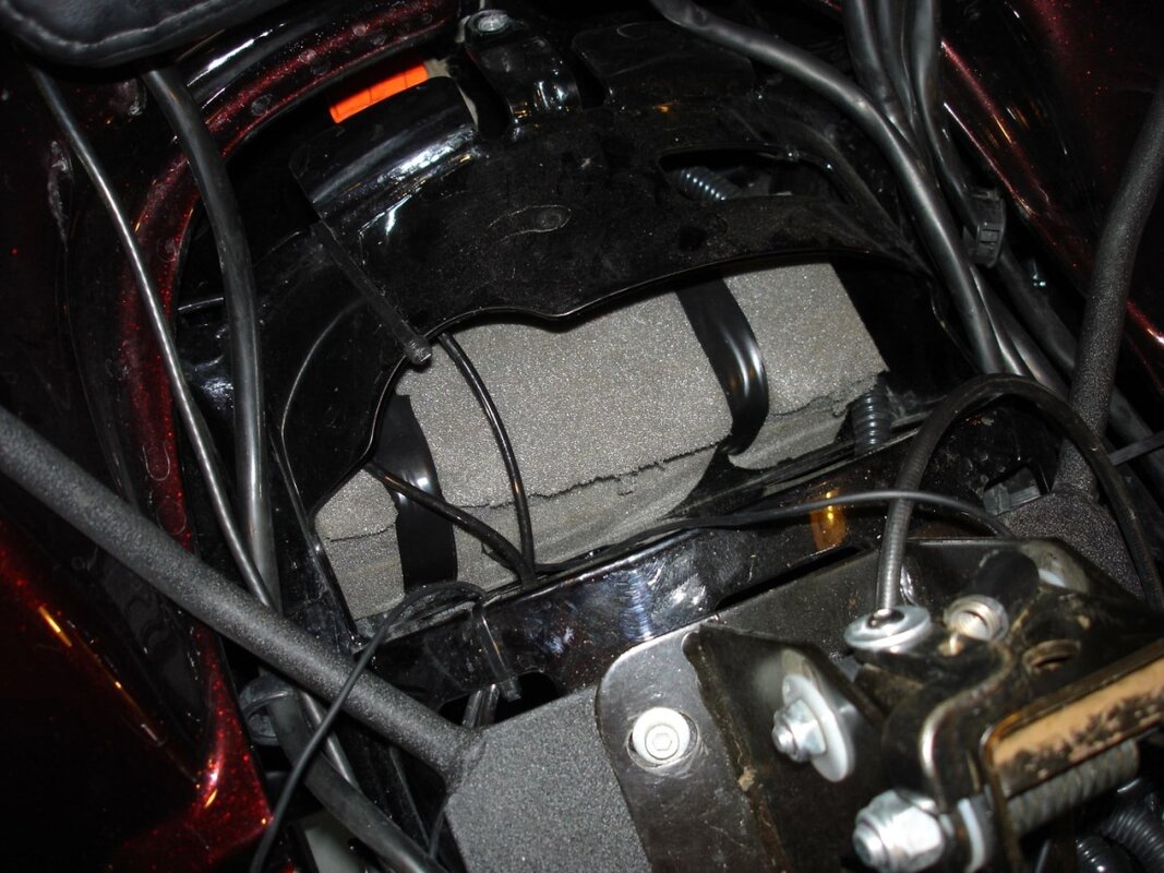

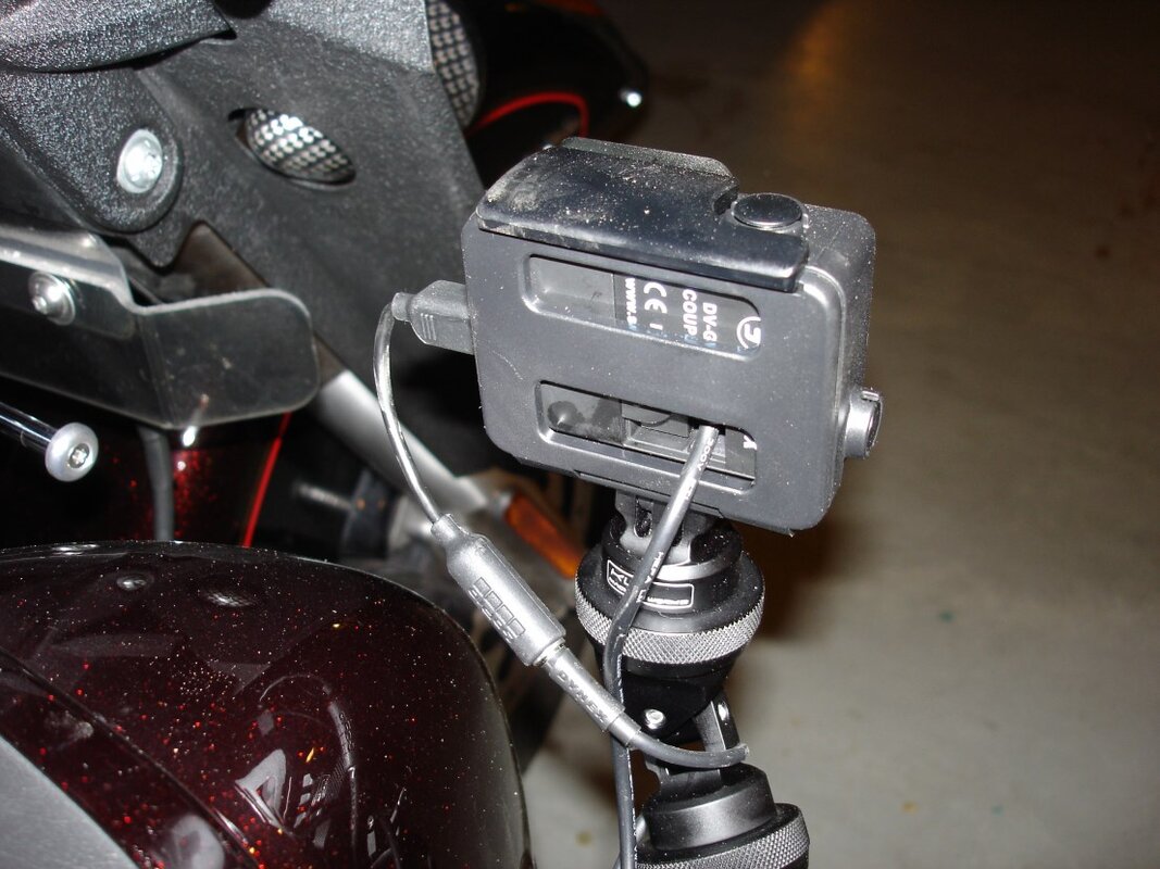

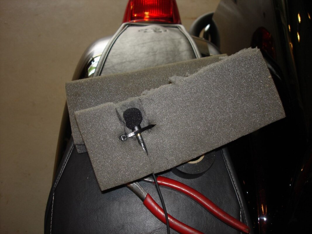

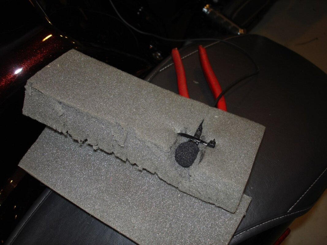

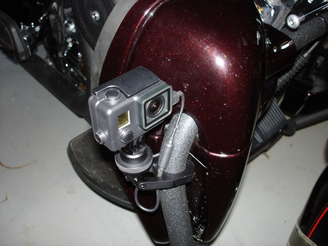

Playing with an added microphone. Cut hole in side of camera case for plug in and routed wire back to under seat. Wrapped microphone in some dense foam I had and put into open frame area out of the way.
A test in garage, then a short ride test. All I care to hear on the video is exhaust sound.
I am happy with placement of camera and microphone.

Great work Dennis, looks likes and sounds like a good place for the mic. What are you going to use to seal the plug were it goes through camera case?

I am not going to worry about it to be honest. I am not going to be "under" water, or at least it is not in my plans. I have the skeleton back on it also, little thing gets warm all enclosed.
If I end up with it on in rain, I figure a little tape at plug end area to protect it a bit. At least that is my plan.
A little more adjusting on mount and I will go with it. Wish I lived in an area with real roads, as you can see in videos, not many areas without pot holes. I am pleasantly surprised how stable these are coming out given the road conditions and being mounted on a Harley.

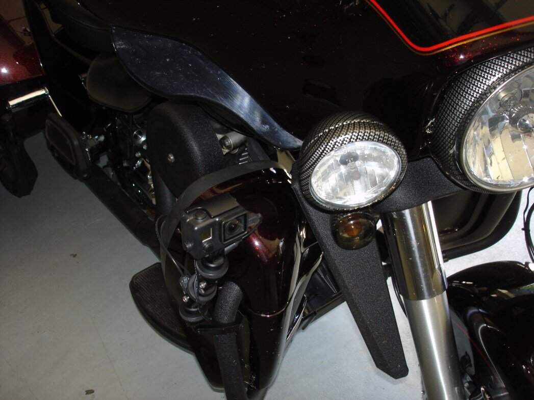

Thanks Jim. I am ready to try having it hooked to battery power off trike. These batteries in cameras do not last long. Also going to try a little higher on engine guard. An inch or so.

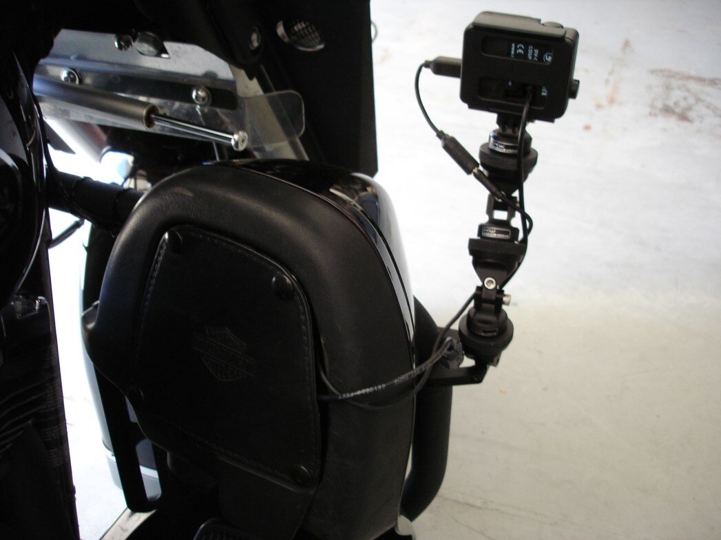

Dennis, I run mine off a USB cable hooked to a lighter adapter plug. Constant power, no issues.
i utilize a 'skeleton' extended battery back. Am working up enough nerve to cut open another waterproof case for audio/power access. Am going to cut the audio port in the case and the power port in the lid. Trying to eliminate as much moisture access as possible.

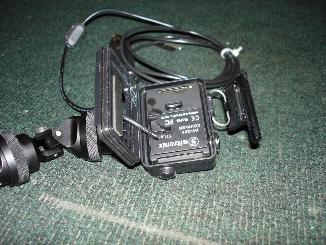

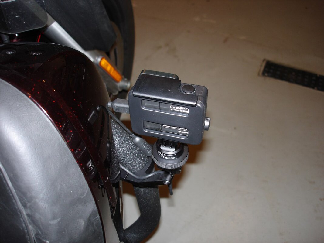

I just got a thing that replaces the battery, clips right in like the battery cover and cord runs thru skeleton case back to power plug. (no battery in camera)

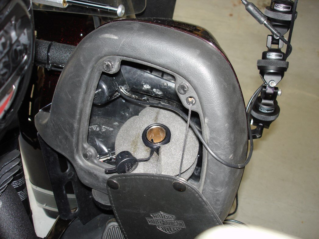

I put a power plug in lower faring to power it. Have not had a chance to try it out yet. Not real water proof, but hey, what can you do.

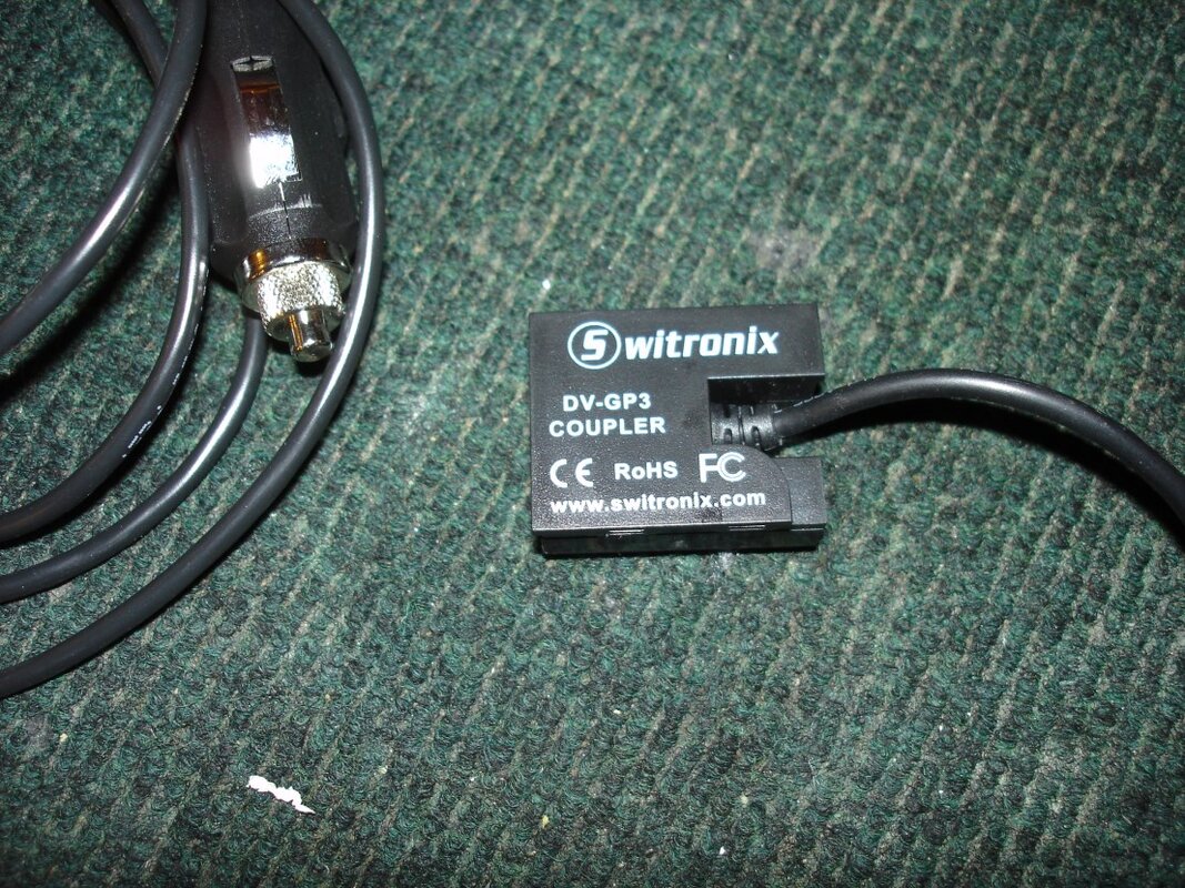

Can not remember where I ordered it. Product web page is in picture. This is not a battery charging system, it replaces battery.
I have mic going into side. Just the mic extension. The combo cord for mic and power that goes into side seemed too bulky.
I have not had this out on road yet so test is still needed.

Thanks for the lead on the battery info. Found it at http://www.switronix.com.

Are you using the power socket on the left hand side of the fairing? If so,
do you have any problem with clearance when turning? Re: the plug sticks out too far?

Not with the mount I am using. I have two swivel mounts on it now but even with just the mount. plug would fit into camera, but close to lower. No turning interference.
The power outlet I added is just loose inside lower and I run cord into it through the snap cover.
I think I am understanding your question.
