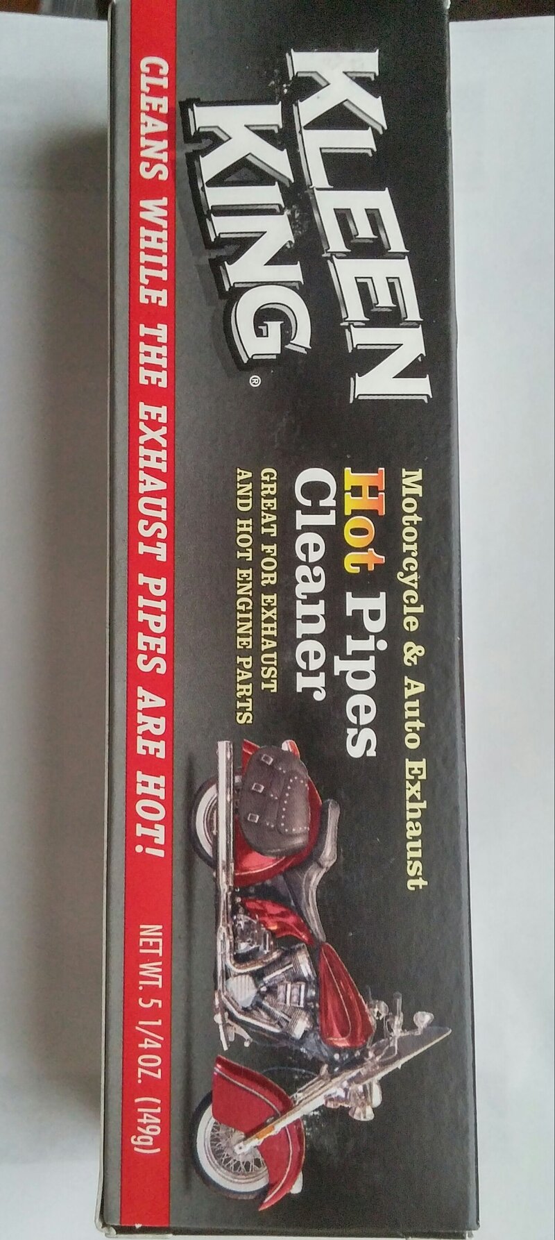

Good morning! I had many a time this problem...found a product that did wonders for removing without being abrasive. Kleen King Check it out, ordered a tube and it goes a ling way. Good stuff! 20160829_083504_HDR-1.jpg
