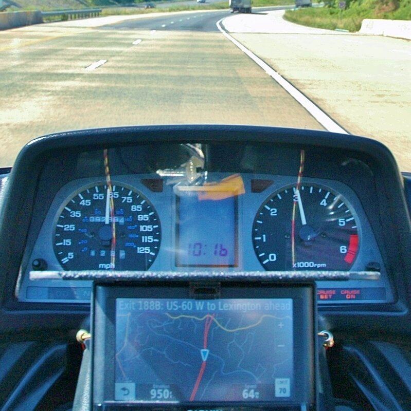

Honda GL1500 rear is 2.83 as I recall, but the 160/80-16 rear tire is a bit shorter than anything you are likely to want on a trike.
Taller tires like 215/70-15 or 245/60-15 ..... use 3.08:1 rear.
Shorter tires like 215/60-15 use a 2.93 .... etc.
If all you want is slow mountain riding, go 3.55, 3.73, 4.11 .... (I always wondered what she'd be like with 4.11s .... :D :laugh: :D)
Below pic is on a 1997 GL1500 / Lehman trike with 3.08 Ford rear axle (Ford 6.75" ring gear from like a Pinto) using 215/70-15 tires at GPS 64 mph.
