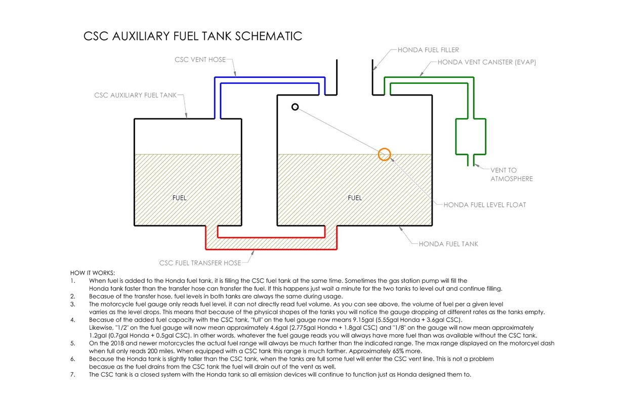

Todd, thank you for the photo it helped me to understand how the system works. This will enable me to make better use of the auxiliary tank and my fuel system in general. Just one thing, could you please show where the Honda takes fuel out of the tank and sends it to the engine? Curious minds want to know!

I'm not Todd ,but i can tell you for sure the fuel is taken from the top of the Honda tank ,the pump is directly under your butt
Yes nywinger you are correct.
The Honda fuel pump sits on the bottom of the honda fuel tank and then pumps the fuel out the top through a fitting at the top of the tank. The vent, pump power wires, sender wires, fuel line out, and fuel line in, all go out through various flanges depending on the year of the motorcycle. These can mostly be seen when you remove the seat.
