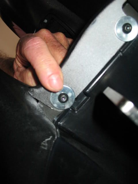

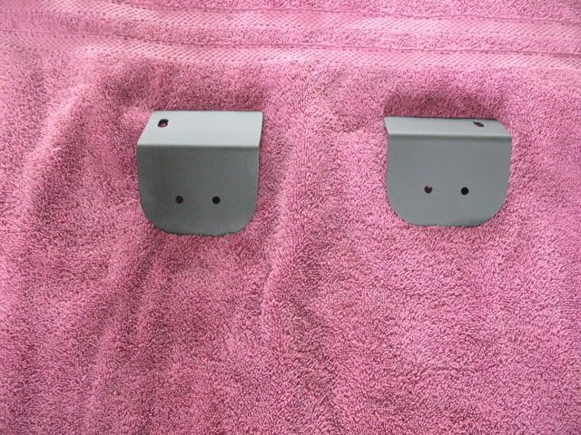

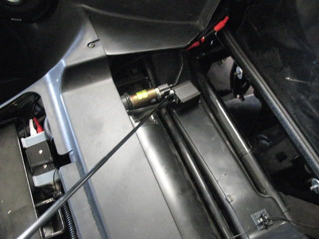

Here are some pictures of my front speaker install. My first step was to fashion some mount brackets for the speakers. I used some 16 ga metal I had on hand for this. I first primed the brackets with self etching primer, then put on a top coat of flat black to match the speakers. I was able to use an existing bolt to secure the mount. I did have to drill one hole in the left tunnel to route the wire. On the right side, there is already an existing hole which I used. Running the wires from the front to the seat area was the biggest challenge of the entire project. I raised it as high as my capability to gain access underneath.
Next I went to the radio unit in the trunk and removed the radio. I went into the menu to set up the audio for the front speaker. I have the fader centered, the bass maxed out and the treble @+5. Then there was the task of running wires to the RCA line level outputs on the back of the radio. The plugs are too large to push through the tubing in the trunk wall, so I was able to pull the tubing completely out from the wheel well, then push the plug the hole and push the wire down through the slit in the connector. I then routed the wire under the seat where I planned to mount the amp.

Here are my speaker brackets. You will notice that they are not
symmetric, reason being I had to deal with the asymmetric mounting surfaces in the Stallion.
Here is the existing mount bolt above the tunnel I used to secure the brackets.

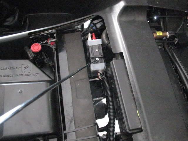

This the amp mounted under the seat

The front speakers are connected to the amp. The amp is connected to the front RCA line level outputs on the radio in the trunk. I can control the volume to all four speakers with the volume control on the radio. The RCA line level output is controlled with the normal radio volume control. The amp came with the speakers so I went ahead and installed it. The rear speakers give the bass emphasis. I really don't feel like I need to amp those at this point.

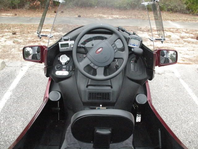

My wind deflectors came from Baker Built Co's: Air Wings; Products; Engraving. They are mounted on the windshield. This picture should clear everything up.

Fortsand, in your post on 2-28-09 you posted some pictures. The third picture shows the amp under the seat. When I showed your picture to my audio dealer, he said there isn't an amp small enough to fit in that space. Please provide the make and model of amp you used if at all possible. I'd like to pass this information on to my audio dealer as I intend to add some front speakers and think the amp would help drive them better. Thanks.

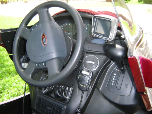

This may work for you. The sound is great, just glide down the road with my Sirius, and Miles the wonder dog.
Killer setup Big Dog! I like how you have it working now! How is the hand held CB working? Next time we ride we will try it out. Drive safe and toss the wonder dog a biscuit!
Big Dog, thanks. I had seen your other post of these speaker pic's and your amp placement when you posted about changing out the rear speakers a while back. I believe I will go with your front speaker setup but I like Fortsand's amp placement better under the seat (if I can find one to fit) so I don't loose the trunk space but otherwise your amp setup is the next option.
